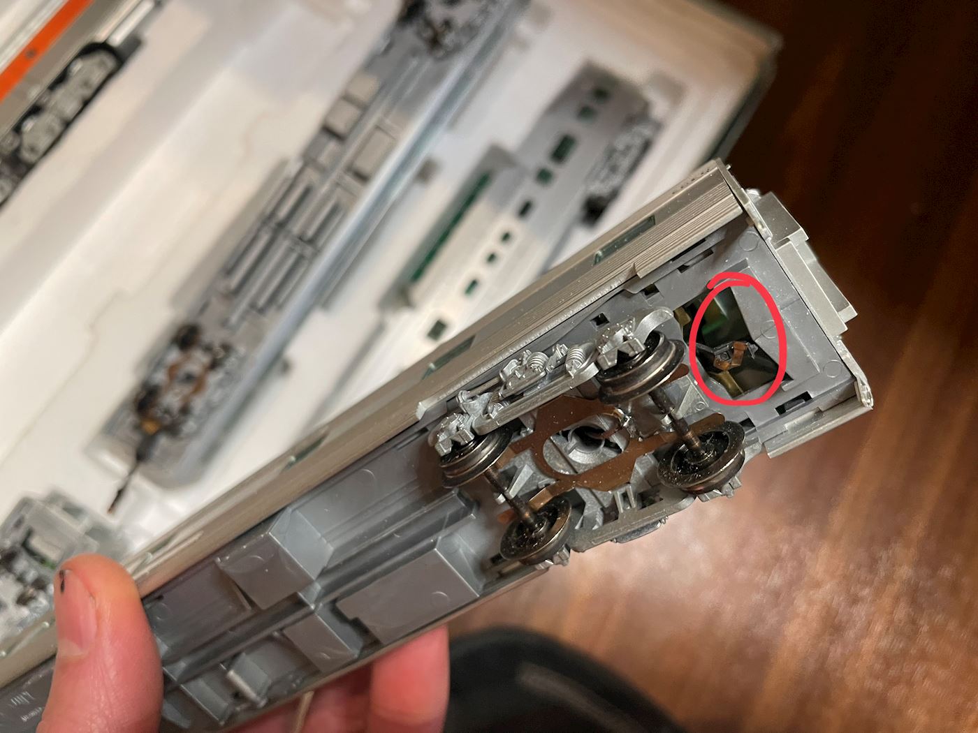

Just got my hands on a used 26600 set, unfortunately its got some broken passenger car connecting rods, and worse on some cars the connector housing itself is broken or missing.
And there is no user manual which would have the parts list possibly.
Does anyone have this and could share images of the part list?
Does anyone know it the connector housings and rods are custom for this model, or some standard Märklin parts used at the time.
Best
KS

Spare parts you are asking for:
Märklin E579120 - Coupler Pockets for Streamliner cars California Zephyr (CZ), Amtrak, AT&SF ...
Märklin E580730 - Coupler current conducting tab
Märklin E239550 - Current conducting tow bar
To make it easier to put the CZ on rails, I am employing these instead of the tow bars:
Märklin E115737 - Current conducting coupler
#3 Posted : 06 June 2023 05:02:34(UTC)
Views messages in topic : 8,255
I believe that once you replace the broken shafts, you can use the current conducting close couplers instead of the fixed bar between coaches.
If you decide to use Viesmann or other couplers, you would have to solder the wires to the Maerklin contact plates inside the coaches
Thanks a lot for this :) The only thing missing is the small spring that holds the pocket in place inside the car. Did the parts list have a number for this one? Best Kaspar
Hi Mike. This is an interesting thought. Would the distance be similar with the close couplers (compared to the drawbar) ?
Also do you need to actually replace the shafts to use the couplers? I only need to replace half of them so the remaining pockets would still be original, they can not accommodate the new couplers?
Best Kaspar
#6 Posted : 06 June 2023 15:17:25(UTC)
Posts: 5,902
There is no such thing as a parts list. The sources are "experience" and "investigation".
These should do the trick, but I cannot guarantee that they equal the "originals":
Märklin E321965 drawbar springs
#7 Posted : 06 June 2023 15:21:28(UTC)
Posts: 5,902
Best Kaspar
That's what I already proposed in post #2: use couplers instead of tow bars (aka drawbars).
Wink
The distance is indeed similar. Do you mean by shafts the coupler pockets? If so, the Märklin coupler pockets can hold either Märklin couplers or Märklin tow bars (aka drawbars), no soldering needed, just plug and play.

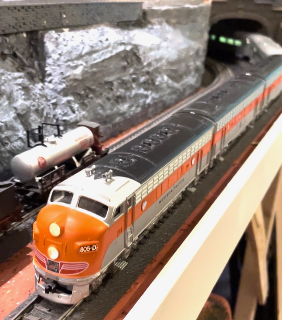

So if anyone is still following this thread, I did get the spare parts recommended and can report that the Zephyr is up and running BigGrin
Zephyr
I did switch to close couplers and they look just as good and are of course easier to uncouple when needed. If anything I found the 321965 springs a bit fiddly to install. The few original springs were a larger type. But with some patience it did work.
As for the manual I was able to get scan from forum user Various Scales, I've attached a PDF version here for anyone else looking for this manual.
Marklin 26600 California Zephyr manual.pdf (1,237kb) downloaded 138 time(s).
