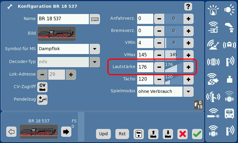

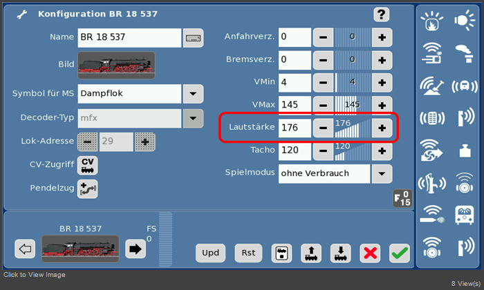

Regarding lights, Märklin sets them to maximum luminosity so what is left for you is to check the LED is facing the light conduit (properly mounted PCB
Regarding sounds, modern MFX locos have
- a common sound laudness adjustment (located in the primary edit screen of the loco
- a fonction-specific sound laudness adjustment (usually set to reduced level)
How to adjust the fonction-specific sound laudness
- place the loco on the programming track (not obliged but better)
- select the loco on your CS2
- select the wrench to edit parameters on the loco
You have the general editing of loco parameters. Circled RED is the overall sound adjustment

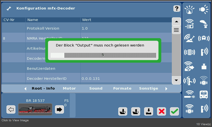

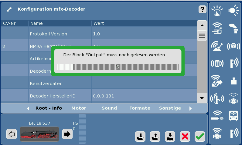

- select edit CVs
- push any fonction key of the loco Then more parameters are uploaded to the CS2
