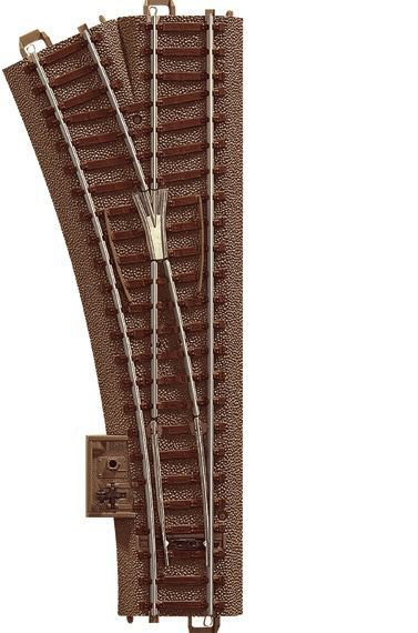

I got from a friend used Marklin HO scale AC tracks and turnouts and a DC locomotive.
The target is to use them for a layout, powered by DC.
The tracks are easy to modify for the DC usage. yet I am not sure about the turnouts.
Would it be possible to use them with DC power?

I have managed to successfully convert C track to DC running as I wished to use the Marklin curved ramps and bridges for an above ground Subway/Metro project and only Marklin C track fits. For another venture I bought a Marklin turnout to see if it could be converted to DC. So far it awaits the necessary surgery as I figure things out. I might be wrong but I believe that it is possible. It has a live frog which I believe means it will short when switched. So it will need some work to insulate/isolate the straight downline spur... Its the unique way the Marklin C track works to connect one piece to another that will need to be figured out and reconfigured. Getting the C track to work on DC presents its own unique headaches - it can short through the central contact strip so it is more reliable when that is isolated - a swift piece or surgery using a Dremel cutter does the trick. My Ree USA tank is happily whizzing around the oval as I write... I'll post again if and when successful.

#6 Posted : 09 June 2023 14:47:28(UTC)
Posts: 3,727
Hi Yigal and you all
Welcome to this great forum.
Yes converting C track to 2 rails is easy. Where it gets difficult is to convert short radius (R2) turnouts to DC
Here is a German video on how to insulate rails on short radius switches
Notice that the frog is insulated during the conversion
I have not done it but it seems feasible.
In case you have difficulties with German:
Turnout (24611 - 24612
- all ground bridges (Three of them) are cut "Masseverbindungen" Video 1:46 into it
- all rails on the same side are wired (LHR and RHR) 3:58 into the video
- the frog is pushed down 4:26 into the video
- the "A"-shaped contact sheet metal is removed 5:00 into the video
- the frog is filed so to be insulated 5:56 into the video and so that it does not contact the small rails after the frog.
- check continuity and insulation 8:03 into the video
Double Slip Switch (24624)
- cut the four bridges
- connect all LHR together and all RHR together
- that seems to be it.

One thing I suspect but I am not sure of is: are the short rails and mobile blades powered? I think they are even after removing the A-shaped sheet-metal part.
Improvements could be by fitting the luke: powering the frog by inserting a wire on the hole before clipsing the frog to its ballast.
Your approach is very interesting.

The mobile blades are powered - there are connections to the live rails where the A shaped insert joined the mobile blades ( I cut these connections - my big mistake) the fixed blades
once the A insert is removed are not connected. There should be no problem with a loco with a longer wheelbase than a tank engine. My soldering skills are not so far equal to the task of connecting the fixed blades... A lot of molten plastic and loose wires...:) But it may be possible to remove only the apex of the A insert and leave the rest in place - then the fixed blades would be powered - my guess is that that would not be satisfactory!

The problem of the dead fixed rails on the turnout was given a quick fix by placing two springy copper wire 'U's between the fixed rails and the live rails to draw power. They don't interfere with the running and are not highly visible. They make the turnout fully operational. ...

And here is the quickest solution - don't fix the turnouts - Trix apparently do identical track in DC..

The Trix turnouts have arrived (one left and one right) and I am pleased to report that they work very well with the DC adapted Maerklin track.
The colour of the plastic is a lighter more of tan shade of brown so the colours don't match but they do blend.
I now wish that I had known about the Trix/Maerklin compatibility before setting out on this current venture.
There's enough range for the Trix/Maerklin track that make it suitable for many different uses.
It's a quality engineered product and useful for the rapid prototyping of proposed layouts
whilst making good use of many of the Maerklin accessories, like bridges and ramps and so forth..
