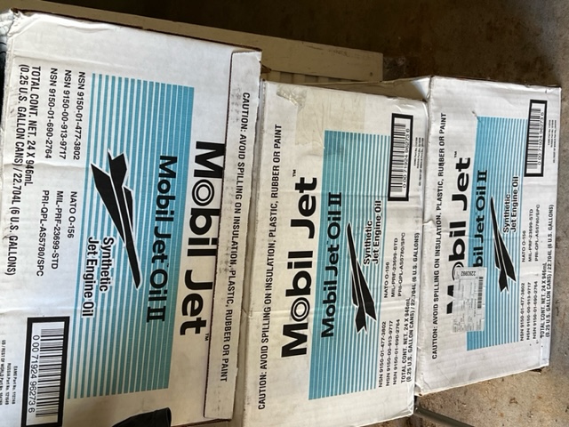

Any light machine oil will work such as sewing machine oil, gun oil, (precision tool oil (Starett)), (turbine oil (see appliance repair shop)).
How much would you like?BigGrin
Seriously however, I would not use Jet engine turbine oil in my trains. Although it is thin, it attacks certain rubbers and plastics as well as stains. O rings and other "rubber" components in jet engines are a special material.
Karl
thanks 2 users liked this useful post by Kanga
