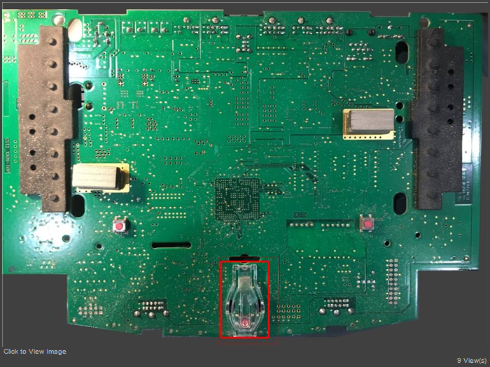

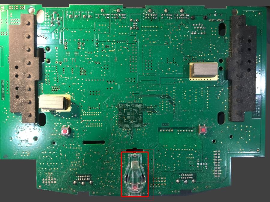

If we are sure, it is the stop bar that is not working (can it be activated by a plugged-in MS1 or MS2?) and all the rest is fine, then is is a matter of changing the SMC switch on the mother board.
Here is the backside of a 60215 mother board on one of my CS2s (the side adjacent to the screen and keys)
Once the transparent pusher (see the red frame in picture) is moved away, the regular SMC (Surface Mounted Component) switch can be removed and changed.
For this you need:
- a set of Metric Torx screwdrivers (to open the CS2)
- a SMC Digital desoldering iron hot air soldering station such as this one https://www.ebay.de/itm/40289546...YJo%7Ctkp%3ABFBMuI6DxpFh
- the switch component to be purchased on Internet (less than 1 € usually)
Note: it is delicate work with good tools and an illuminated magnifier.
