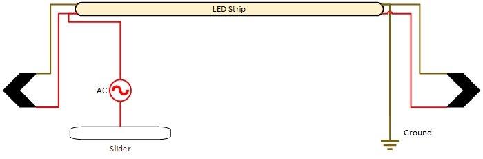

I drew a very basic wiring diagram for the powered coach, I would love any feedback, especially if completely wrong!

Looks correct. Now if you want, you don't need to connect the wire on the couple to the locomotive., unles it has a digital switched coupler socket. You may also connect both leads to the led strip at one end. if it has dual terminals like Marklin does. If you do wire the other end to a current coupler, using the locomotive for lighting, be sure a pick-up shoe is not in the train consist on a car with a current condicting coupler, or it will short out!

In your schematics, you connect directly the slider to the LED strip and IMO:
- usually, self-adhesive led strips I use are 12 VDC and are much too bright (need a dimming resistor I often use 5.6 kOhms)
- not being sure that the LEDs can withstand the reverse voltage -20 V, it is better to insert a diode to rectify
- you need both alternances to avoid flickering so a bridge rectifier (full wave rectifier) is needed
It goes something like this

I will keep this in mind if I use regular LED strips. I’m hoping that the Roco ones won’t need the extra components.
According to the description, Roco set 40420 is compatible with AC and DC, it can also accomodate a decoder which can adjust brightness. It also has the buffer capacitor to avoid flickering, this was really attractive to me.
Thank you!
I coupler between the coach and train will not be powered. The plan is to have the last coach as the powered one, sharing to the others.
I noticed that the Marklin LED strips have dual terminals, the Roco ones don’t. I was just going to solder 2 wires together, on one terminal - this should have the same effect right?
