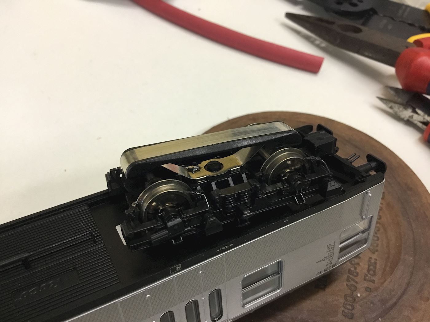

Please see attached pictures of a 1:37438E72-93BA-47EB-AE8E-99936BB28831.jpeg5BF51C0F-24CA-41C2-9E9A-FA98582357D8.jpeg90BB4FDB-34FD-49A2-A2E5-24C80AB4541C.jpeg87 silberlinge of relatively moder production
Hopefully you can see the screw, and the other shot of the bogie shoes how they are from the factory. The slider locates on the pins and the screw just has to be started in the plastic. Carefully of course!

This is super useful, thank you so much. I can see that it wouldn’t take much to break the thread when fitting the screw!
