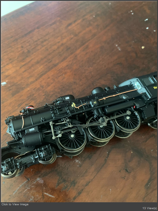

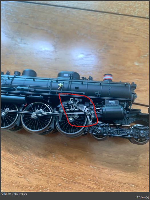

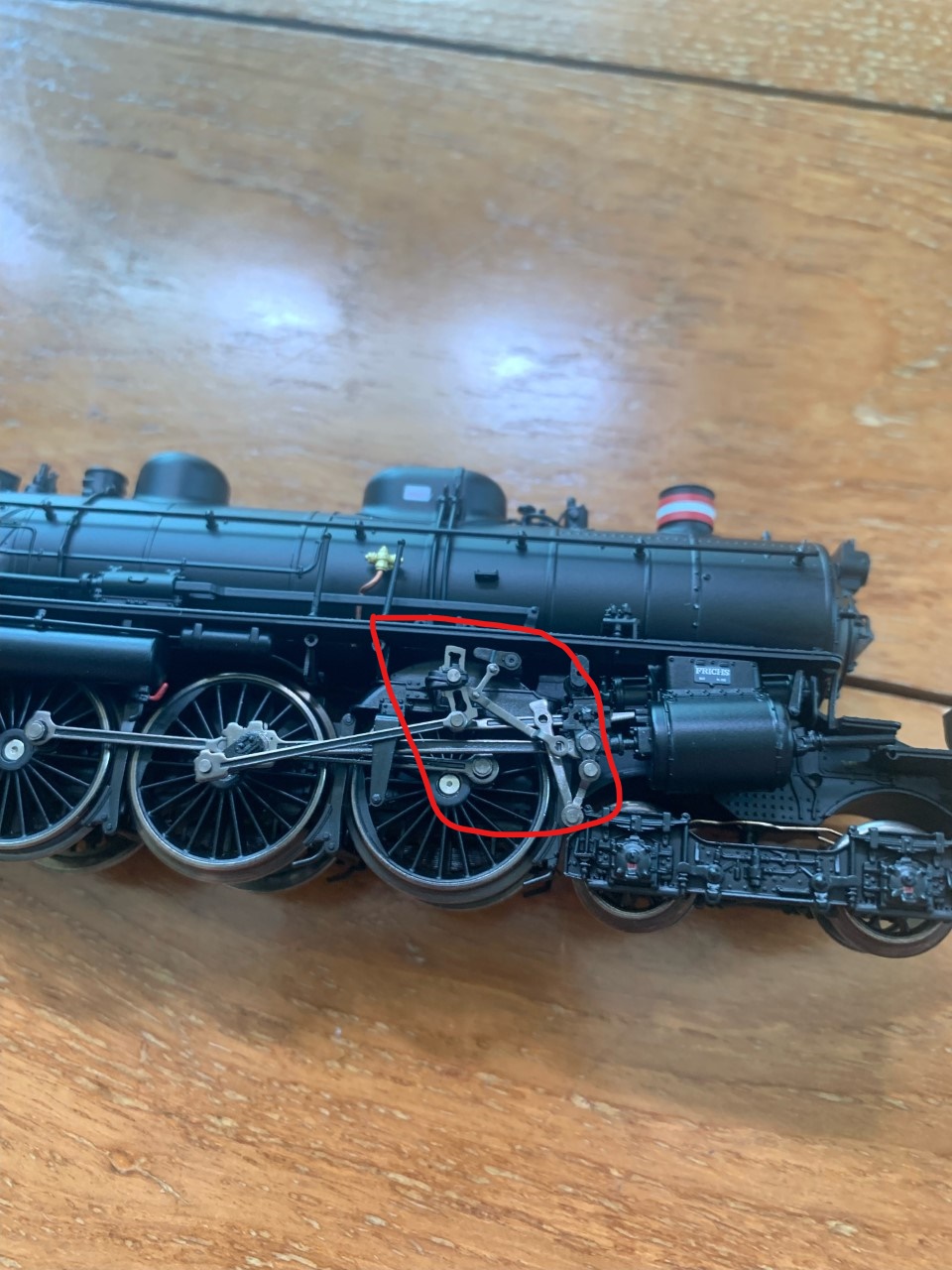

Hi all, I am new to this hobby and I recently bought my first H0 Scale Marklin train : the 39491 E991 Litra via ebay. It was not cheap. however when I received the my package, the box is in a bad shape and I noticed that at the left side of the train there is this dislodged Part. The circled area highlights the dislodged part while the other pic show the other side that is ok. Appreciate advice on how best to fix this. Thank you so much

As far as I can see on my E 991 the right and left sides are identical. So it should be possible to see how things are connected by comparing the two sides.

My main concern is what can i use to join this back. I think a bolt or peg is broken that cause the dislodge

From what I can see in the photo, a link pin is broken. The best way to fix this is to replace the whole connecting rod mechanism. It is part number 18 on the linked exploded diagram and will cost you 25 euro's -
https://www.maerklin.de/service/...lnummer=39491&lang=2
It appears to be in stock and my experience with the official Marklin spare parts shop has been overwhelmingly positive. You can order via the website. You will also need a Marklin toolkit (item 70900) which is also available in the shop or via ebay for about 20 euros (from memory). The toolkit just has the small hex drivers to remove the small screws holding the connecting rods onto the wheels. The repair job is fiddly but relatively straightforward - if you search my posts, you will see a description of the process. It all snaps and screws into place with no crimping or soldering required.
There would be members on this forum who would know how to obtain and install a small rivet or link pin, but this is beyond my skill - for me, it was easier to replace the whole assembly.
