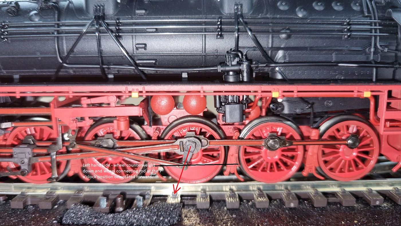

Addit - I have just had a play around with a functioning loco and I have worked it out. I can see the wheel counterbalance weights are offset on either side by 90 degrees. Therefore, when the wheel counterbalance weights are directly downwards on the right side on this particular locomotive, the wheel connecting rod is orientated at approximately the 7 o'clock position when viewed from the right (orientated forward with respect to the front of the loco). When I move the loco forward so the left hand counterweight (on the corresponding wheel) is orientated directly downwards, the wheel connecting rod is at the 7 o'clock position when viewed from the left (orientated backwards when compared to the front of the loco). This then places the connecting rods 90 degrees out of phase. It's hard to describe, so I have attached two explanatory photo's, but I think I have worked it out correctly now.loco left side.jpgloco right side.jpg

The order makes sense, thank you. All I have to do know is work out the orientation of the wheels with respect to the 90 degree phase shift. I have to get my head around that!
Hi Rob
Yes indeed driving wheels are "quartered" and they all must be quartered in the same "direction" (e.g. Left side is 90° clockwise ahead of the other side)
This is quite easy to see if one of the wheels is installed in the wrong direction.
On a normal distribution gear change, you don't have this issue as the other distribution gear remains in place.
I am sure you are quite there
Good work

Following up on Jean's advice, which as usual is correct.
If the bolts on the right side are at 12:00, those on the left side are ahead and at 3:00. Or if the right side is "rods down" where the bolts are at 6:00 the left side rods would be at 9:00. It is also important that all wheels on a side align at the same position. Once you start playing with it I think it will be pretty obvious.
