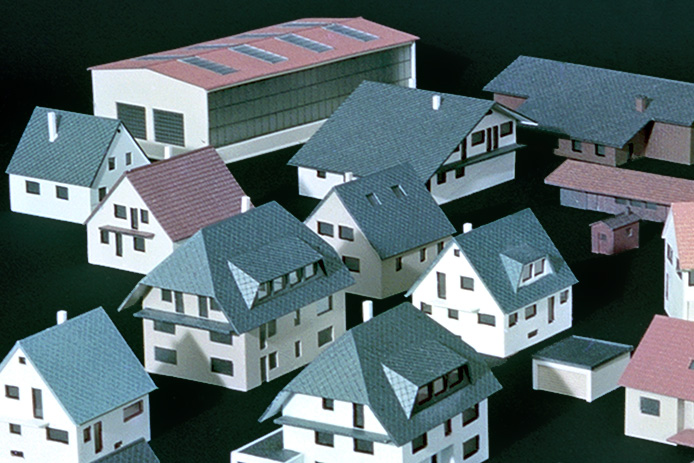

Another interesting issue.
A good way to do window frames if you are not fanatical about a raised profile, is to score the surface of 1mm thick polycarbonate sheet (not acrylic sheet). I use an Olfa P cutter 450. The blade has a V profile. I reshape it to a U profile, this allows the scored line to hold more paint. Make sure the blade is very sharp to get clean scored edges. An Arkansas translucent sharpening stone in the best. A small triangular one is more affordable!
When all the lines are scored in, use an old cotton T-shirt (100% cotton is best) to rub kids acrylic paint with colour of choice into the lines and straight away clean off excess.. Some masking tape on your finger first keeps paint off your finger.
This is a 1:200 model, glazing is also mat sprayed on the back so as not to really see inside the model.
If you do want raised frames, pre paint Evergreen styrene strips and stick on with liquid dichloroethane and a Winsor Newton series 7 size 000 brush to bleed the solvent under the styrene strips. These brushes cost 3 arms and 2 legs, but they are worth it.
If you need a line on the edge like on the glass balustrade in the photo. Thin out some acrylic kids paint and use an artist ruling pen ink drawing tool.
Tiles on the balconies I score as well but with a V profile blade. Seats are etched stainless.
I knocked up a simplified shed decades ago. The bulk of the houses I did about 3 to 4 a day but they were also simplified as well.
*if you are not fanatical*
WaoW you made all of that from scratch, in about a week? Wow, just Wow

Offline Toosmall
#6 Posted : 19 September 2022 01:28:47(UTC)
Toosmall
Joined: 26/07/2021(UTC)
Posts: 635
Location: Sydney
Thanks for the comments.
I am a retired architectural model maker. One is looking for speed but it needs to look good. At 1:200/220 you can get away exact detail as you won't see it from normal viewing distance.
To do windows. Use high impact styrene sheet, sheets are 1370 x 760mm look au$15.00, 0.75mm is good for 1:220. Score window outlines, flex sheet, scalpel blade should follow bulge on back, flex back and forth. With practice you will be able to retain fairly fine window divisions.
Then place polycarbonate behind at if installed. Run scalpel blade around edge of openings.
Score frames next to scalpel lines.
This one was more challenging, there was glazing on the corner, spandrel panels had to be back sprayed, then a slight green tint for all the glass.

Offline Toosmall
#9 Posted : 20 September 2022 01:16:54(UTC)
Toosmall
Posts: 635
Location: Sydney
The biggest problem is getting a picture in your mind in 3 dimensions of a complex building from a very large set of 2 dimensional drawings. More often than not full of mistakes. Often you don't know where to start.
Larger models are simply a lot more administration and keeping really good order of all the parts. Anything that is a different colour is a seperate part. Sometimes you can't avoid masking. I have spent days masking up a model, often trying to mask for a couple of colours and avoid doing masking multiple times.
A balcony will have separate pieces for tiles and balustrade. You can end up with thousands of parts, all painted and ready to install, a bit like a huge jigsaw. You also make a bit of spare material of the same texture and colour, one invariably has some missing parts.
