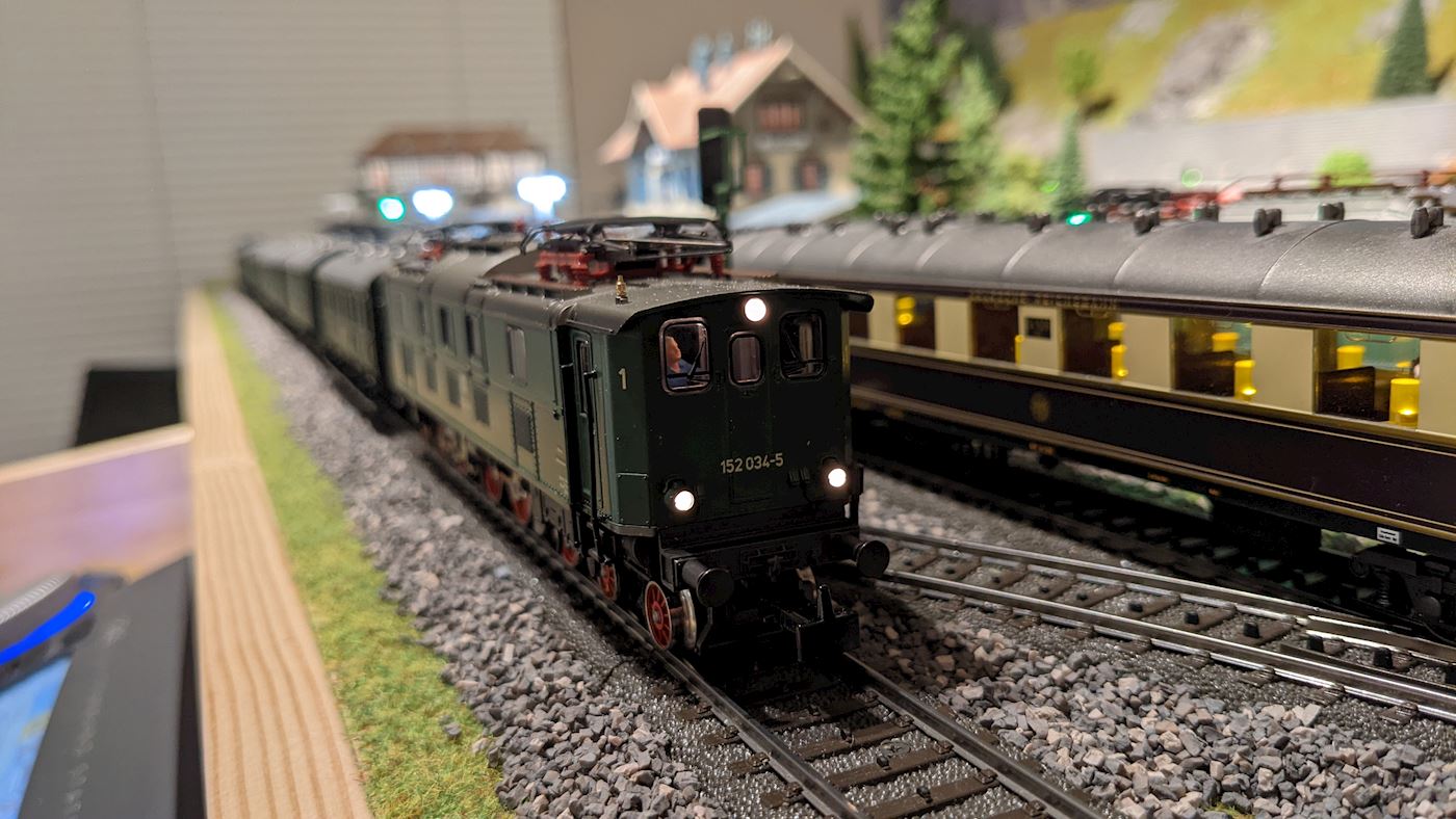

The 60906 Decoder arrived in the mail a few days ago, so I completed the conversion with this decoder.
Ignoring the good advice from other members to avoid this conversion, I pressed on because of curiosity.
I'm actually quite pleased with the result. It has the analog hum at startup, but when she's running she's pretty quiet. The deceleration delay works rather well.
The bulbs worked out perfectly.
That's me in the cab checking gauges before departure!
And I didn't mean to put BR in front of the 3366 in the title. Don't know how to change that.
