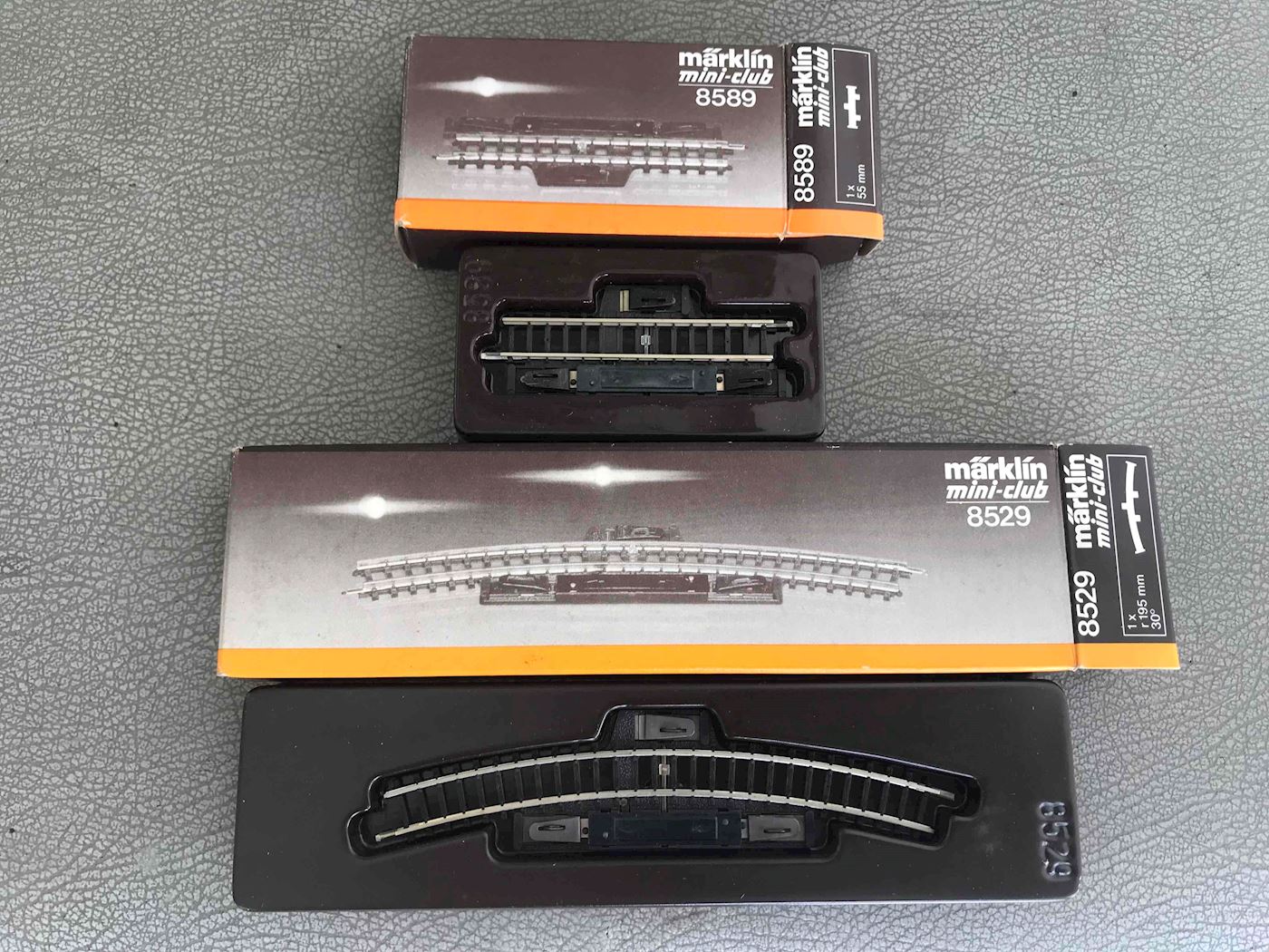

I have another question. I'm offered 8529 and 8589 at a very good price. However, my knowledge about their function is very limited. All that I know is they are working as the automatic signal/crossing feeder. I'm thinking to create an auto stop and go in my layout, and I believe these two are the ones that I need for that.
So, are they reliable? And if yes, where can I find a crash course on how to install them (preferably in videos)? I really need your advice on this one. All replies are highly appreciated!
Thanks and cheers!

Hi! I find them very reliable. I use those to automate blocks, allowing me to run up to three trains along the same mainline on a rather small layout.
The only problem I have had is some non-marklin locos that don't trigger them. Easily fixed by a small piece of tape underneath the loco to make it "lower".
Thanks, Hatoil! Well, the good thing is, I don't run non-Marklin trains 😁

The circuit tracks are really just momentary switches, triggered by the locomotive. So you also need signals (or relays) and isolated parts of the track. I remember it took some time for me to figure it out, but that was also kind of the fun part :)
thanks 1 user liked this useful post by Hatoil

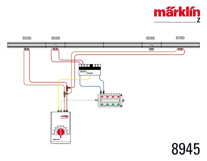

For my updated plan, I'm going to use 8945 in my setup, but then came new question. I'm planning to put eight 8588 on four lanes (is that correct?) and connect them with 8945, the question is, how many 8945 do I need for eight 8588 in those four lanes?
For an illustration, I got this from z scale hobo website,
That is just one lane, so I'm going to have four lanes like that. I'm sure I'll need more than one 8945, but will three be enough? Or I need to have more than three 8945 for that?
Thank you in advance, folks, and I really appreciate your inputs 😊🙏

I am not sure what you mean by ‘four lanes’, do you mean four separate tracks?
How many block sections for each track? For example to run two trains per separate track you would need three block sections, three trains would need four sections etc. Each section needs an 8945.
Hi Chris, sorry for my late reply. Yes, four seperate tracks, like the pic below. Please disregard the red circle, I have found the solution for that 😊
ChrisG
All I want is one loco could stop (or stay stationary) while the power is on. Therefore why I asked about the 8588 and 8945. I got some inputs in fb forum that for what I want, I can directly connect the 8588s to 72740 control box, completely bypassing the need of 8945. So, what should/can I do?

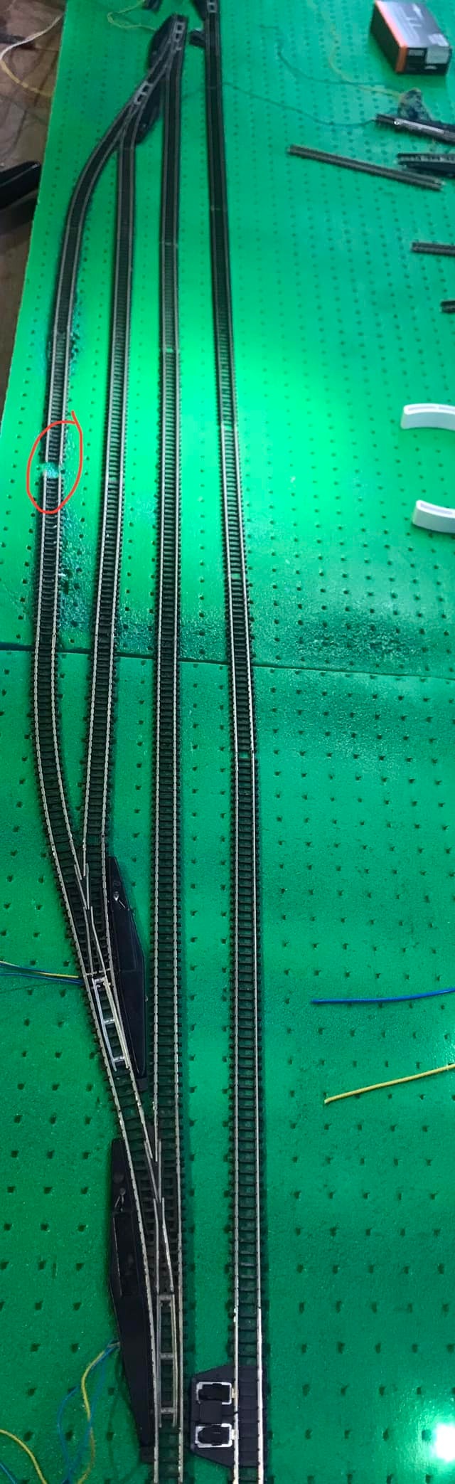

I just want a share a closure to this thread. Thank you for everyone who've shared their help to ease my confusion 😊
So, here it is! The final form of the update for my layout. I decided not to use 8529 and 8589 for this one as I found out that my length calculation is way off for an automatic operation and the best option to solve that problem was a controlled operation.

Did you use them to automate other parts of your railroad?
8529 and 8589? No, the other parts of the track has no room for automatic operation, and to use those two I think it's better for me to come up with a new layout altogether.
