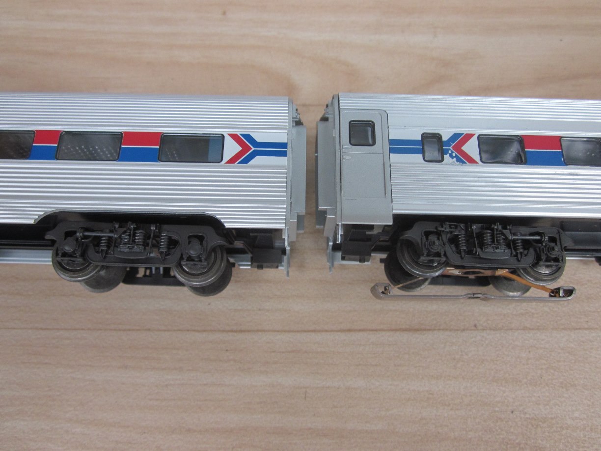

#4 Posted : 24 September 2021 11:46:03(UTC)
Photos as promised.

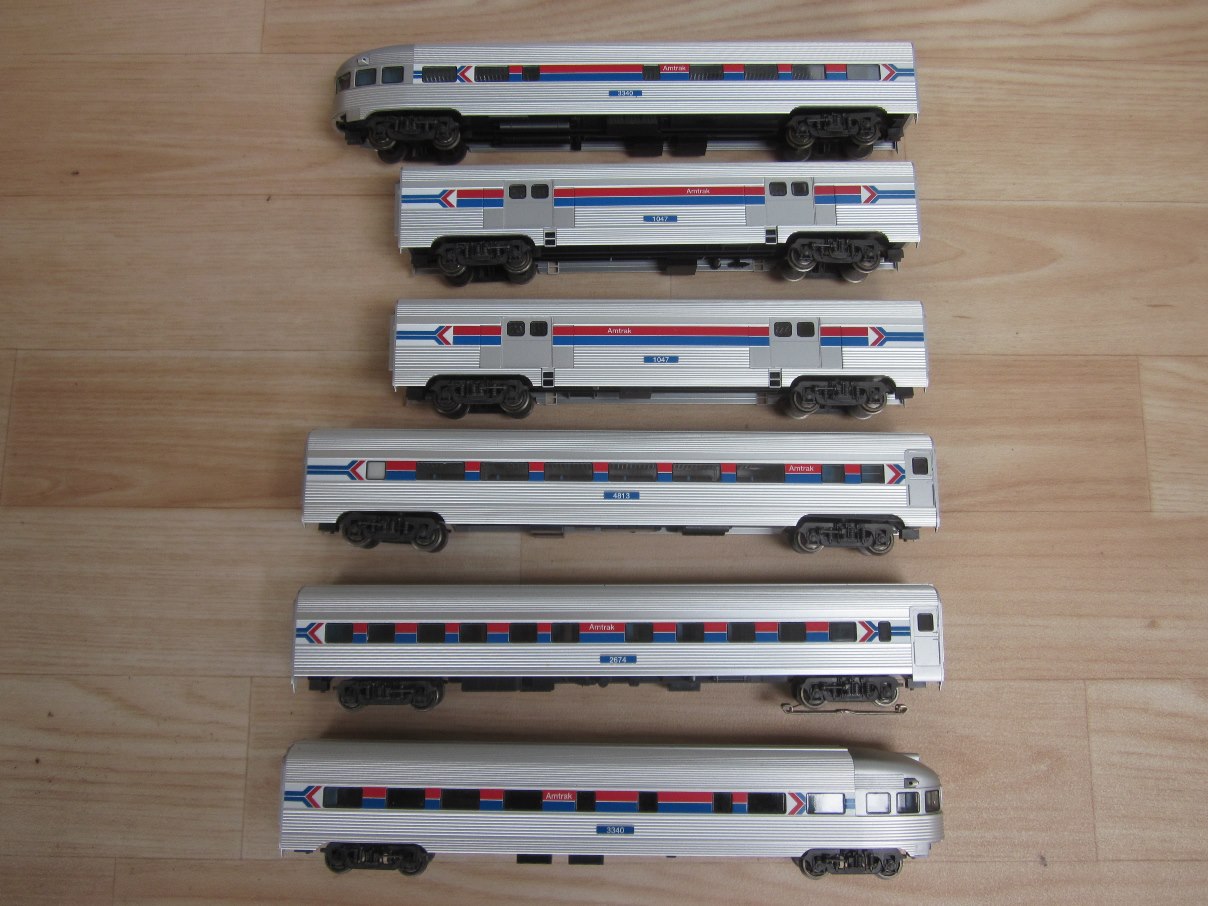

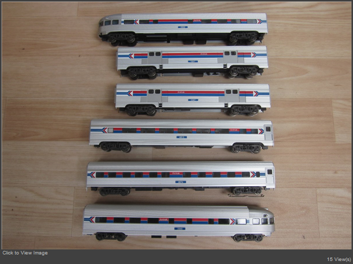

For the sake of completeness re. the images in post no. 4:
Photo 1 shows:
- observation car (running at the end of the train)
- baggage car
- baggage car
- coach
- sleeper
Thus, you are owning two "tail end cars".

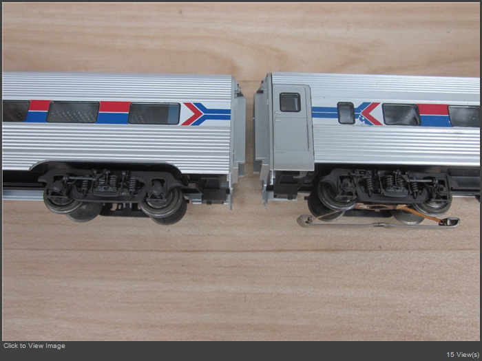

Photo 2:
The pockets in which the coupler heads (E115737) need to be inserted are clearly visible.
