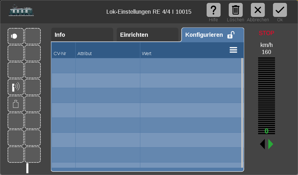

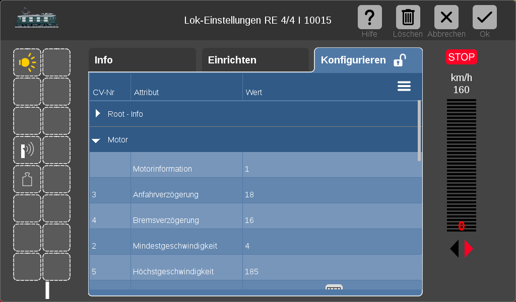

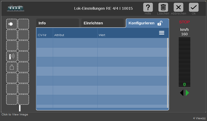

MFX is a nice system but some times temperamental.
Registration on my CS3 is fine except if there is data traffic on the Ethernet link where unplugging it can help a lot.
Registration on the program track can help if there are quite a number of locos on the main output (32 in my case)
the function find "lost MFX locos" (Verlorene Loks finden) is quite helpful but finding the new loco in a long list while not being sure of its exact name can be painful
I had a difficult case with a SBB Re 4/4 1 (SDS) where registration kept being "simplified" with a no-parameter screen no matter how many times I started the lost for lost MFX locos and erasing the loco in the CS3
The solution came when I registered the same loco on my CS2 and then registering it again on my CS3
Here is the same loco on the same CS3 fully registering now
It seems to me that some decoders have a weak power response signal for MFX registration
