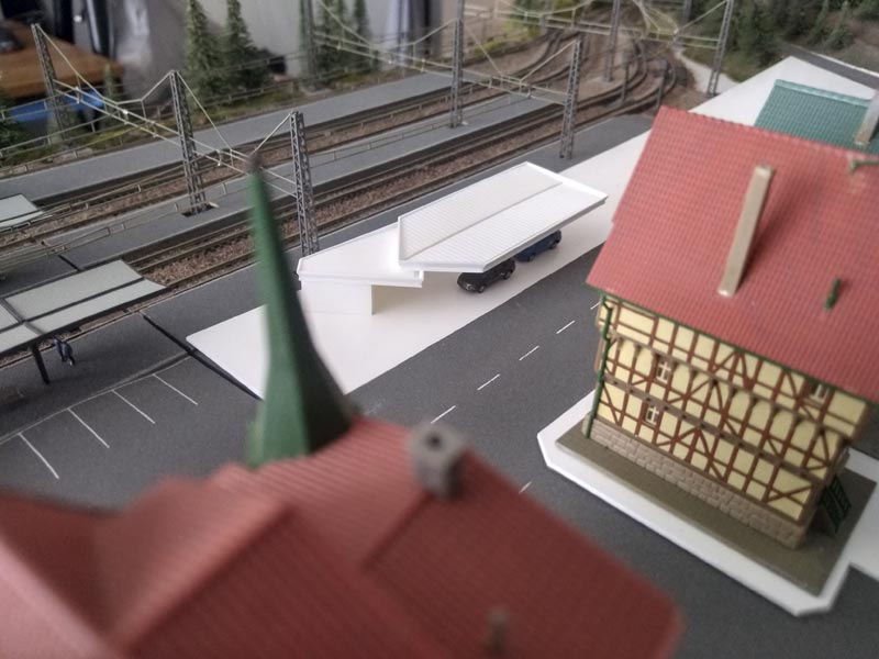

Hello, I would like to add a "City Station" to my layout, however I don't have the skills or patience to assemble one properly from a kit -- my attempts at kit-building in the past have been awful! For this reason, I prefer the assembled "built-up" models which are offered by Woodland Scenics, for example. Unfortunately, I have not found an assembled railway station (City Station) that is suitable; the Woodland Scenics people offer only "train depots" which are quite small. Does anyone know of a resource for this? For example, someone who would assemble and paint a kit professionally for a fee? If this has been asked and answered already, I apologize -- I just couldn't find any similar inquiry. Thanks for any and all help!

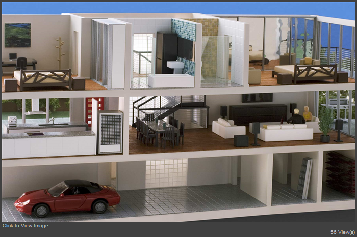

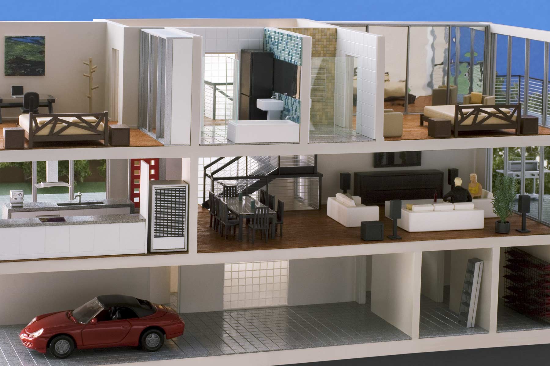

An internal 1:100 model from a decade ago. A bucket load of work. The car & people were bought. Everything else started as basic styrene except for the real timber floor & some adapted etched stainless for the wine rack and growie. I used real timber here to get a realistic looking floor, a touch over scale, but it works well.
Bathroom tiles were individually masked for spray painting, a bit tedious. Internal doors were left off.
If you want detail you have to spend the time.
