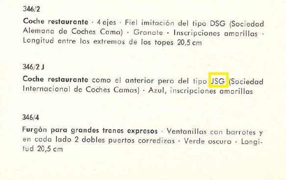

So far so good. But my real question is why the letter "J" specifically?

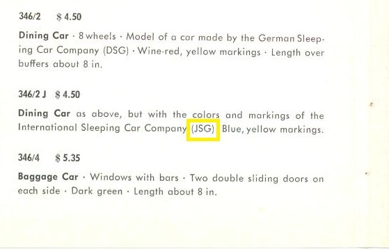

During a review of the catalogues I thought I'd found my answer, twice. In the 1954 catalogue, there it stated "Dining car, with the markings of the International Sleeping Car Co (JSG)" - hence my original question re JSG. My initial conclusion was that the "J" was reference to the JSG. However there is no such entity as the "JSG". Turns out this is clearly a catalogue printing mistake.
I posed it at the club Friday night, and friend Kevin took up the challenge saying he believed it was a mis-print and should be "ISG". This seemed plausible, except that the "J" suffix went back earlier than 1954. And, the "J" has been a consistent code for those variants. But I still wanted to confirm one way or the other.
But then it got more weird, in the 1955 English catalogue, it now became "ISG", consistent with what Kevin had found.

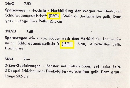

Just to be more confusing, the German 1955 catalogues for the same pages (22 & 23) still say "JSG" Hmmm. Have they not yet noticed the error?

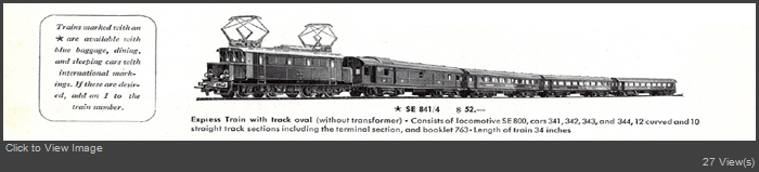

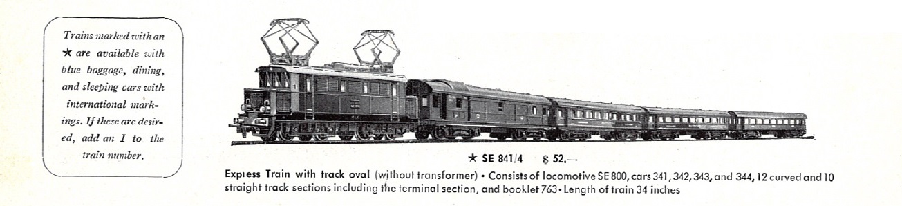

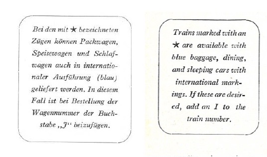

Further confusion - in 1950, and ONLY 1950, the catalogue states to use letter "I" for the International version. But just for one year, then changed to "J". Perhaps the I used there was also a misprint? Anyone with 1950 in other languages to confirm?
The question lingers. Why would Märklin use "J", when "I" would seem more correct? So, I started going backward through the catalogues.

346/2
1954 DE JSG

1954 SP JSG
1954 EN JSG
1955 DE JSG
1955 EN ISG

I've since found the German version of the 1950 catalogue (I knew I had it somewhere) and I note that indeed, they use "J" unlike the English version with "I" shown in my first comment.
It would seem that the "I" in the 1950 English version is an error
