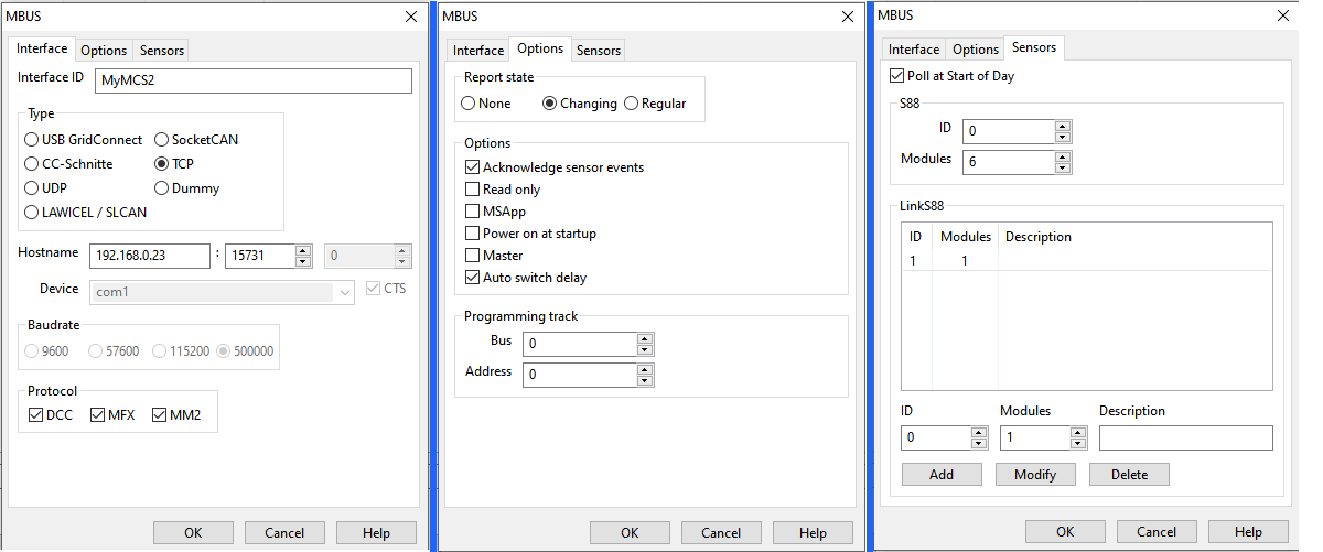

To select the "controller" (Rocrail terminology for Central Station) you need to go to Rocrail properties, Controller and insert a new controller MBUS
Here is my MBUS configuration (the 3 screens side by side)
The IP address you selected is not correct (it should be 192.168.0.xx
In my case my CS3 (also with CS2) is linked by an internet cable (straight or crossover no difference)
My configuration with a Windows 10 64 bit laptop is as follows:
CS2 IP Manuel
IP 192.168.000.23
IP Mask 255.255.255.000
IP-Gateway 192.168.000.001
DNS Server 192.168.000.001
CS2 CAN Broadcast
Ziel-Adresse 192.168.000.255
Rocrail /rocrail/eigenschaften/Zentrale  Adresse 192.168.000.23
PC IPV4 Eigenschaften
Benütze folgende Adresse
IP 192.168.000.101
Default Gateway 192.168.000.001
Use folgende DNS Adresse
192.168.000.001
I hope this helps

Thanks for clarifying.Any initial steps that I need to follow to have Rocrail 'see' my S88s and other decoders?
On Rocrail you use the mbus controller when using a CS2 or CS3. The controller declaration defines for Rocrail what interface you have with your layout.
I suggest you read this https://wiki.rocrail.net/doku.php?id=mbus:mbus-en
This is about how to declare the number of M88 (with flat cable) you connect to your CS2
Also the connection of a Link88 is explained
In this example a Link88 named "1" is attached to the CS2 or CS3 and 6 is the number of S88 modules.
If you have only M88 you don't fill the S88 part but only the number of S88 or M88 you have
I believe Rocrail obtains from your CS2 the length of your M88 bus

Thanks for the screen shot and example. I have 1 Link 88 and 4 S88 connected to the L88. I had not set up that last screen but now have. I have made much progress in adding signals and turnouts to my first sample layout.
Harvey
Offline Harvey
#27 Posted : 22 August 2021 17:06:53(UTC)
Harvey
Joined: 17/02/2008(UTC)
Posts: 607
Location: Glen Oaks, N.Y.
I have set up the MBUS screen as shown by Jean, with LinkS88 ID=1 and Modules = 1, I have 2 buses attached to the L88, each bus is length 2 (so, 4 S88) I entered 5 for the S88 Module box in Jean's screen.
I am now trying to add a sensor to my track diagram. But not understanding the instructions. Hopefully my screen shot of the Sensor Interface appears. I set the address to that of my S88 (1011 or D3). Left the node ID at 0 and did not change anything else. On the general tab, I named my first sensor as WEMS (West End Main Station).
After applying and hitting Ok, the sensor is on my diagram but nothing changes (on the real layout) when I click on the button.
Appreciate advice.

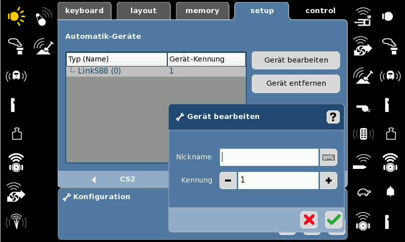

#30 Posted : 23 August 2021 11:11:15(UTC)
Posts: 3,586
Hi Harvey
here are some shoots in the dark
The CS2 Lin88 screen looks like this by me (sorry German version)
Notice the 1 that should also appear in Rocrail screen (instead of 115 by your layout)
One feature of Rocrail is great: the Sensor Monitor. You can start it by the Control Tab/Sensor monitor
What is does is to report any sensor activity in a log format. So if you are not sure of a sensor address then start the Sensor monitor and toggle (trigger) your sensor and the address will be displayed. Of course the link CS2 - your Laptop should be working.
What I did is to use a routeur as a link to connect the CS2 and the layout in DHCP mode. So the router assigned addresses. Next I kept these addresses "frozen" in manual mode (non DHCP), using a direct Ethernet cable between CS2 and Laptop (It can still get access to the Internet by WiFi)
How to check the link
  1. Does the power ON / OFF on Rocrail sets the CS2 accordingly?
  2. When changing the speed on a loco from Rocrail changes the speed of same loco on the CS2?
  3. Conversely when changing the speed of a loco on the CS2 changes the speed of the same loco in Rocrail?
  4. Do all the switches can be controlled directly from your Rocrail screen?
  5. When a switch is changed from the CS2, does it reports the same change on Rocrail?
  6. When a sensor is changed on your layout, does it shows on the Sensor monitor?
Sorry for th boring message but sometimes testing is boring but is the prelude to a lot of fun in Rocrail operations
