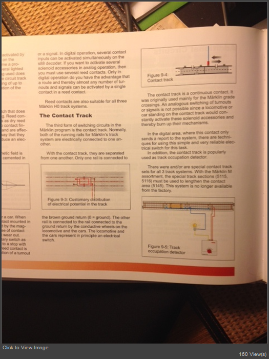

Hi Fabrice,
Thanks for answer. It seems like if I need to install more contact tracks for train detection in the other places too I will not do this then. It gets too complicated. But if it is possible to do this with routes, two contact tracks and one S88 then I will do it and take away those two power feeder wires from that track section / block. One more question: How do I get power feeded to this block?
If I run a train on this outer mainline and the first contact track section detects the track block as occupied and S88 sends command to CS2 to switch the turnouts, it would be best to first switch only the turnout on the other side of this block and not the one where from the train comes as otherwise the rolling stock would derail... I think the whole layout should be built differently to be able to use these S88 and contact track sections like they should be used. Full computer control is then again a different story. The track section lenght between the two 24995 contact tracks would be around 3 meters and after them there is turnout on each side.
Maybe this is "mission impossible" and I will then just stay in using routes to switch my turnouts like at the moment without any train detection by contact tracks and routes controlled according to this.

Hi Fabrice,
You may provide "B" (power) without any trouble inside the block. But for ground (0) if you provide it inside the delimited section, then ground will be always "on" on the two rails and no event can be generated as there is no state change...
Either:
-Provide ground only on the rail side NOT involved in the detection
-Or use 2 sets of 24995, one at the beginning of the block (for instance to trigger a signal going to Yellow using a very simple route), and the other one at the end of the block. In such a case, put your feeder (B+0) between these 2 sets.

If you already know how to detect occupancy and make contact tracks ( I also make them like it sounds like you do--super easy with C track) and make blocks, then you are easily halfway there.
I am still learning my way around iTrain but if I will help you where I can

You should get this Marklin book on Signals
BrianM attached the following image(s):

Hi Esteban
I think I understand your question.
First a few basic principals.
A contact track is a track that has the two outer (ground rails) electrically separated from each other. One of these rails is connected to the ground on the track on each side of the contact track. (The red, or power, or middle rail is always live and connected to the power of the layout and NOT isolated in a contact track). The other outer rail (electrically isolated) is connected to a detection device like a S88.
When a loco or car with metal wheels crosses over a contact track, the metal wheels complete the circuit of the ground rail through the wheels of the car or loco to complete the circuit and trigger an 'ON' reading with the s88 detection device.
As stated in the M signal manual 03402
"Normally, both of the running rails for Marklin's track system are electrically connected to one another. With the contact track, they are separated from one another. Only one rail is connected to the brown ground return (0=ground). the other rail is connected to the the rail connected to the ground return by the conductive wheels on the loco and cars. the loco and cars wheels represent in principle an electrical switch."
So yes you may put a B and O inside of a contact track, but the O would only be attached to the one "active rail".
A contact track needs to be as long as the longest distance between any two wheels on your train consists (loco or cars). In practice this is generally either long low side gondola cars or passenger cars and usually one uses about 20-30 cm as a contact length.
I do not make the entire block a contact track. I usually try and have at least 2 contact tracks per block (enter and exit) and will try and have a middle contact track in shadow yards or stations. Some people will make the whole block a contact track (especially in shadow yards and stations) so they can always tell if there are any cars or loco's in that block (detection block).
So in a simple digital software controlled layout you have ALL tracks powered via B and all regular tracks and one rail of each contact track connected to ground via O. You then have the 'other,isolated, rail of each contact track connected to a s88 detection device.
So there are no isolated blocks in terms of power (B) only isolated rails in the contact tracks on a software digitally controlled layout.
I hope this helps. If you have any questions let us know.
