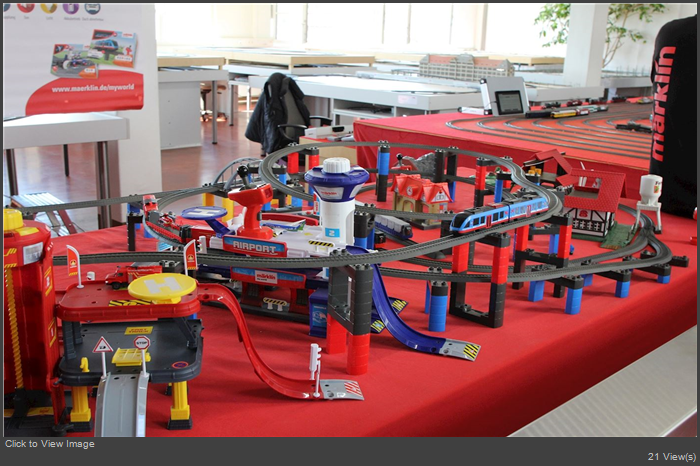

#14 Posted : 04 February 2021 01:46:19(UTC)
Needless to say, the coaches and the loco should not have been released for sale before a thorough testing was carried out. If Marklin claim they carried out such testing, then they are lying.
....the installed 72021 couplers are NOT suitable and Marklin shouldn't have supplied them, meaning they didn't test them with these coaches. The lazy so and soes who suppose to carry out the test are telling their "Mushroom" bosses that everything is alright.
Them's pretty harsh words and dare I say completely without proof.
I don't know specifically what testing was done on your coaches or on 72021 couplers, but here's some pictures of test tracks Marklin have in the factory. As you can see they are quite comprehensive. While I suspect they wouldn't test every item they would test representative samples of each item.
You keep on ranting on about bad Marklin quality, but you seem to keep on purchasing items only to have further rants. A definition of insanity is to keep doing the same thing but expect a different outcome!
They do some test runs with pre-production samples on the large layouts before production starts (at least I hope they do).
They have smaller layouts where every loco should get a short test run. I had a loco arrive without brushes, so I'm not sure they really test every loco.
AFAIK they do not make test runs for coaches after production. I don't think there is more than just a short lights test for coaches with interior lights.

#25 Posted : 07 February 2021 16:43:21(UTC)
Posts: 9,315
Those pictures does not tell IF Märklin test this way with the wagons pulled by of difference locomotives.
I am surprised to see S curves on the test track when Märklin recommended by self do not use S curves on your layout.
That really goes to show how much Märklin care about their customers and users. They know that we can't always have ideal layouts and that we have to make do with what limited space we have (using lots of R1 radii for example).
I've almost never had problems with Märklin gear going through the odd S-curve or other weird track combinations. But with other brands and makes I've often had to make lots of changes and adjustments to couplers, bodywork, buffers etc to secure smooth and safe navigation through "tough" spots.

ANDERS, BY HAVING S CURVES ON THEIR TEST TRACKS, THEY CAN PROVE WHICH PRODUCTS SHOULD NOT BE USED ON S CURVES.
