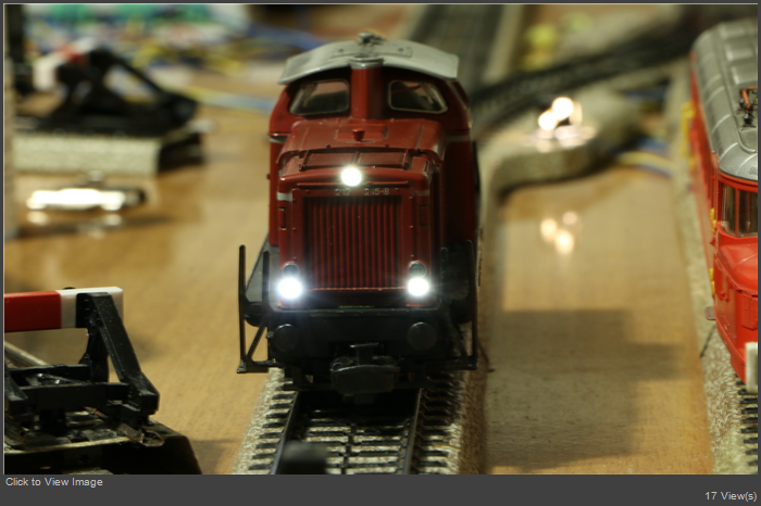

I also have this 26 year old train that runs perfect, and I want to convert it to digital, but don’t know how and I dont know what model it is, it was from a started set. I saw alot of online videos, but what kind of decoder would I need, and I heard you can have a decoder that allows you to upload your own sound effects is that true?

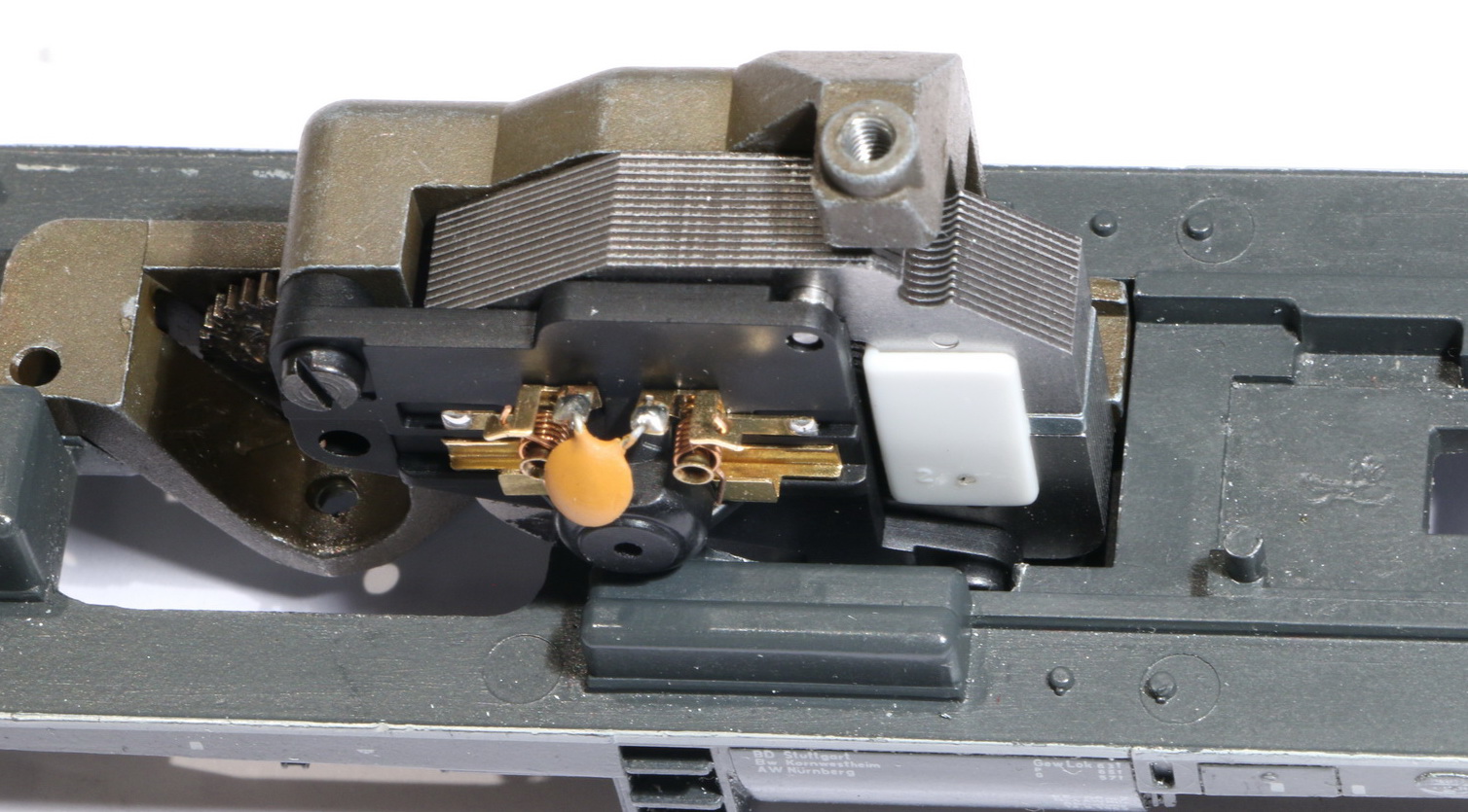

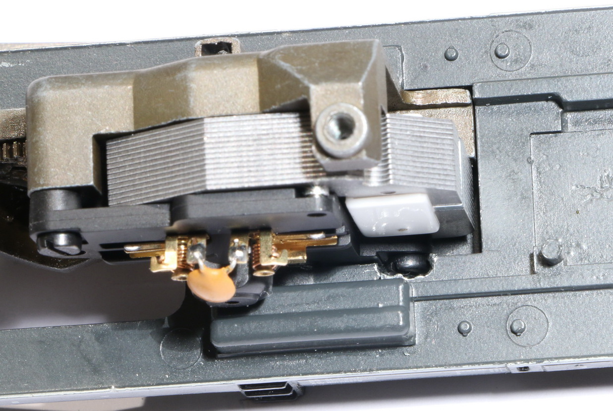

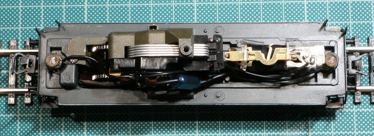

Ok so as requested here are the inside photos of the loco’s engine I hope this helps

Hello
Thank you for the good pictures.
That old motor is a Large Flat Commutator Motor (LFCM).
The modern high efficiency motor which you require is therefore the Marklin 60944 kit. As mentioned in one of the attached threads, the new motor magnet will perhaps require a slight filing down in one corner to get it to fit neatly into the chassis.
As I mentioned previously, the Marklin 60986 Sound Decoder would be suitable, but some other brands would have suitable sound decoders too.
Which Digital Controller will you be using ?
Reason for my question relates to the choice of Sound Decoder.
If you have a Marklin Digital Controller, then the Marklin Sound Decoder would be my choice.
I should mention as well that it would be highly recommended to swap the old lights for new lights, in particular because the old lights will flicker due to the old method of connection to ground AC in the light socket. Hence, two light sockets Marklin E276770 and two lights E600080 would be suitable replacements.

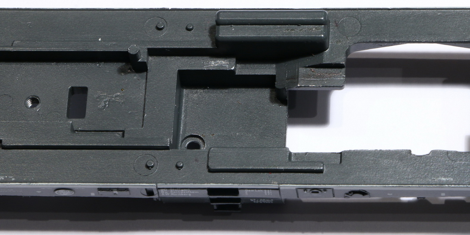

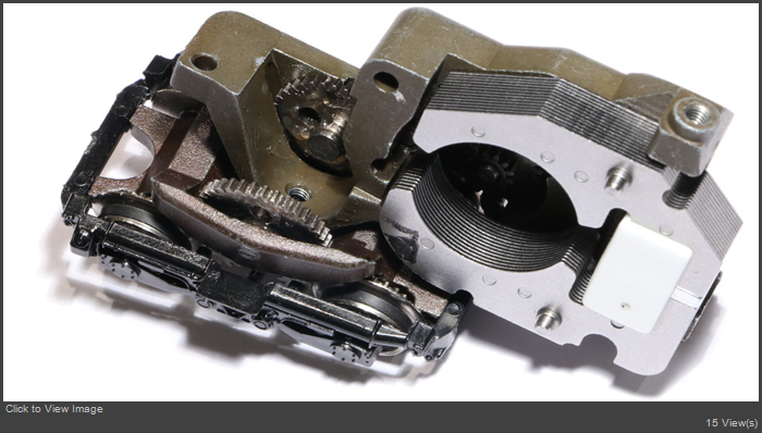

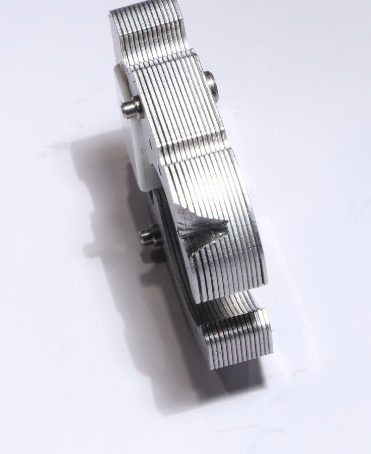

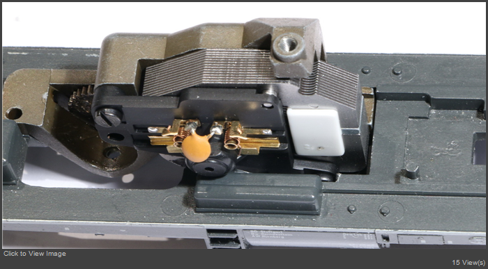

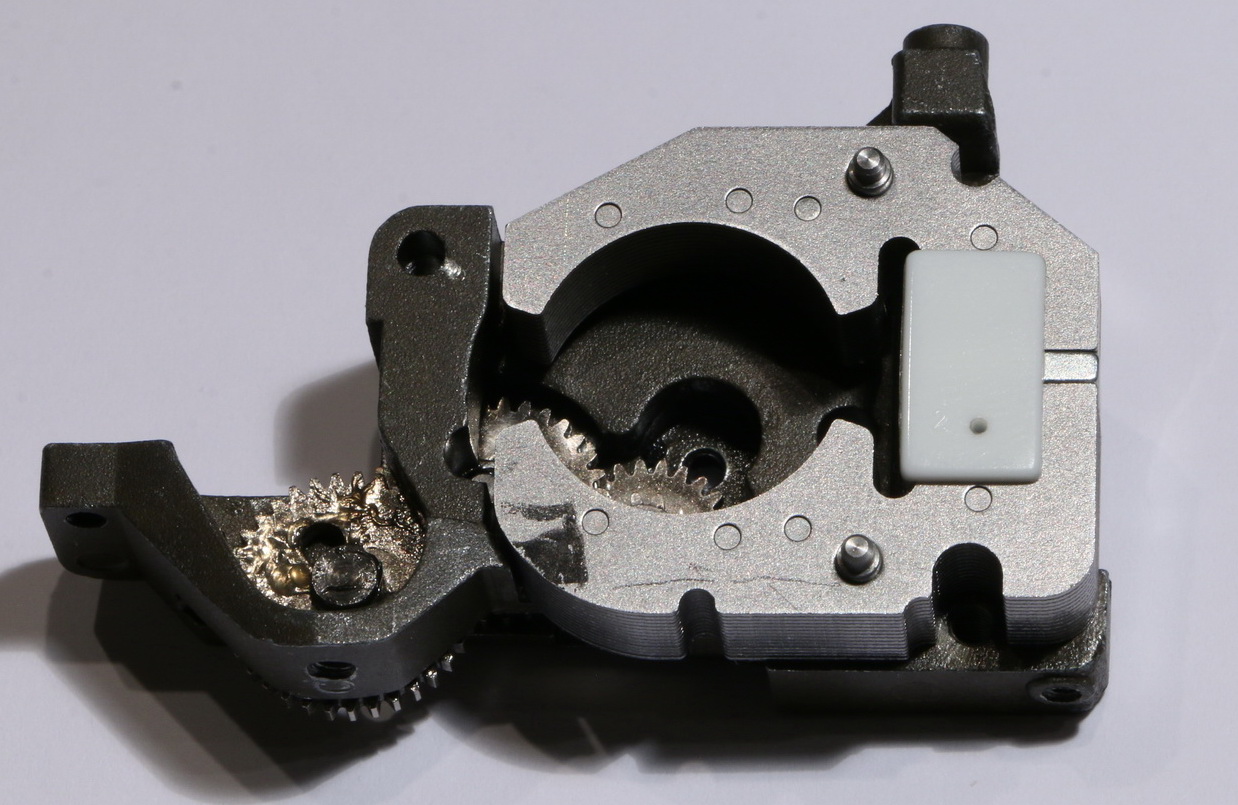

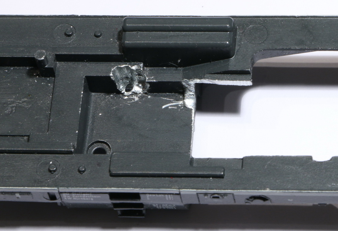

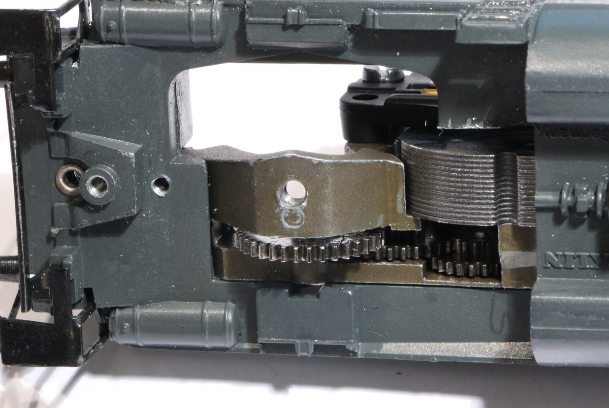

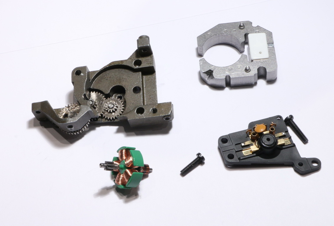

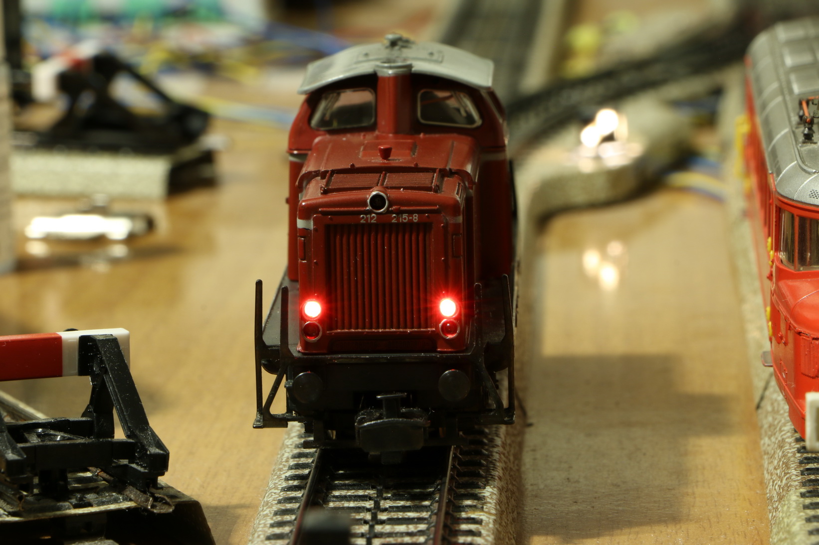

The 3072 can be converted with the 60944 motor.
But the new motor is thicker than the old one. So you need to do alterations on the loco body and the field magnet to fit the motor in.
Is not an easy conversion!!!!

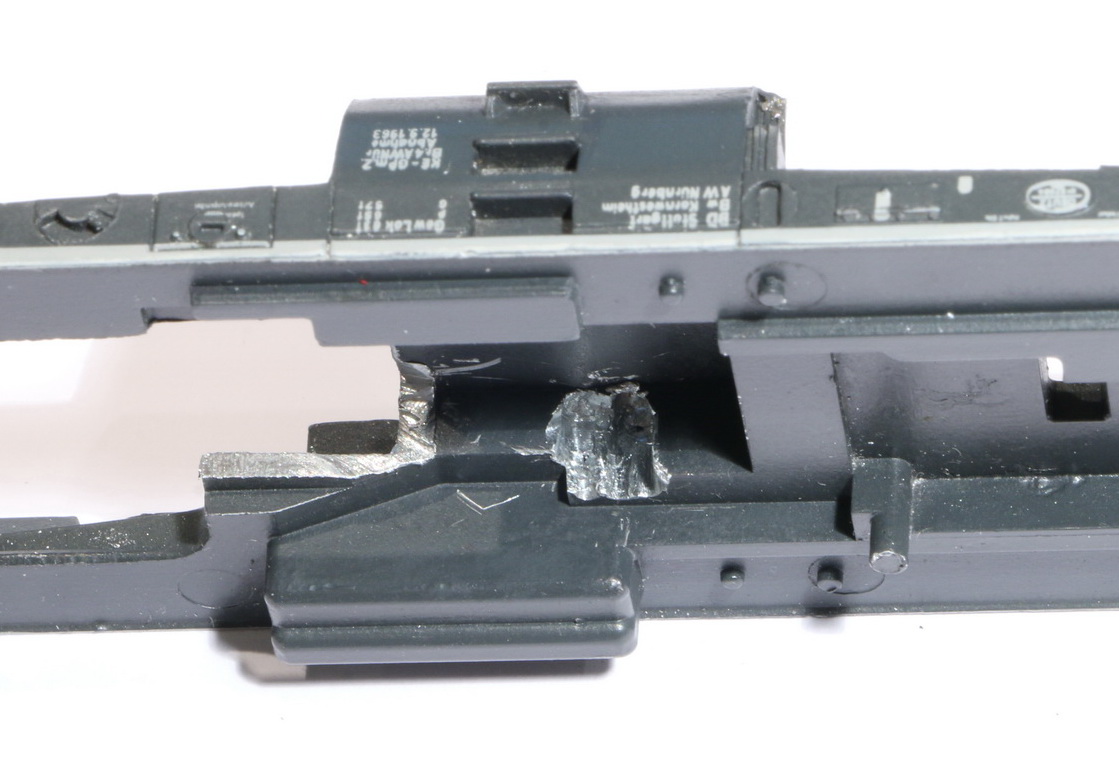

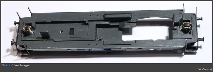

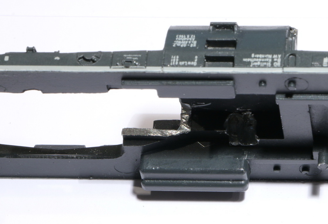

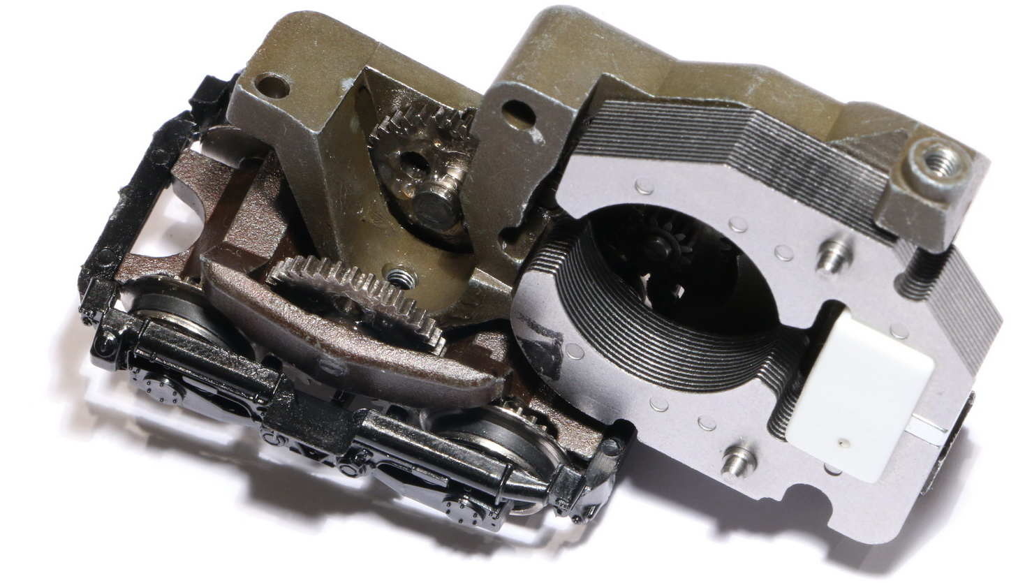

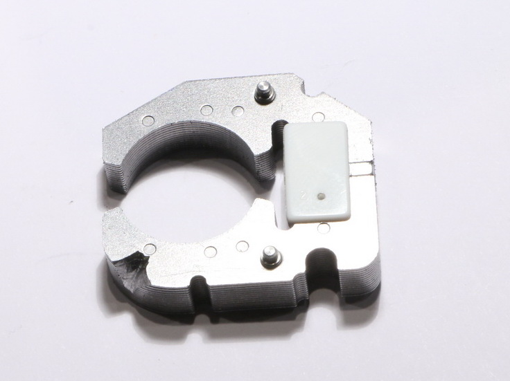

Some pictures from my conversion:
The Original
The two magnets
Some metal must be filled for the thicker magnet and the screw to be fitted
The new motor in place!!!
Next problem:
The magnet is to thick and on curves has a contact with the rear bogie
So you need to file some metal from the magnet where is marked
Better now
Final motor assembly: be careful the two screws are not the same!!!
Everything in place working fine
The loco ready
The WW and Red LED lights is another story......
I hope that this will help you because there is no other way if you want a 5pole motor
If you have any problems during the conversion don't hesitate to ask.
Have fun
Costas
The Original
The two magnets
Next problem:
Better now
The loco ready
Have fun
Costas

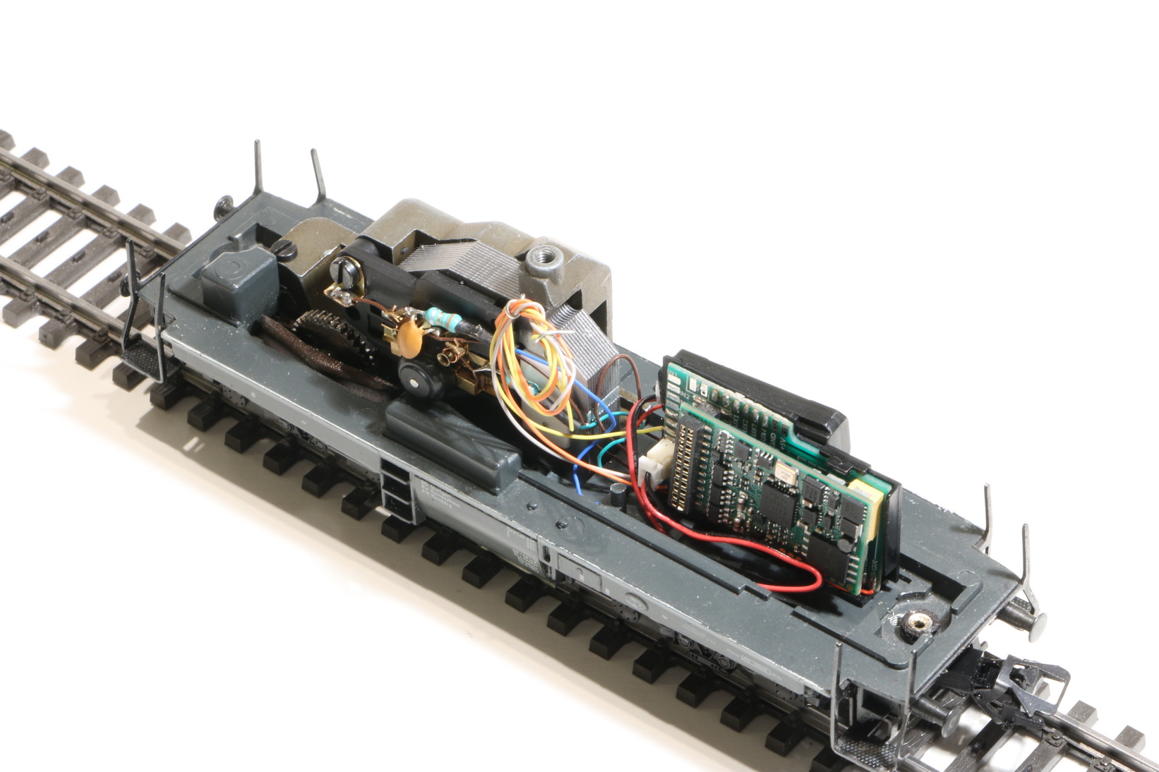

Wow Very impressive work, thanks for the detailed instructions Costas, I am definitely following your method of conversion. 2 things come to mind:
1. I noticed the digital decoder in the loco in the pic does not have a switch board of numbers to assign the address.
2. And would the model 60944 be compatible running using a 6021?

The decoder is an mFx sound decoder (dip switches are 20 years old story)
To use your own sound is possible with Märklin mSD3 decoders as well with the ESU LokSound 5 decoders.
To do that you need special hardware and software and a lot of knowledge. Is better to leave this to somebody with experience in sound decoders at the moment.
The Original
The two magnets
Next problem:
Better now
The loco ready
Have fun
Costas
Hello Costas,
So I started the digital conversion process and here is what I am ordering for parts:
- Marklin 60944 motor
- Marklin 60976 sound decoder
- But for the front and rear lights (white and red) how can I set them up like you showed in the pics, and what parts do I need ?
