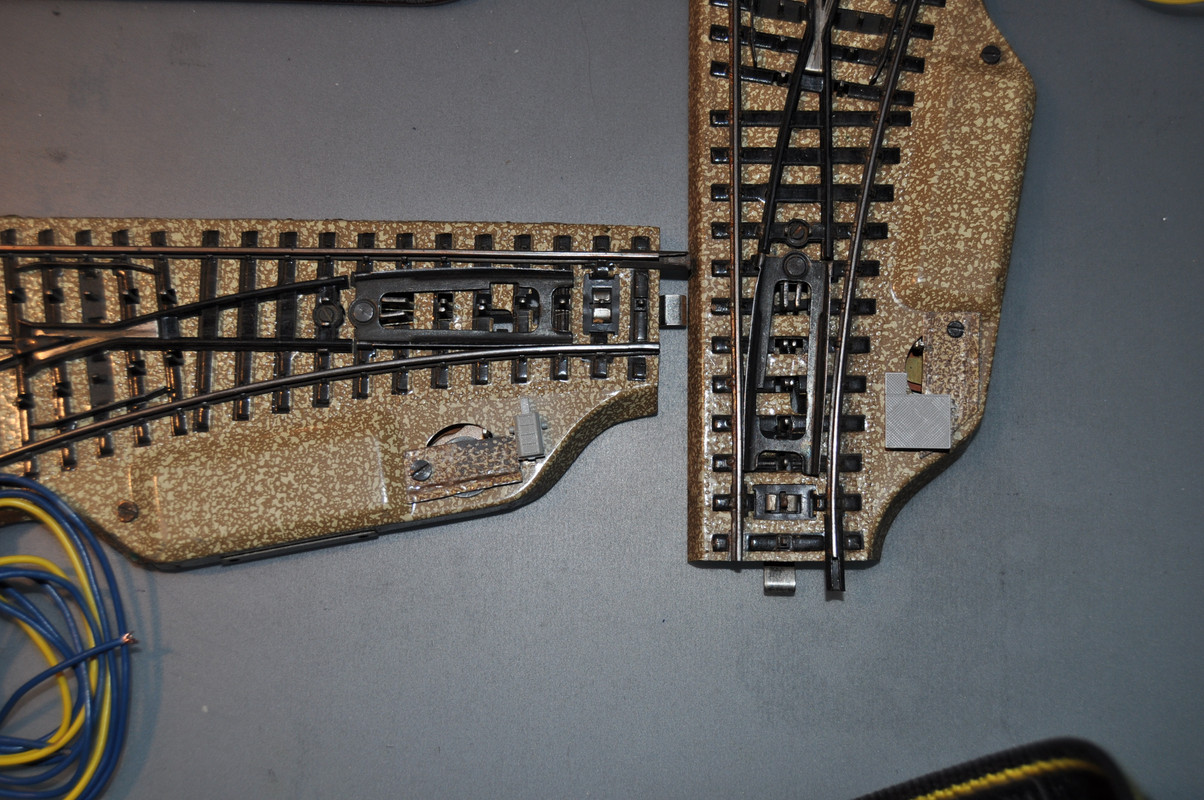

I was always wondering what to do with the long 1:87 or even 1:100 like Roco TUI coaches when using M Track. There are even modern Märklin coaches which can't pass the lanterns. It is as simply as this: Take away the lantern. Cut a piece of metal from the underneath cover or any rotten piece of track. Size: ca. 18 x 10 mm. Drill a 2mm hole and fix the new metal cover instead of a the lantern. It doesn't take much time to do this job.
And while working with the turnouts why not clean all of the mechanism at the same time?
https://www.marklin-user...-to-make-a-total-upgrade
I am sure the turnouts will work another 60 years; maybe even more.
