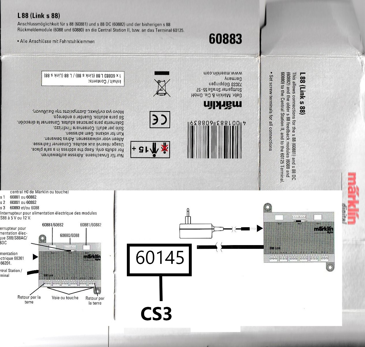

I am worried by the marklin module 60883 and his connection with CS3. To clarify more. I attach a picture of the 60883's box with a draw of my connexion projected. Indeed this 60883 will receive signal of contact fromr MARKLIN 7555. BY THE WAY (other question): HOW DO YOU ATTACH THE 7555 ON THE TRACK TYPE C?
Some one among you would confirm that it is suitable?

there are no problems connecting a Link88 (60883) to a CS3.
You can connect it direct to the CS3 or through a 60145(/or 60125) terminal box.
Please see the manual for 7555 to see how to use it with C tracks.
The electrical connection using 60883 is similar to the 60881 which is shown in the manual:
https://static.maerklin....d3b291882b1583241759.pdf
Per
