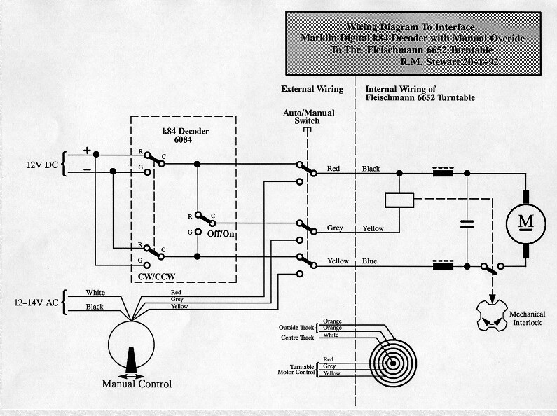

I am rewiring the motor drive on the turntable. The old wires that connect the motor and solenoid are not there any more, so I am trying to figure out where to solder each wire. Can anyone help, please?

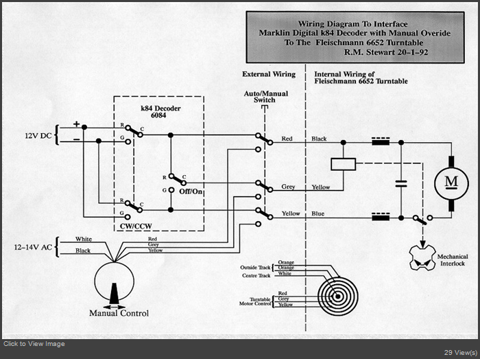

FleischmannWiring.jpgThe turntable is made by Fleischmann and I have the Marklin (3-rail) as well as the Fleischmann versions. In both cases the item number on the manual is 6651 or 6651C. I found a circuit diagram from 1989 but I can't figure out how to include a picture of it here.

I see you (name?) found my diagram,
Auto Manual-Wiring for Fleischmann 6652 turntable
Link corrected 31-12-2024
Hope it helps
Hope it helps
It was very helpful. My biggest issue was figuring out the distance to the turntable center of each electrical wiper, but the whole thing worked once I soldered new wires and repaired a cut in the solenoid wires. I installed it and it is now earning its keep on my switchable 3-rail & 2-rail layout where I run Hornby Dublo trains using Marklin K-track.
