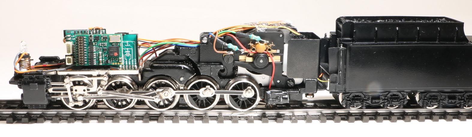

#5 Posted : 31 May 2020 19:55:52(UTC)
ktsolias
Joined: 01/05/2016(UTC)
Posts: 624
Location: Athens

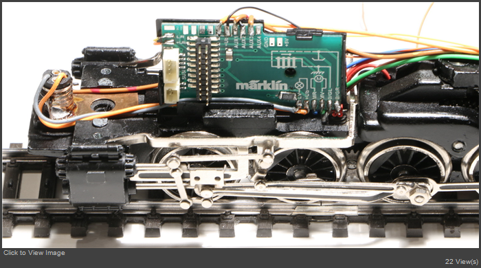

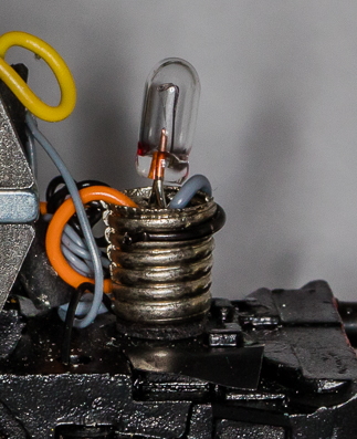

This is my conversion
General view finished
The light and smoke part
The Br/Red wire is AUX1 for the smoke generator
If you need other detailed views don't hesitate to ask
Good luck
Costas
