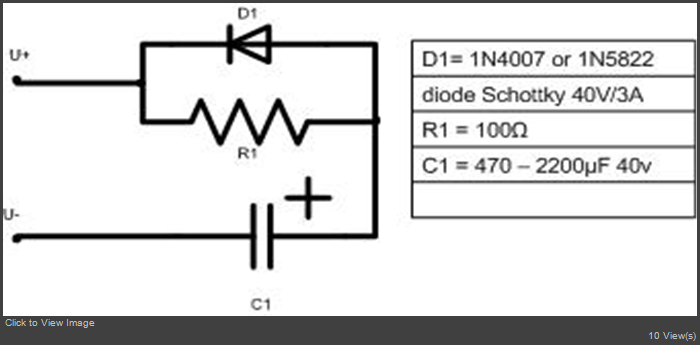

Offline ktsolias
#9 Posted : 18 May 2020 22:20:07(UTC)
ktsolias
Joined: 01/05/2016(UTC)
Posts: 624
Location: Athens
I use this one
Costas

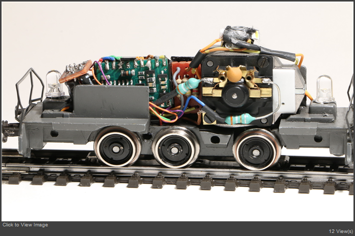

This is the picture of my DHG 500 3078
motor 60943
Decoder 60760
And the small buffer in the front made by me
I use the biggest capacitor who can fit inside each loco
Costas
