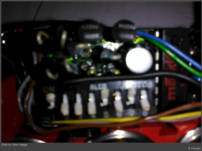

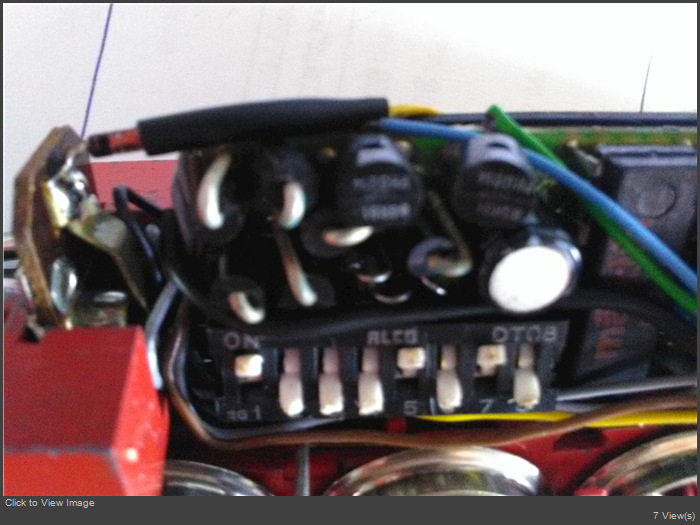

I was curious about the flickering light fix for the 3090 decoder mentioned below. I think mine has a 3080 decoder and it must be an early version as quite a few of the electrical bits are quite large.
Is there a fix for this flickering?
br86 3696 front bulb.jpgbayonet bulb shown.
many thanks

The decoder you have is a 6080, and it has the same driving characteristics as a delta because it is the same design in its motor output.
The light bulbs would need to be replaced to have a ground wire rather than grounding through the chassis, then follow modification 2 on the following website https://www.pallund.dk/convert2.htm
