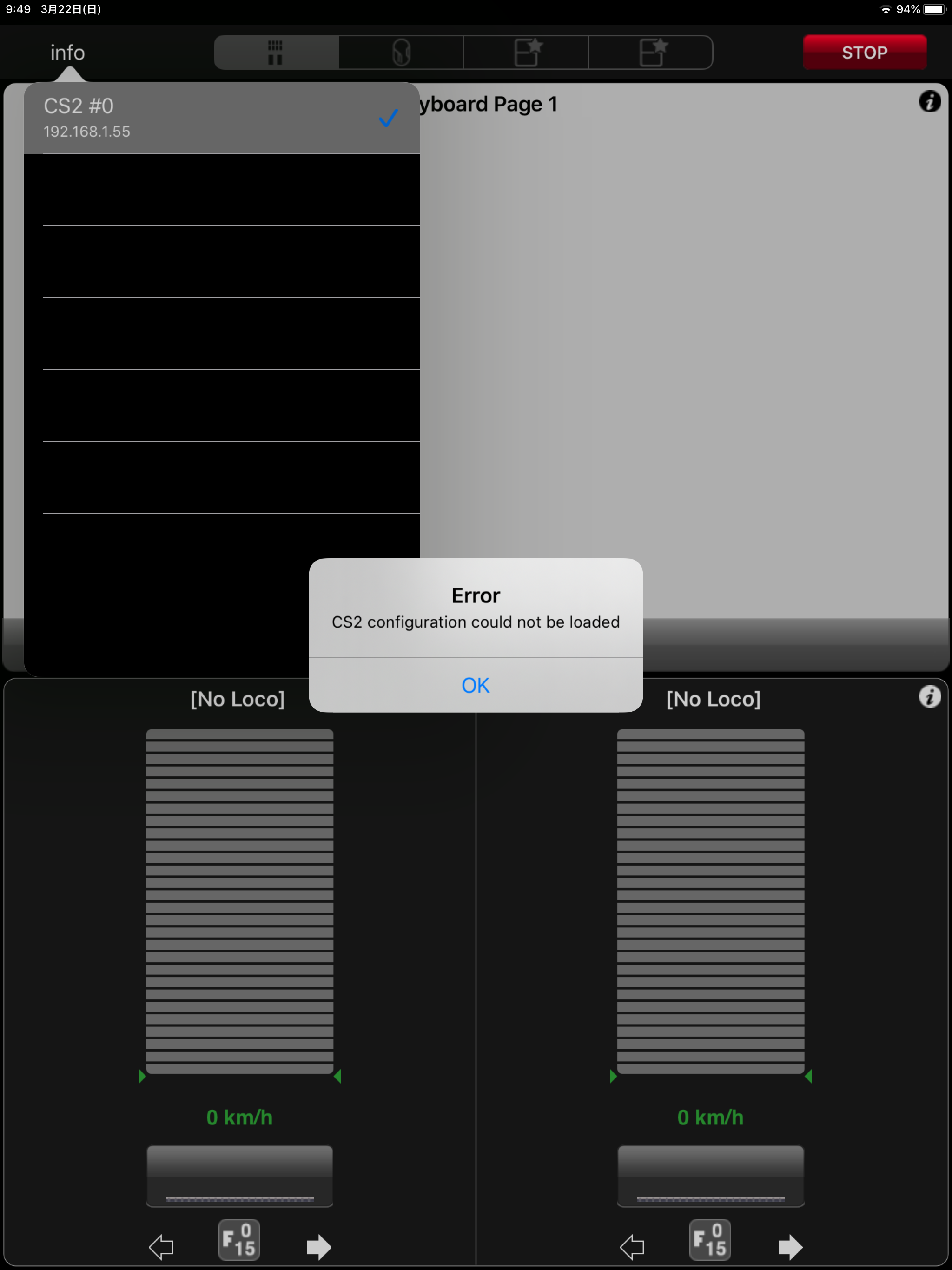

May be I am way too behind the time as Marklin has moved from CS2 to CS3 long time ago but I just got new CS2 60213 (NOS I suppose) last week(!) and started to ply with it.
It works absolutely brilliant. However, when I tried to connect installed Main station on my iPad (iOS 13.3.1), using WiFi router, CS2 and iPad is communicating each other and recognize each other but I keep getting error message.
I tried many things.
1) WiFi router (tp-link: TL-WR902AC) disconnected with internet and put it into Bridge mode. DHCP ON. IP recognized but get error message
2) WiFi router (tp-link: TL-WR902AC) disconnected with internet and put it into Bridge mode. DHCP OFF. IP were set manually. IP recognized but get error message
3) Connected other WiFi router (Huawei Echo Life HG8045Q) with internet. IP recognized but but get error message
In all cases, I can operate STOP switch on and off but keep getting error message saying 'CS1 configuration could not be loaded'.
I am not sure what to do now...Is it iOS version or WiFi router or Marklin Main Station app has a problem coping with this set up?
If you have any suggestion, it will be appreciated.
Thank you.

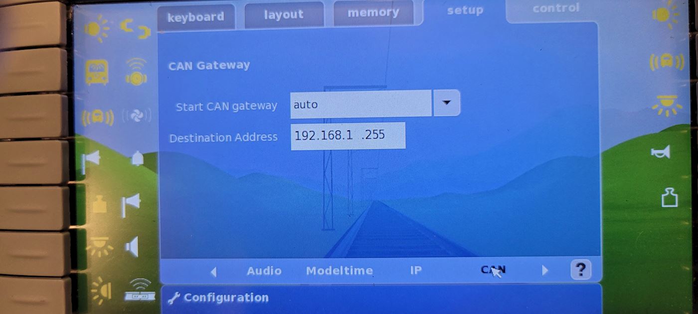

One other thing to check is the Can gateway settings.
In the CS2 Setup select the CAN tab.
Start Can Gateway should be set to Broadcast
Destination Address should be set to the Broadcast Address for your network. If you are using a Class C network (network mask set to 255.255.255.0 in your IP settings), your broadcast address will be xxx.xxx.xxx.255 where xxx.xxx.xxx are the first 3 octets of your network subnet.
For example, if you are using 192.168.0.x as your network, your Destination Address should be set to 192.168.0.255

Thank you so much for your advice! I did try with CAN set up but unfortunately it is not going through...both iPad and CS2 are communicating each other so stop/go switch can be operated and iPad condition can be seen on CS2. However, I am still getting error message...

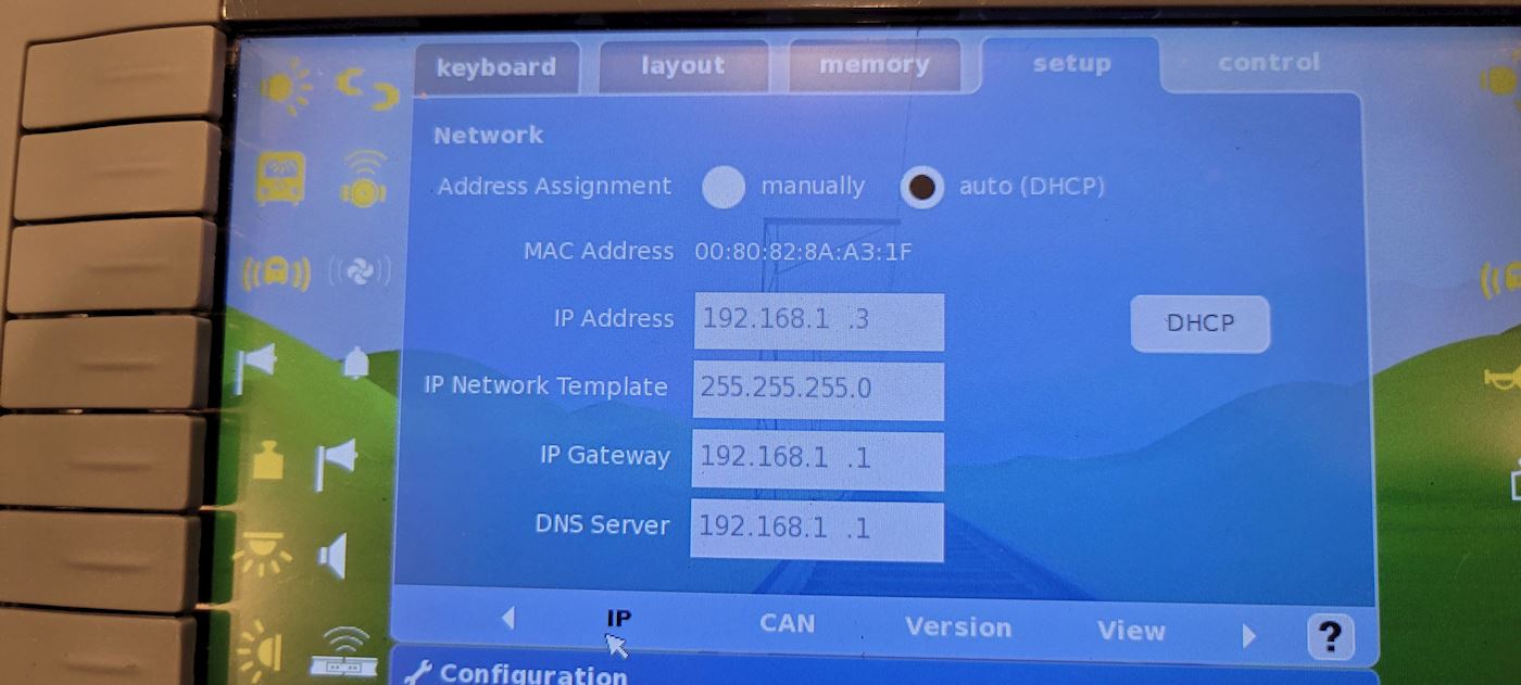

It works very easily when the PC is directly connected to the CS2 by a normal or a crossover Ethernet cable (both can be used). It works only if no other application is using the link (e.g. Rocrail)
The CS2 IP address I use is
CS2 IP Manuel
IP 192.168.000.103
IP Mask 255.255.255.000
IP-Gateway 192.168.000.001
DNS Server 192.168.000.001
Good luck

It seems you are getting a connection, since you say you can use the Stop button to put the CS2 into stop mode. That and the fact that your screenshot says that you are connected to 192.168.1.55.
Do you have another device that you can try with? Either an Apple phone with Mainstation loaded, or maybe an Android device with CS2 Remote loaded (similar to Mainstation but free). If either work OK, then it is a problem with your iPad, if not then the CS2 is probably at fault.

Thank you very much for advice from everyone. I did try all of your suggestions but....no, still not working correctly. I have a very old iPad but it didn’t work. I don’t have any android pads or phones so can’t check.
I more thing I will try is to use old WiFi router, from same era as CS2. I saw someone’s blog saying it was a hell to connect CS2 and iPad using latest WiFi router. I just found WiFi router from 2010, still new(!!), very cheaply so I bought it and waiting it to be arrived. I will them see what will happen.

Hi, Did you try deleting the actal configuration and starting from cero? try that it could work.
Another point is to put manual in the IP configuratio nof your CS2. Let me know if it works if not I will send you pictures of my configurations IPAD-CS2

Hi, I the set up of your CS2 are you using manual IP or auto I will recommend to use manual. After doing this eras the data In the iPad and try again. I have used the main station and mobil station in iPads and iPhones with no problem at all.
I even use more than one iPad at the same time and works just fine.
