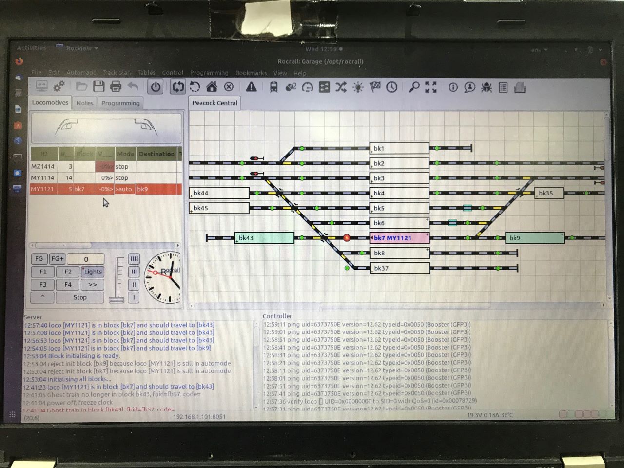

Rocrail isn't the easiest concept to get along with, but I am reading through the wiki and guides.
I managed to get a loco to runs through a route, but no more, and I don't know why.
As soon as I tell is to go, it puts the name of the loco in the destination block and turns the background yellow. Yellow means block is reserved it says. I've reset the blocks, and all locos, tried restarting, but it insists the block is reserved.
Get this in the trace:
20200204.144103.000 r4201a CFC17700 OLcDrive 0121 Setting state for "MY1121" from LC_INITDEST to LC_CHECKROUTE.
20200204.144104.101 r9999a MY1121 ORoute 0926 blockid [bk43] in route [NEWsdrfgd] is --from--
20200204.144104.101 r9999a MY1121 OBlock 3526 depart loco [MY1121] from block [bk43]
20200204.144104.101 r4202a CFC17700 OLcDrive 0142 setting signals...(useCurBlock4Signals=0)
20200204.144104.101 r4204a CFC17700 OLcDrive 0189 curBlock [bk43]
20200204.144104.101 r4204a CFC17700 OLcDrive 0195 next1Block [bk7]
20200204.144104.101 r4204a CFC17700 OLcDrive 0201 next1Route [NEWsdrfgd]
20200204.144104.101 r9999a CFC17700 OLcDrive 0231 no second next block available: YELLOW
20200204.144104.101 r9999a CFC17700 OLcDrive 0122 check signal pair: route=NEWsdrfgd block=bk43 fromTo=true signalpair=false sgpair=2
20200204.144104.101 r9999a CFC17700 OLcDrive 0376 set signals in block [bk7]
20200204.144104.101 r9999a CFC17700 OLcDrive 0122 check signal pair: route=NEWsdrfgd block=bk7 fromTo=true signalpair=true sgpair=2
20200204.144104.102 r4201a CFC17700 OLcDrive 0116 Setting state for "MY1121" from LC_CHECKROUTE to LC_PRE2GO.
20200204.144104.202 r4201a CFC17700 OLcDrive 0051 Setting state for [MY1121] from LC_PRE2GO to LC_GO.
Any help appreciated.

When you put Rocrail into Automatic and start a locomotive it should reserve the next 2 blocks available on a route for that locomotive and turn those 2 blocks yellow. If only the first block is available it will turn that block yellow. That can also happen if the first block is a Wait block and you have not selected to reserve the second block even if the first is a Wait.
If I understand correctly you select the loco to start, the blocks turn yellow (which is correct), but the loco does not move. What does it say for the loco: Wait, Auto, or something else?

14:58:41 loco [MY1121] is in block [bk43] and should travel to [bk7]
And
MY1121 5 bk43 <0% >auto bk7
And then nothing. Lights are on on the loco and the block sensor can see it's there.
But I have tried lots of different things. Sometimes it says <wait, sometimes <auto... Either way, nothing ever happens.

If it says Auto for your loco and reserves the next block, then Rocrail is functioning as it should, but your CS3 does not tell the loco to move. Have you checked whether you can turn the CS3 on and off from Rocrail? If that works then you at least know that the 2 are still communicating with each other.
Can you move the loco from Rocrail in Manual?

Yes, manual works from Rocrail and the CS3.
I just tried a manual run, and it went to the destination block, and when it hit "In", it stopped and changed the lights over.
I then dragged it back to the the original block, and it changed lights and started going in the wrong direction, but that's just a matter of swapping direction, I assume.
Problem is, after that, I couldn't get it to move again. It's like it thinks it's gone somewhere else, and I can't get it to understand it's still in the same block.
I ran out of time, will look at it again after work.

Something doesn't sound right here. In Rocrail Manual mode there should be no destination block. There should be no automatic changing of lights, etc. You should have total manual control of the locomotive and its functions, the same as if you were manually operating it from the CS3.
What you are describing sounds like you have Rocrail Automatic selected and rather than just starting the locomotive for Rocrail to determine where it is going you are manually selecting it to run to a certain block by dragging the loco icon to a certain block. Why it changes direction when it reaches the In sensor of that block is puzzling unless you have selected the block type as Terminal. This designation should only be used for a stub track off of a turntable or a stub track in a yard. If you have designated a Terminal block in anything else you will have a problem.
Perhaps you can post the Rocrail track plan showing where the problem occurs.
Reading this gives me the impression that you are using drag & drop automatic mode to run the loco. Did I understand correctly that the loco changes its direction twice: once when it hits the "in" sensor of the destination, and once again when you use the drag & drop to send it back? If so, then the logical direction of the loco does not match with the direction it should go, and it will stay put. You can try to change the logical direction before the second drag & drop to see if that helps.
In any case, I agree with Peter that something is not right. Check the destination block definitions!

I spent too much time on this yesterday with work etc, will do some testing over the weekend.
Can't remember the manual test, I didn't use drag-n-drop, maybe it was a different test were it stopped and changed lights.
It's must be something simple causing this, I have read the step-by-step start-up guide several times, but it's not very good at explaining.
I still don't understand the '<', '>' & '-' signs in the loco status window. Nor really what the difference between 'auto' and 'wait' is and these things don't seem to be in the Rocrail wiki.
At one point the trace window did tell me the block didn't accept trains in the direction I was coming from, so that was helpful, but I haven't had that since. I'm sure it's just a direction problem somewhere, but it's odd how I can sometimes go from block 1 to 2, and it seems to kinda want to go from 2 to 1 after that, but nothing else, and I can't get it to accept picking up the loco and manually placing it.
At the moment I only have one route set-up, between adjacent blocks '7' and '43' and back. I believe I have set the entry direction correctly.
I will post up some screenshots later in the week or over the weekend.
Thanks.
P.S. Found this, will have a read: https://wiki.rocrail.net/doku.php?id=loc-tab-en

I agree that it appears to be a setting that is ticked or a definition of a block type that is causing you this problem.
Some basic Rocrail info to help you out:
1. You can use Rocrail in 2 modes: Manual and Automatic. In Manual you have total control of the locomotive as far as direction, speed and functions are concerned. It acts like any other controller such as your CS3. It does not go to any assigned block nor does anything unless you tell it to. In Automatic you have 2 choices. You can either select the locomotive and ask Rocrail to Start it or drag the loco icon to a desired block. Rocrail will then select an available route, start the loco and take it to the next block(s) at the speeds and with the functions set up for the block(s) or Route. The loco will keep running in this mode until you stop Automatic mode for that loco or perhaps it enters a Terminal block. If you use the other alternative of dragging the loco icon to a specific block you need to make sure that the "Swap loco entry" has the loco direction defined properly with the actual direction of the loco on the track and that this direction will take you to the desired block. If the direction is wrong either physically or for getting to the desired block, the loco will just sit there.
2. The symbol ">" means the loco is set for Forward direction.
3. The symbol "<" means the loco is set for "Reverse" direction.
4. In Automatic mode "Wait" means that the loco is either waiting for a Route/Block to clear so that it can be reserved, or it is in a Block that has the Wait function enabled (such as a station track). The Wait time is defined either by the loco settings or the Block settings. Once the Wait time has timed out the loco continues on in Automatic mode.
5. In Automatic mode "Auto" means the loco has been assigned a route and should move. If it doesn't, it either isn't getting the signal (give it a nudge) or it is facing the wrong direction or in some occasions the loco has wrongly been defined to run in Reverse.
Hope this helps.
Why can you not run the train back down the track?
I suspect the reason it won't run after you manually move it using "the hand of god" it looses track of where the loco is and thinks it is still at its destination. Now there is something it knows is at the source point it shows the track as occupied, but it doesn't know it is the same loco.

Hi, I couldn't find all the files you asked for but:
http://www.morsing.cc/Trains/plan.xml
http://www.morsing.cc/Trains/occ.xml
http://www.morsing.cc/Trains/rocrail.ini
Another problem that has now started is that the sensors in RocRail are no longer activated. They work fine on the CS3, just nothing happens on RocRail.
Yesterday, by magic, the train actually went from bk7 to bk43, except it didn't stop because Rocrail no longer sees the sensors. But after that, I couldn't get it to move again.
Can someone explain how all the + - < > need to be set on the loco from, to block and speed, combined with the < > in the blocks for the train to move? I'm sure the only problem here is my lack of understanding, and reading the Rocrail Wiki still hasn't made me come to any epiphany.

Location: Aylesbury, Buckinghamshire
What's wrong with this picture (hint: Train ain't going nowhere):

#38 Posted : 26 February 2020 22:25:51(UTC)
PMPeter
Joined: 04/04/2013(UTC)
Posts: 1,297
Location: Port Moody, BC
That's an easy answer. You have the loco in Block 7. The block arrow indicates that your locomotive is positioned to head out to the left towards blocks 43, 44 and 45 and perhaps others on the left hand side that cannot be seen on your screen shot. Yet you have selected the destination block 9 on the right hand side. In Automatic mode the loco will not move because it cannot reach block 9 based on the track plan visible.
... Yet you have selected the destination block 9 on the right hand side. In Automatic mode the loco will not move because it cannot reach block 9 based on the track plan visible.
Thanks, but... I haven't. Look at the server window at the bottom left. I selected block 43, which it seemed to accept, so no idea why it put block 9 on the loco.

Offline PMPeter
#40 Posted : 26 February 2020 22:42:12(UTC)
PMPeter
Posts: 1,297
Because the first command it was given was to go to Block 9, followed by 3 commands to go to block 43. Until the first command is reset it will not follow through on the next 3. In the loco window it is very clear that its destination is block 9. Reset all, redrag the loco icon to block 7, make sure the Block 7 arrow and locomotive forward direction are the same and then switch to Automatic and drag the loco icon from block 7 to block 43 and it should move.
Ah! Thanks a lot, that could be the cause of a lot of my problems! Don't know why the documentation doesn't mention this...
The only problem is why it didn't go to 9 in the first place, but that might be another directional issue.
Is there a way to see the destination queue for a loco?

Offline PMPeter
#42 Posted : 26 February 2020 23:11:49(UTC)
PMPeter
Posts: 1,297
It could not go to block 9 from the initial command because the loco direction was set to exit from the left. In Rocrail unless you define a loco as bi-directional commuter loco or shuttle or it enters a Terminal Station block, the loco will always want to go in the forward direction. Since I can only see the screenshot that you provided, there is no possibility for that loco to go from Block 7 to Block 9 in the forward direction. You would need to manually turn your loco around and would need to Swap the block enter side of Block 7.
If you manually drag the loco icon to a destination block, that block should show up in the loco panel. If you just want the loco to start in Automatic with no specific destination and you have Reserve Second Next Block activated you should always see the next 2 blocks the loco is destined for by their yellow colour, which change to blue when the Enter sensor is activated and pink when the In sensor has been reached and then the next block turns yellow. This goes on until you reach a Wait block.

Just to re-iterate what Peter is saying:
The arrow in the block is the direction the train is facing and must travel (irrespective of whether the loco itself is set to move forward/reverse, that is called swap placing - dont use it unless you want the train in reverse)

To keep a long story short, I upgraded RocRail as well, finally, fixed some problems, and the "router" now works! Excellent.
I'm getting to grips with the directional thing, although still not quite sure about block enter side / logical swap / train direction. Sometimes I have to set the block arrow to point away from where I want to go, and it then swaps it when I start going. Odd.
I still have some problems though, some sort of permission issue.
I can merrily got back and forth between bk43 / bk7 / bk9 in the diagram posted further up, but if I try to go to bk8 or bk9, nothing happens. It's very frustrating that it logs so much info, but not why it won't go. Log say "Go", but nothing moves.
In the interest of teaching a man to fish, how can I troubleshoot why a train just doesn't move? It sets all the points correctly, and it doesn't complain if I drive it there half-automatically, but it won't go to or *from* bk8 or bk9 automatically.

Now that you have updated Rocrail I would suggest that you create an "Issue" on the Rocrail forum and send them the Issue files with a detailed description as to what the problem is. Without seeing the files and your actual Block, Loco and Route properties and settings, it is very hard to comment much further.
I am also confused by your statement that you can go back and forth between bk43 / bk7 / bk9, but you can't go to bk8 or bk9. So can you or can you not go to bk9?
I am going out on a limb here that perhaps the Routes to or from bk8 and bk9 have not been created. You can check this in the Routes Table. If for example there is no Route identified to go from bk9 to bk8 you can ask it to go but it will not. You would manually have to create that Route since the automatic Route generator would not see this as a standard route. So check all of the possible Routes that you are trying to use and see if they exist.
Thanks but, as above, I'd rather learn how to fix it than someone fix it for me.
Sorry, the second bk9 should have been bk37.
The routes are definitely there, the routes are what sets the points, which works. Also, half-automatic running works and even in automatic it says it's all ready to go, it just doesn't go...
I'll poke around some more.
P.S. It's probably just a directional problem (again), reading through this: https://forum.rocrail.ne...7315b65d7664c2f98907cb8e

What is your definition of half automatic?
Offline morsing
#49 Posted : 03 March 2020 20:02:34(UTC)
morsing
Joined: 16/08/2014(UTC)
Posts: 619
I drag the train to another block, Rocrail sets all the points correctly, but I have to set the throttle either in Rocrail or using the big red knob...
Modelling west Denmark era IV - possibly with some out-of-place elements!
Marklin C-track + CS3+
12m2 layout to be controlled by RocRail
Offline PMPeter
#50 Posted : 03 March 2020 20:13:46(UTC)
PMPeter
Posts: 1,297
That in itself does not sound correct. When you are in Automatic mode and drag the loco from its current block to a destination block you should not have to touch the throttle. The loco speed is determined by whatever the Rocrail speed settings are for the departing block, destination block or the loco default. If you are controlling the loco speed using either the Rocrail throttle or the big red knob, something is set up incorrectly.
