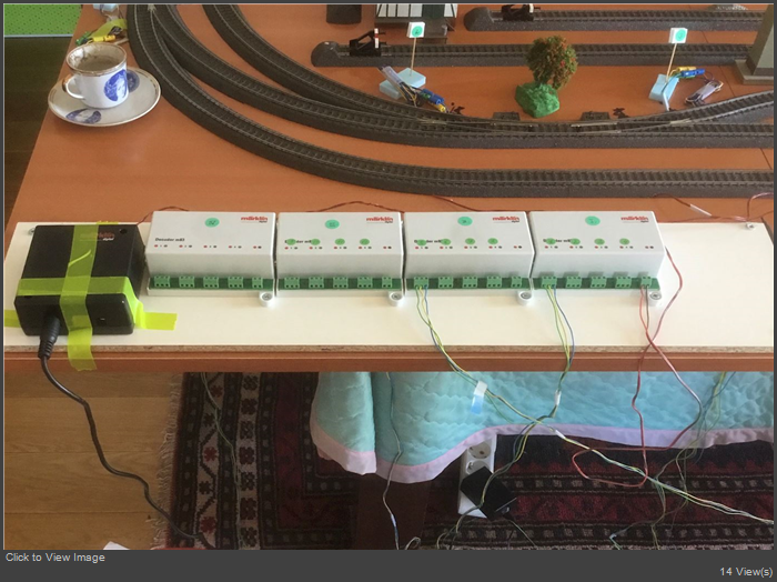

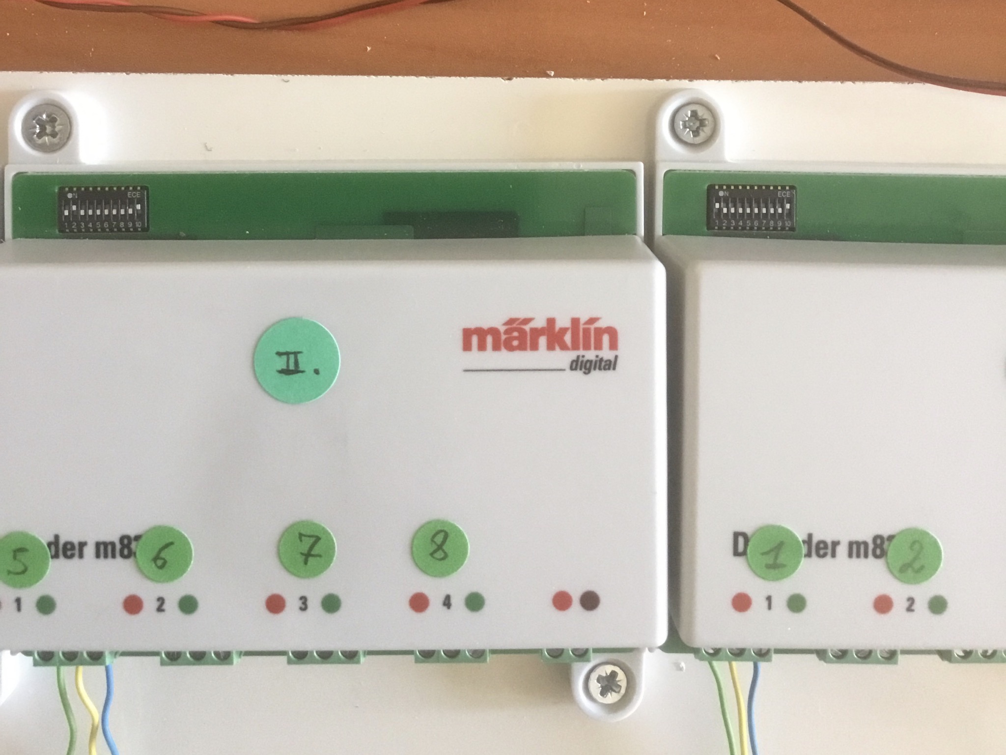

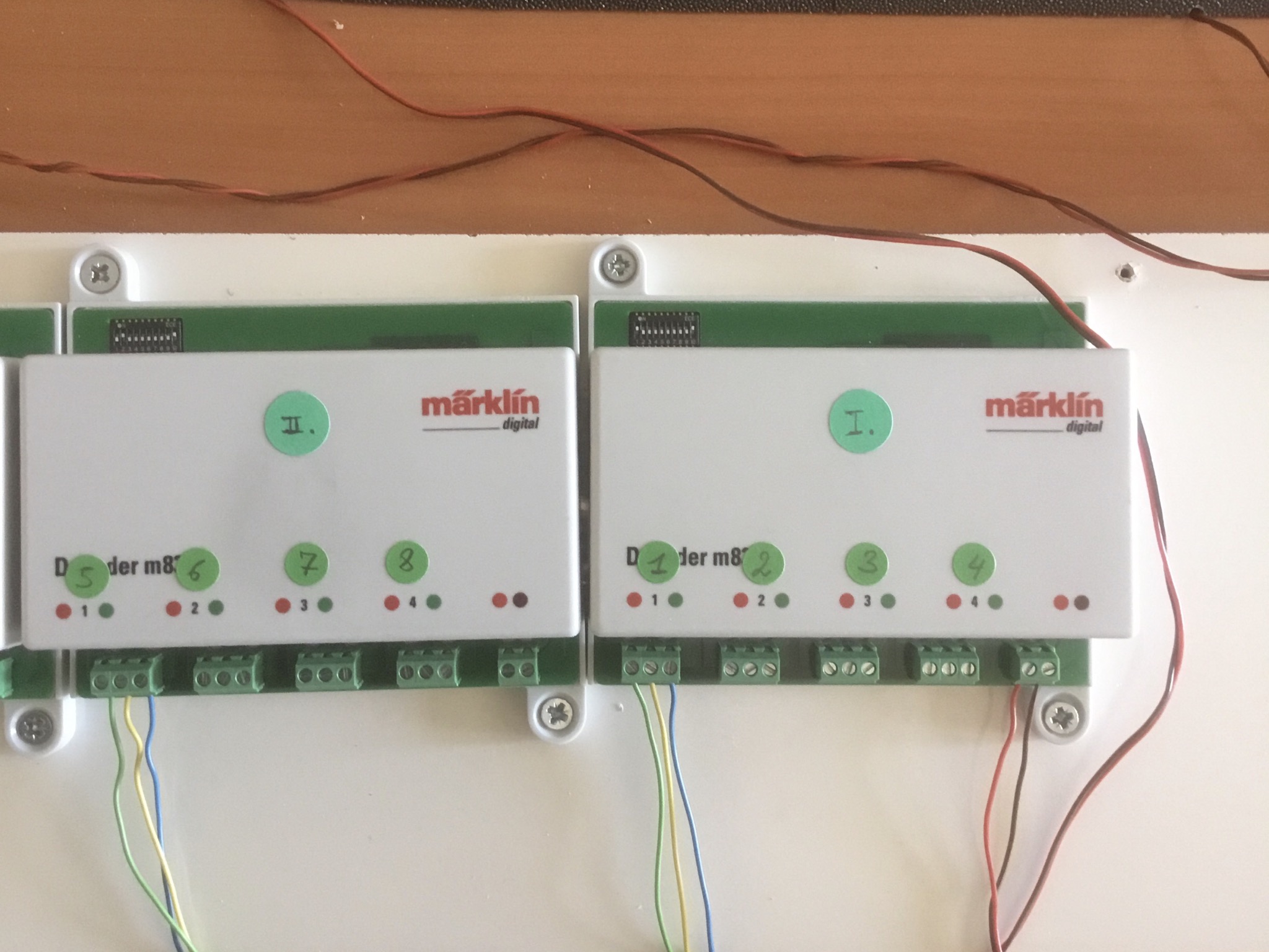

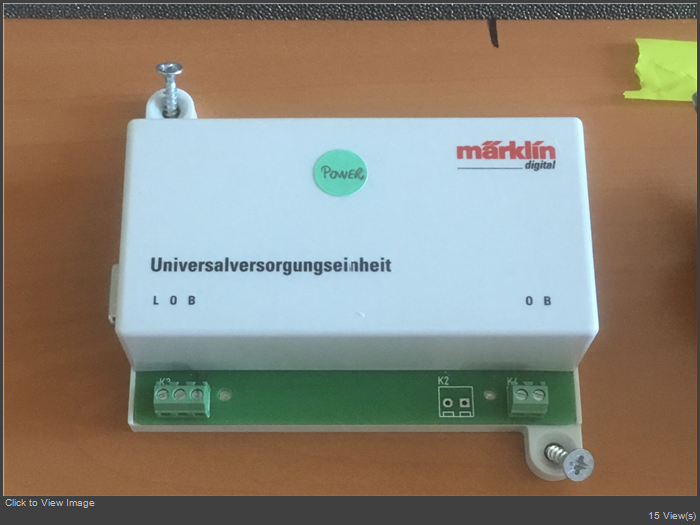

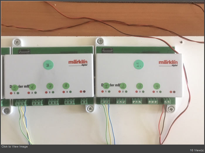

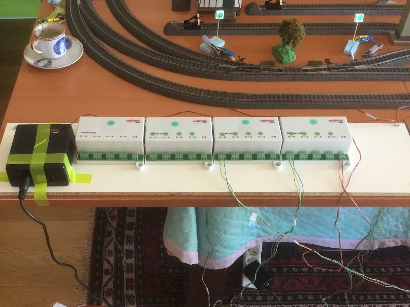

Offline Volkan
#7 Posted : 12 April 2020 11:11:48(UTC)
Volkan
Turkey
Joined: 09/08/2017(UTC)
Posts: 5
Location: Istanbul, Istanbul

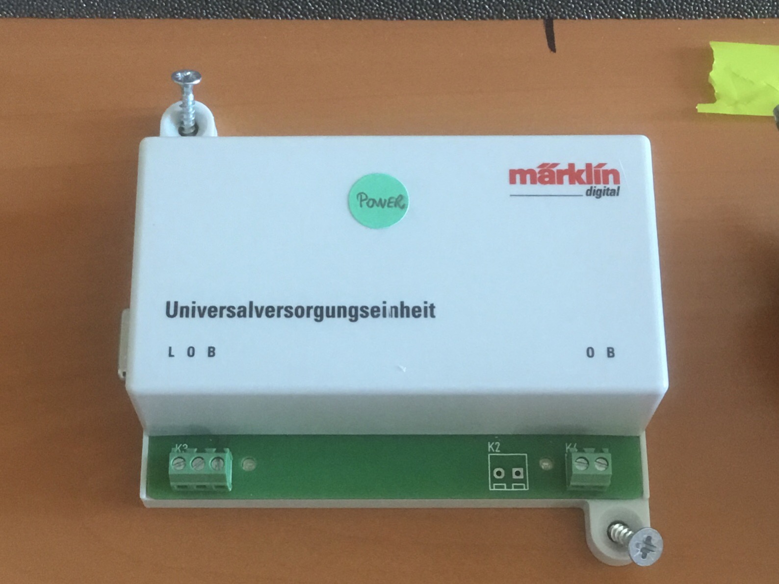

Hello TeeWolf. I have a same problem with M83 Decoders... I have a layout (an unprofessional one with 12 turnouts) I am trying to control them remotely with four M83 decoders attached to each other. At the beginning it was fine to operate the turnouts individually. (I used the dips switches) M83 - No1 for the first four turnouts, and m83 - No 2 for the turnouts between 5 to 8 and so on. But something happened and I am not sure if this is because of a stop signal I was adressing its CV. Now all the m83’s started To run in parallel. I mean when I make my no1 Turnout Green all m83’s no 1 switches do the same.. ? How can O make them run individually again?? Please help.. Cursing
E3F3A097-3A98-4F53-947E-12B28862B52E.jpeg49BDDA27-A974-41C7-814F-7861DF3AD054.jpeg851AD8F2-6853-4267-B6AF-EC4F134F2ADC.jpegE766DC41-3C2A-45F4-B73B-DB098D065168.jpeg
Offline TEEWolf
#8 Posted : 12 April 2020 23:57:11(UTC)
If it was functioning and now it has changed. It means to me you must have done something with your layout, which consuming more electricity as before. On the picture you show a power supply unit (UVE), but not its connection to a power supply, e.g. 66361. I also saw a track box. A track box provides a layout with 1,9 A maximum. It could be up to know the power supply for your layout was sufficient. But now you changed something at your layout? I do not know anything about it. Perhaps now you need more power. Have you tested, if 4 turnouts are working while the rest was disconnected? Then try it with 8 turnouts again. If it is functioning with 8 but not with 12 turnouts, think about an extra power supply for your UVE (Universalversorgungseinheit). Read your manual for the 60822.

Offline clapcott
#9 Posted : 13 April 2020 02:16:08(UTC)
clapcott
Joined: 12/12/2005(UTC)
Posts: 2,461
The m83 are able to have their address setup via the dip switches (the desirable way), however you may also update their address by writing to CV1 in base programming mode.
As you have your m83s set for DCC, this will happen any time you use a MS2 (or equivalent , that does not have a separate programming track) to set the address of a DCC locomotive. including a CV reset
To recover.
- power off - completely
- set the dip switches to ANY other address (don't care what as long as it is different)
- power on and wait a minute. (you may test with the new address if you feel inclined)
- power off
- set the DIP switches back to their proper setting
- power on.
The m83 will always check the switches on power on and will write their value if the address is different from last time
