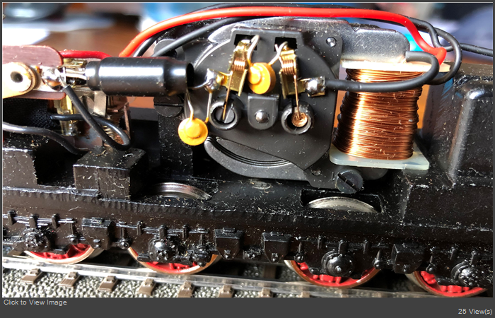

#13 Posted : 07 December 2019 10:46:44(UTC)
mbarreto
Joined: 18/02/2008(UTC)
Posts: 1,341

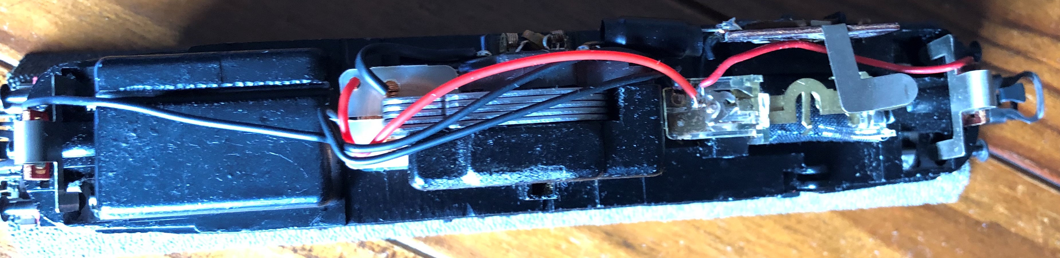

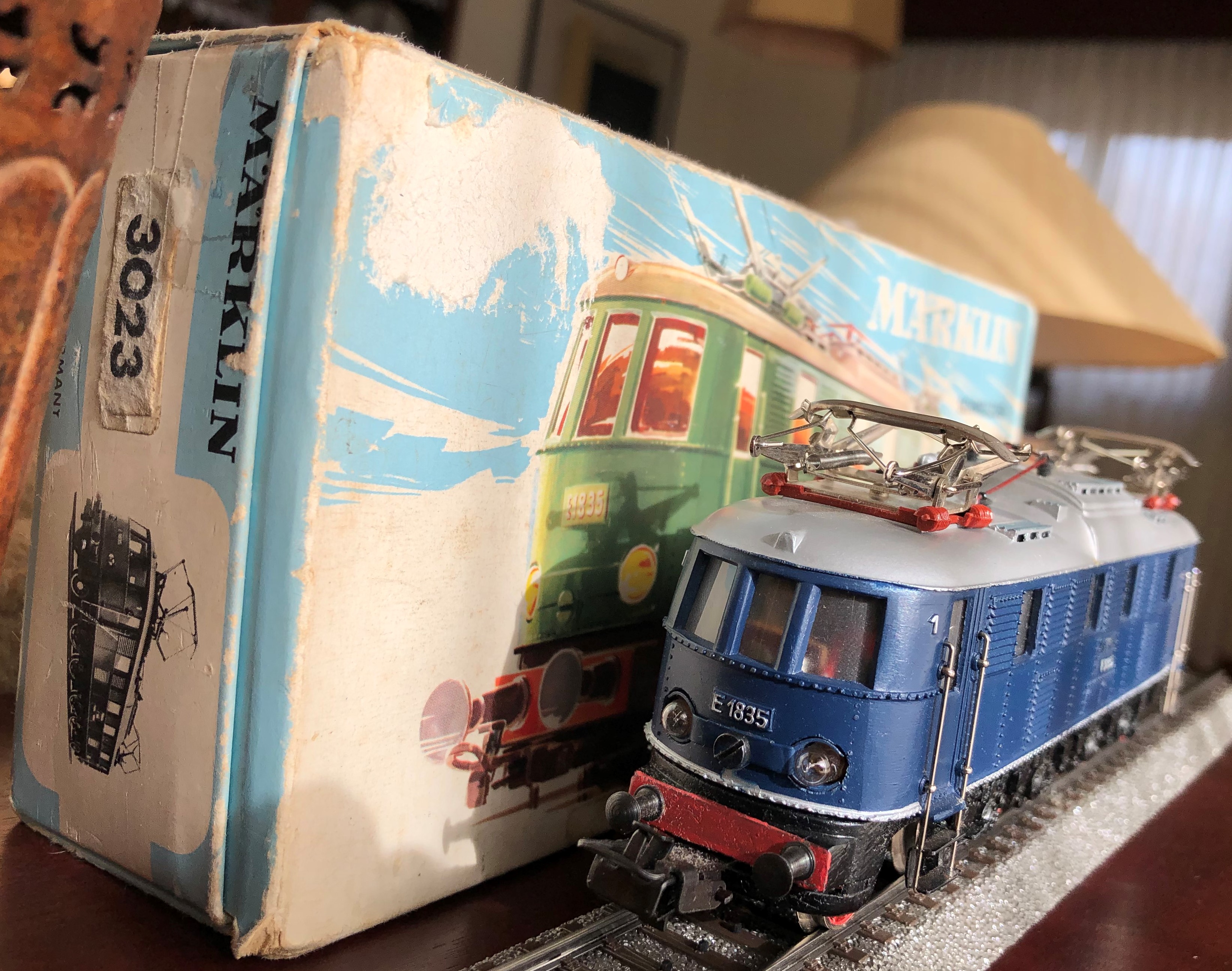

Below are the photos I took.
Although the locotive is fully functional the ride is not as smooth as I would like. It has a small amplitude trembling that sometimes almost disapears and seems to be more on the cogwheels end but I can't confirm this as 100% exact yet.
Although at first sight all seems normal it is like if one of the wheels is not completely perfect. I have to investigate further.
The last photo is the box identification. Is it from 1959? As the locomotive is a 3023.2 (it just has 1 lever for switch power from pantograph and it doesn't have a lever to reverse) it is from 1965 or a 3923 (not the earliest) and the box seems not to be original. Am I right?
Miguel
Miguel
Mostly Märklin H0.
Offline TrainIride
#14 Posted : 07 December 2019 12:51:19(UTC)
TrainIride
Joined: 23/10/2010(UTC)
Posts: 2,083
Location: FRANCE
Hi Miguel.
Congratulations for this lovely loco.
For sure the blue box is from march 1959.
For the loco, maybe you will never know, has it been repaired with newer parts, ....
If the ride is not as smooth as it must be,
maybe you will have to do some servicing;
oiling, don't forget the two foams of the motor
replacing brushes
cleaning dust everywhere
replacing traction tires - often creating trembling behavior when worn out.
By opening it carefully, you will discover more informations
to find the date of manufacture, considering the appearance of the electric parts.
I wish you a good investigation !
Best Regards
Joël

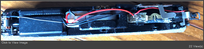

Offline mbarreto
#15 Posted : 07 December 2019 13:11:22(UTC)
mbarreto
Posts: 1,341
Hi Joël,

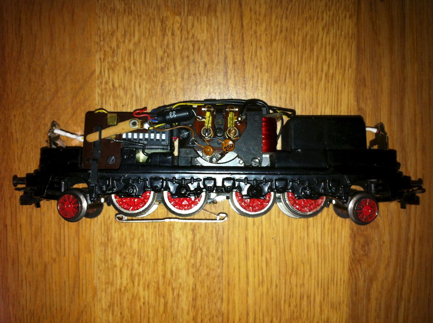

Thanks for your post and sugestions! I just opened it for a first inspection and i will order new tires at least.
I post some photos of the locomotive opened and it was not so hard to open it after read your post on the 3024 :) It is helping.
I also removed the driving axles and they look good. In general the motor, brushes and coils look good, but I need to find the trembling.
Miguel
Miguel
Mostly Märklin H0.
Offline TrainIride
#16 Posted : 07 December 2019 13:37:05(UTC)
TrainIride
Posts: 2,083
Location: FRANCE
your loco looks great and in very good condition !
As I can compare between my green 3024 from 1959, and my unboxed blue 3023 from I don't know when,
I can confirm the motor parts are the same as my blue 3023.
So, you have certainly a model from the 60's and above.
Good luck to resolve the "trembling" .
Best Regards
Joël

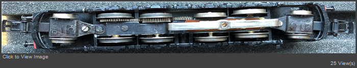

Hi there Miguel!
The "wobbling" is inherent to the design of the loco, and little if anything can be done to solve this little "cosmetic" defect!
You must have noticed that there is a lot of lateral "play" on all the axles of the loco, so even standing stil you can literally twist it left and right while on the track.
It is a little better when the powered axles are in front, but then the available traction is a little less.
However you'll notice that it will tend to improve as you add a good load of coaches behind the engine.
Still, despite all that, they are some of my favorites too! BigGrin

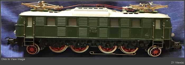

Hi Miguel,
you can watch hereafter the behaviour of my both 3023/3024:
you can see the 1959 3024 is a bit more shaky.
Considering the "wobbling" phenomenon and all it possible causes,
I have just finish the tests on my brand "new" 1964 3022 E94 and discovered
after full servicing, the loco was still trembling a bit, depending the speed.
For me, it is because one of the front wheel of the motor bogie is lightly twisted.Blink
The only solution for me is to replace carefully this axle, with special tools...
Joël

#26 Posted : 02 May 2020 15:08:54(UTC)
Posts: 3,692
For the fun I attach pictures of my 3024 (green) which I suspect is from 1959 but has been digitalized
Note the brush holder is still in cast metal/insulation plate.
Outside
Inside
I confirm the loco's riding is not very stable with a very high center of gravity
