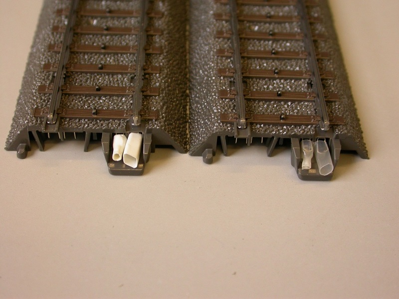

If you cannot find some in a hurry you can use thin plastic sleeving. I have used heat shrink tube before now.
The picture shows some (gently) shrunk and unshrunk HS sleeving on track pieces. Gently shrinking the sleeve makes it easier to mate the next track piece.

#8 Posted : 29 November 2019 04:23:19(UTC)
The heatshrink isn't a bad idea. The Marklin insulators to be honest are rubbish, they get pushed down into the opposing track piece by the by the 'sprongs' (for want of a better word) that Alan shows as being heatshrunk in his picture.
I have been cutting the inside sprong off (which is the centre pukos sprong) to make sure - I cringe every time I do it - there must be a better way!
I have experimented with putting a cut down insulator in behind the main one to stop it being pushed back. That seems to work OK, but means you use two insulators.
