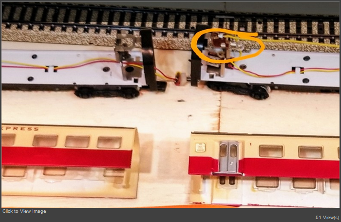

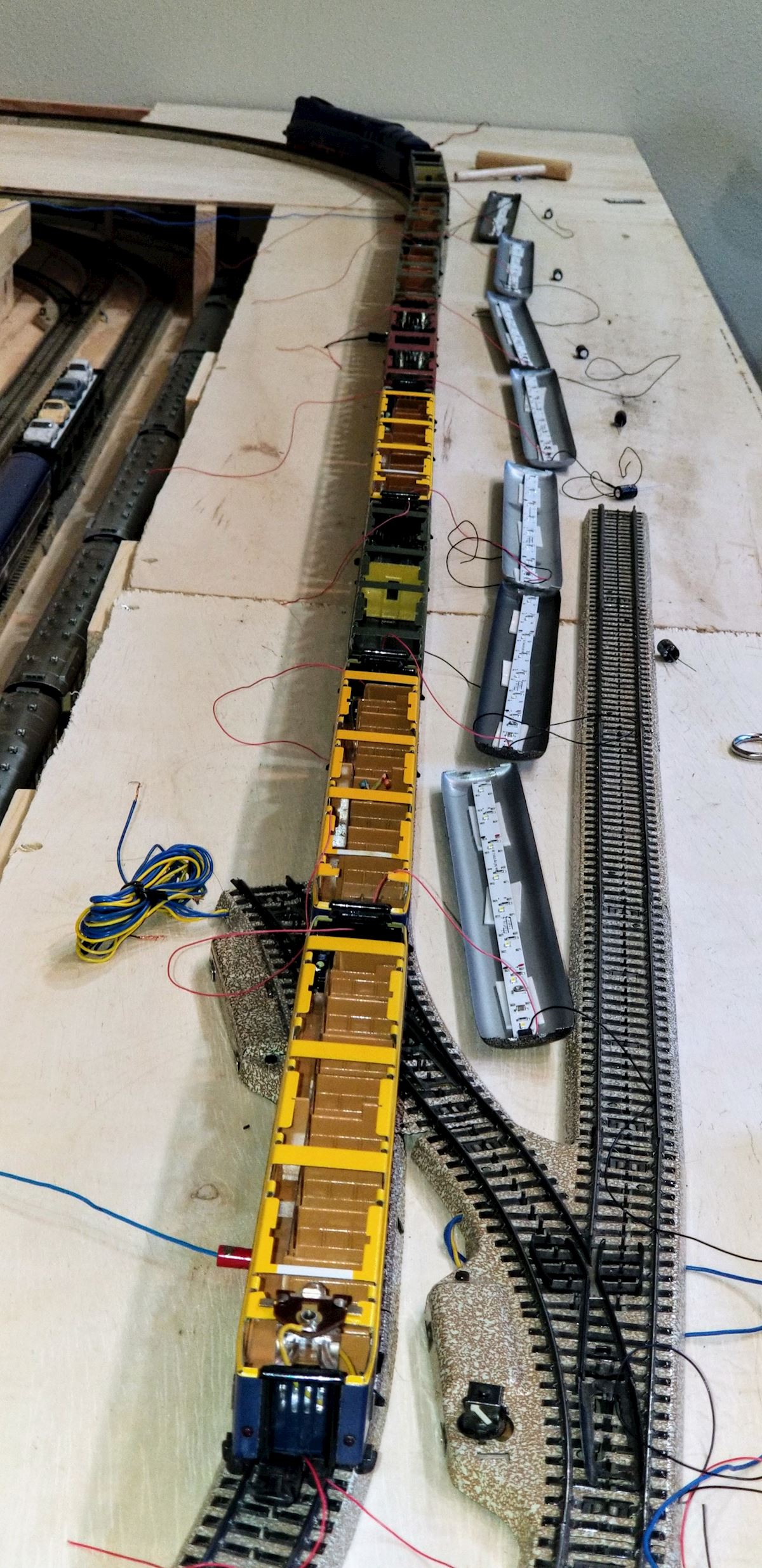

I'm finding that installing interior passenger wagon lighting is tricky business.

#13 Posted : 12 July 2019 05:09:20(UTC)
Posts: 14,916
it can be especially when you use bulbs and not leds, the power consumption could be quite high, my solution is for trains (not to be seperated) to use 4 pin electrical couplings and therefore use the loco decoder for all the interior lights in coaches.
Only the TEE train in that photo is using incandescent bulbs. All the other trains in that photo have LED lighting boards with either white, soft white, or yellow LEDs. My trains are old and don't have electrical contact couplers so running power conductors through the train to reduce the number of wagons with pickup shoes was the tricky part.

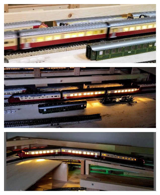

This somewhat shows the difference between LED and incandescent interior lighting inside the TEE RAm.
The top photo shows the TEE RAm with LED lighting boards and the bottom photo shows the vintage incandescent interior lighting system. The LED intensity is adjustable. I have the intensity turned up to about 90% of the adjustable range. The incandescent bulbs appear brighter in the photo than they actually are.

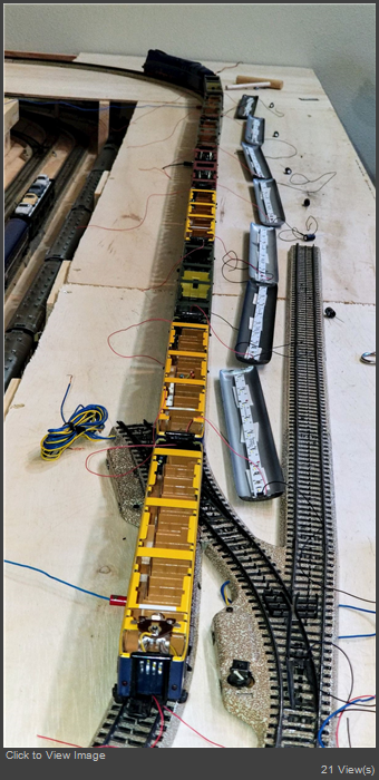

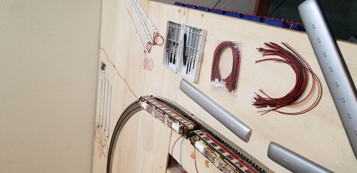

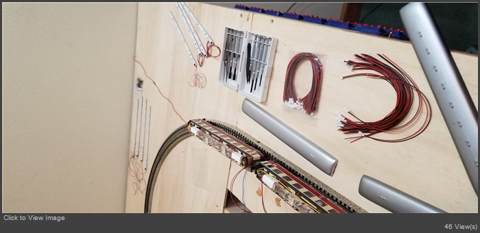

Fleet wide interior lighting project continues.

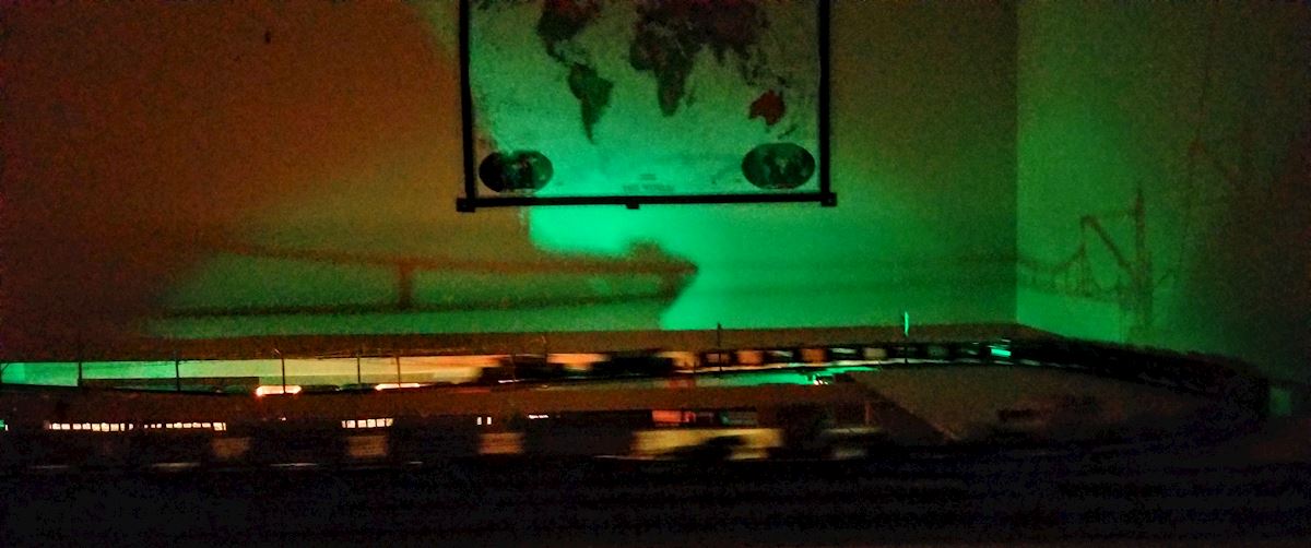

Posts: 409
Location: Hailey, Idaho

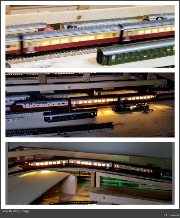

It's time to enjoy the colorful visions of the fleet wide lighting project.
