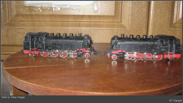

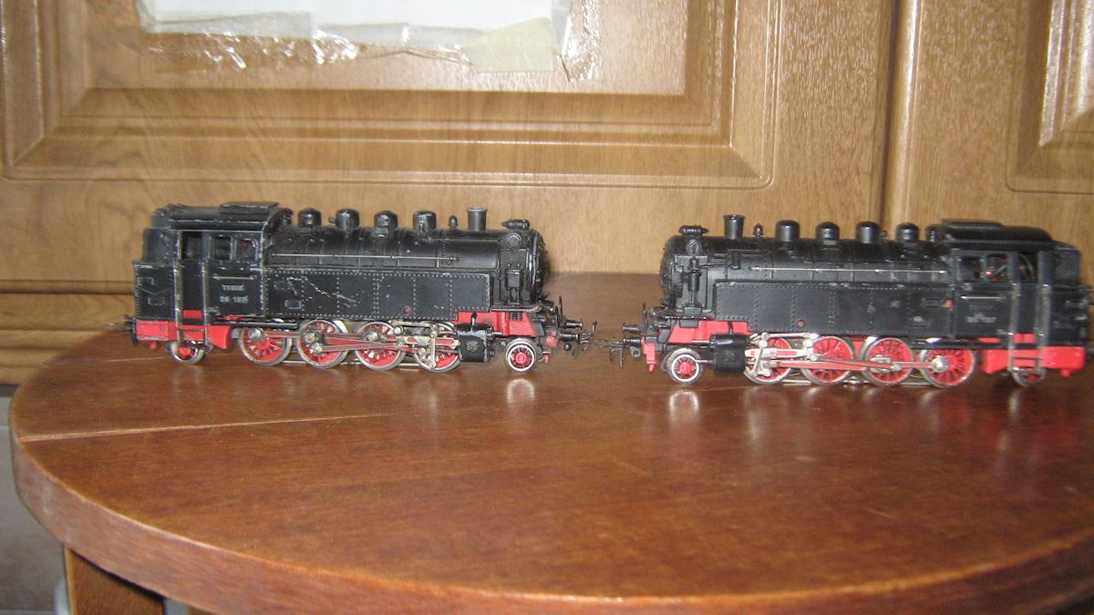

Hi, I have 2 tt 800 steam locos but cant tell which versions they are. They both have clear traction tires but one has a single hole on each side and the other one has two holes on each side.As far as I can tell thats the only difference. My Kolls book shows a version 4 one which has one hole so what version is other one with two holes in each side. Regards Eddie

Eddie - According to my Koll's (2018) the only difference between Version 3 (1953) and Version 4 (1954-1956) is that the latter had traction tires. If both of your TT800's have "Haftreifen" (rubber traction tires), but have other chassis differences between the two then perhaps Version 4 had additional undocumented variations? Could you please share some pictures demonstrating the differences? Neither of my TT800's (V2 and V4) have two holes on the sides. Each has only one.

This picture is not very good but you can see the second hole close to the cabIMG_0923.JPG

The loco in post 4 "How to clean a TT800 " shows the two holes I was talking about
