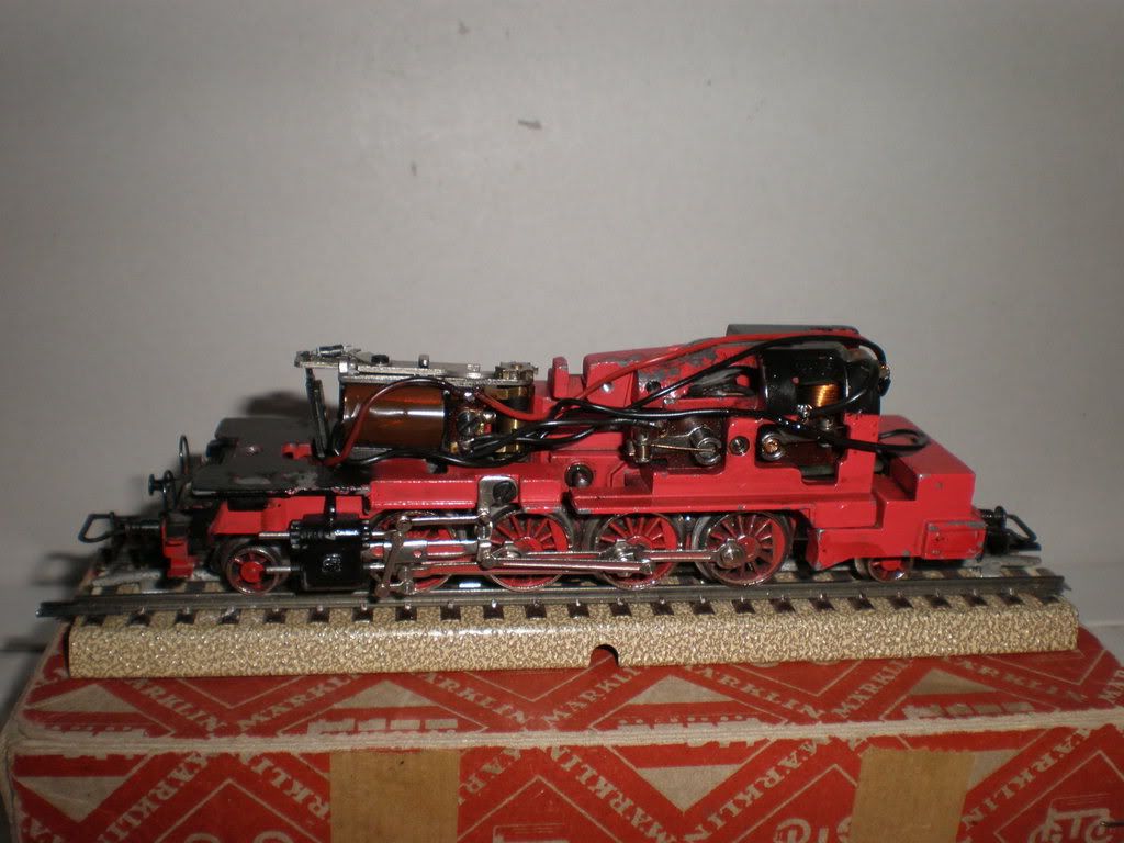

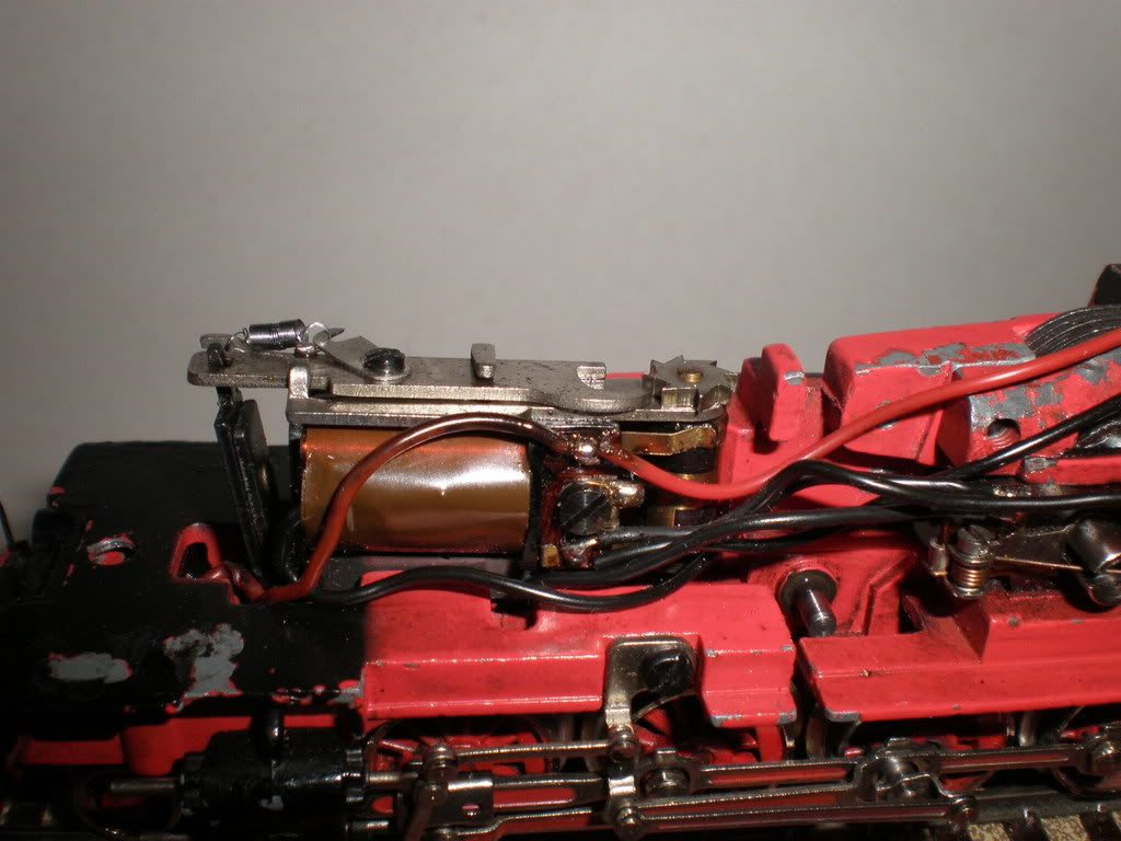

Yesterday I were visiting one of my favorite Märklin dealers. They got the whole basement filled up with old and used Märklin. "Unfortunately" (if you look at the price) I felt in love with a near mint TT 800 with the original box.
My question is then: how do I clean the gears and rods without damaging the paint, and how do I clean the shell? Normally I use benzine to clean the gears and remove oily dirt, but i don´t want to make experiments with the wheels and rods on this expensive loco. So if some of you have a good cleaning-tip, I would like to know.
Picture:
(I can post more pictures of the loco later today or tomorrow, if want me to do it.)
Thank you for reading.

Why not use normal Q-Tips to remove the dirt confused
If the dirt is sitting really hard use some Zalo or alike on the Q-Tips wink

Many thanks for the tip Pål. It worked. I just wanted to make sure, that I could use something, that not would damaging the paint.
Here are some before/after pictures:
Later today, when the loco is up and running, I'll post some more pictures.

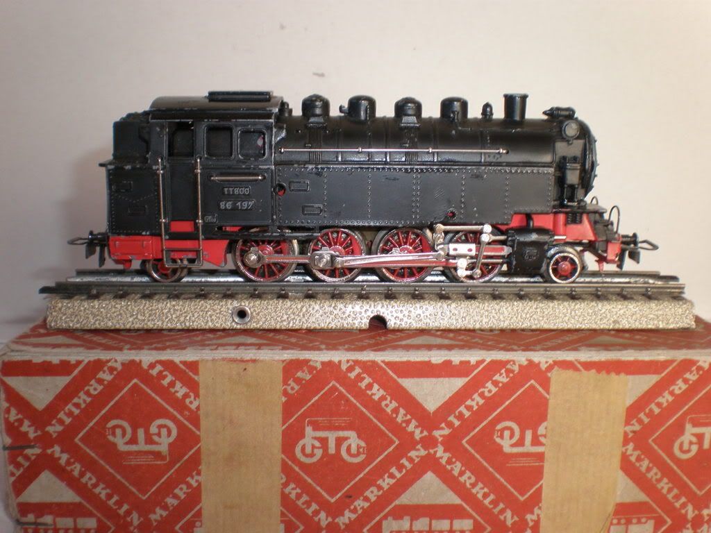

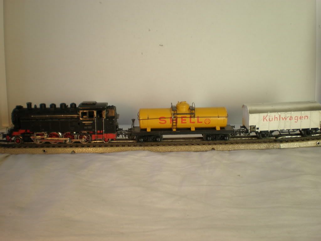

Here are some pictures:
Together with two of my "Ganzmetallwagens", 334.3 shell and 324.4.
The TT 800 is a very strong engine with a very low gearing. I've tried it on a little oval lay-out, and it pulls many wagons without driving slower. But it's funny, nothing seems to beat my passenger loco SK 800 in pulling-power, not even locos like the TT 800 which is made for pulling a lot of freight cars.
Thor

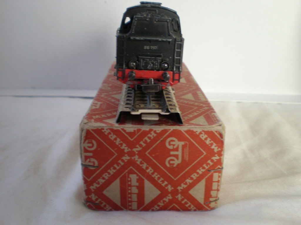

Thanks for the pictures. Congratulations with a fine engine. It looks really heavy duty. I understand you "fell" for that. I did not know that a TT 800 is also a BR 86. I love tanklocos myself. I have a couple of 85/86's.
However looking at picture 2 and 3 the body seems to be tilting to the side with respect to the wheels and track. Are you sure it is assembled correctly? [:I]

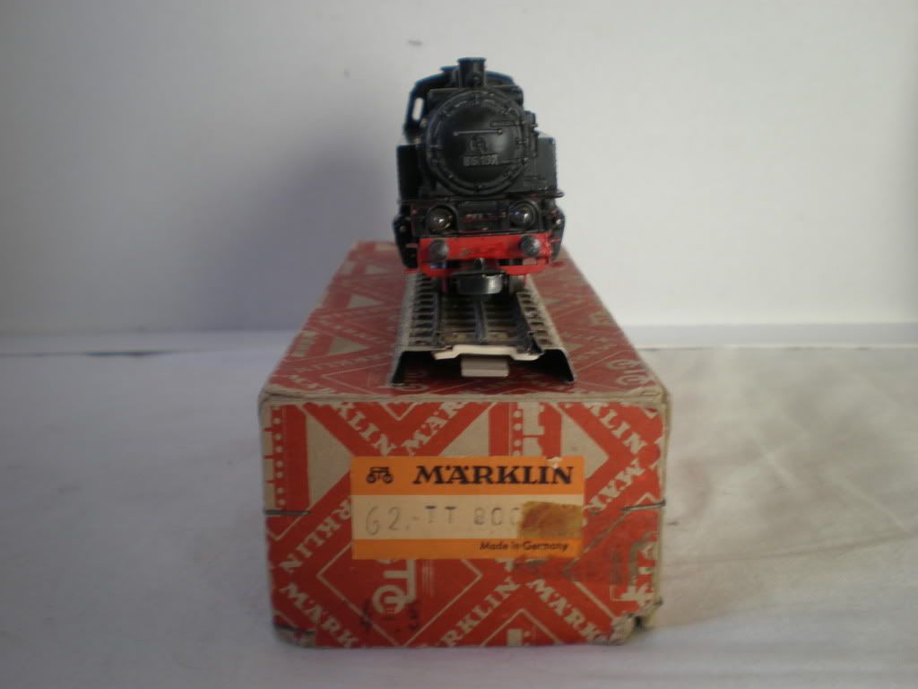

Location: Denmark
Oh - them good ol'days.
Look at picture 2. The "62,-" written on the label to the left of "TT 800" is probably Danish currency (that would compare to appr. 8,50 EUR)!

After you wrote about the tilting on picture 2 and 3, I looked at the loco, and it was just fine. The reason why the loco is tilting, is that the track is very used and the box isn't horizontal.
A god guess, but it is west German d-marks.
The picture above is from 1953 from the Märklin "Haubtkatalog". My TT 800 is the last version made (54-56). It's funny to see, that the SK 800 almost had the same price as the TT 800.

I normally use a dish washing soap and an old toothbrush when I clean locomotives.
After the cleaning I rinse with as warm water as I can handle.
Offline Renato

#19 Posted : 11 October 2008 08:08:39(UTC)
seatrains
Joined: 22/11/2006(UTC)
Posts: 676
Location: Shoreline, WA
I agree with you. I use warm soap & water, but I am gentle and I always test a small area on the outside. For the under the body shell, I have been more aggressive using a toothbrush. I have also have had good results (again testing a small area) polishing very gently the shell and wheels, with the cotton buffing wheel on my dremel.

I've had considerable success with those ultrasonic cleaners for old chassis - just put them in with warm water and a squirt of washing up liquid and run the timer. It works well on bodyshells too, but make sure that the painted segments aren't touching the inside (stand it upright on the base of the tank in the middle) as it could scratch them slightly if the ultrasonic vibrations move the part against the base or sides.
It worked very well on an old Hornby Dublo loco of similar vintage to this, cleaning all the crud of fifty years of carpetbahns out without needing me to dismantle the chassis. I then simply rinsed with plain water, left it in the airing cupboard to dry, and re-oiled. It runs very smoothly on the test stand and just needs proper track for some exercise.
