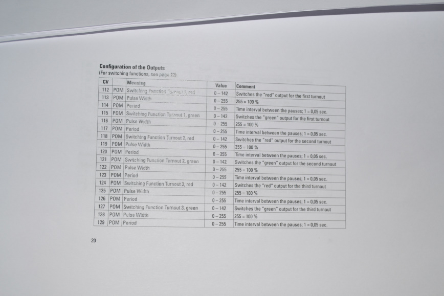

I am not sure how to fix it.
m83 stand in the DCC mode because the manual of the 60821 says DCC mode.
What is the next step?
In the picture of the CS3 i did set first output 1 but then?
I want to test by use tortoise motor to switch.

The first thing I see is the "Period" which according to the manual should be between 50 and 200,
and in your picture you have the value 4 ?
I'm also quite sure you should have another number than "0" in "Koblingsgruppe"
I don't have these items myself.

It´s standard set by of Märklin.
I have not yet changed the value because not sure which is correct.
The first stand dimmer...the second period...the third a group.
In the manual of the 60821 in page 4 it stand:
Switching function turnout red= value 17
Pulse width (regulating speed)= value 1-255
Period (regulating time)= value 50-200
Repeat the green output too with same value.
I suppose it´s to follow in correct step?

Yes; but Märklin don't know what you want to do, that's why they write in the manuals what you should do.
I think a good start would be to use the values Märklin write in the manuals. Cool
First thing is to assign an address to your M83 and to have it working, then you can connect your 60821
and set the corresponding CVs to the correct values for your motor controller.
Your Tortoise can be driven without a 60821, and is probably not the best for a test of the 60821.
I offer the following as one possible solution.
Assumptions
- CS3
- m83.2 = 60832 starting with factory defaults
Objective
- set the m83.2 to 8 port switch mode ( to provide direct control over the individual Green and Red ports of a port pair)
- use CS3 events to achieve "one button" behaviour to turn a port on and off
Overview.
The 60821 provides polorised power (voltage) when
- The Red port is ON AND the Green port is OFF (one direction)
- The Red port is OFF AND the Green port is ON (the other direction)
Should both ports be in the same state there is no drive power in either direction.
Steps
1a) Set the m83.2 to 8 port switched mode
1b) configure the ports as desired with useful names
2) define a random worker Turnout address (does not have to actually exist - I use address 2001)
3) Define 2 x Events
3a) 1 to trigger when the proxy signal goes Red to set the m83 Green port OFF and the Red port ON
3b) 1 to trigger when the proxy signal goes Green to set the m83 Red port OFF and the Green port ON
Screenshots
1a)
1b) My example of naming for use in phase 3
3a/b)
Comments:
While a Tortise motor will tolerate 16V, I would recomment stepping down the effective voltage. by inserting a pair (or 2) LEDs in series. as per the totise manual.
(dont bother micromanaging the Output settings of the m83)

Anybody who knows what the symbol Dr. means?
The Dr. is an abbreviation for Daueraktivierung
The checkbox is used to configure the port to "pulse only" - as long as the finger is pressed on the button (unchecked) or "permanent/continuous" (checked)

I pointed out that you were using the wrong CVs and that you should use the CVs written in the manual.
I also told you that the Tortoise was not good for testing.
