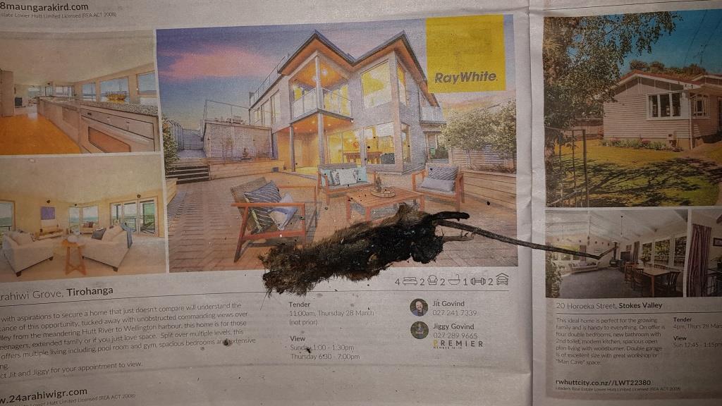

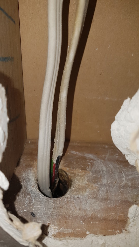

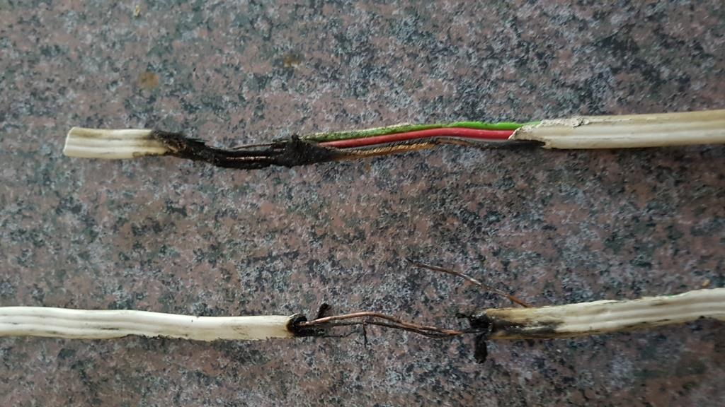

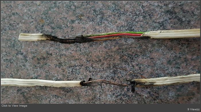

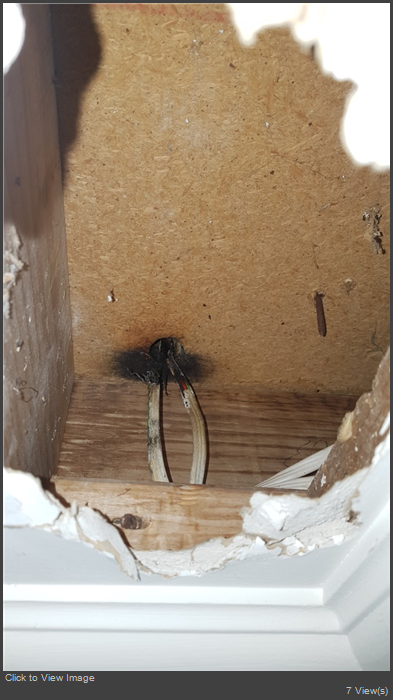

Not only have I had trouble with K83's cooking, I've had some other bits of 'cooking' fun.
In my house I have lights in the hallway and up the stairs, with 4 light switches at various points, any one of which can switch the lights on and off. Several weeks ago the lights came on all by themselves about 2am in the morning. I was able to get a switch combination whereby the lights were off, so I went back to bed. The last few days things got to the point where I couldn't turn the lights off at all, the only way was to throw the circuit breaker.
Today, one of our club members who is an electrician came up to have a look. He tested all the switches and they all seemed OK - he actually replaced a couple but there was no difference. At one point he got the switch combinations such that the lights started to flicker real bad and almost went out. That was accompanied with an electrical burning smell.
Short story is that after whacking a few holes in the walls and ceiling we found what had happened. A mouse had got into the wall cavity through some vent holes drilled in the upstairs gas water heating cupboard floor and proceeded to munch on the wires. Looks like it had stripped one of them bare of insulation and the other was quite far gone, which accounts for the burning smell. Once we whacked the holes in the ceiling I could see an electrical flash when we put the power on.
View from below. The mouse was hanging out of the hole on the right side.
Cooked mouse!
Wall upstairs above the hole where the mouse was. We are going to have to trace where the wires go and run new replacement ones. The badly burnt one is hanging on by one wire only.

Have caught 5 of the beggars in traps this year already, this one makes 6.
Last year it was about 20 I caught - they come up when it's cold from the bush that's down below the houses across the road. There are cats around, but mine died about 3 years ago so maybe that's why there's so many.
As electrician I've seen this quite often. Cool
The reason is that the mouse wants to go true the hole, probably due to a "nice smell" on the other side.
Removing the plastic is easier than removing the material in which the hole was made, not that mice likes plastic.
A very easy solution is to close the hole using expandable PU foam, it will block the hole well enough to prevent the mice from
smelling what's on the other side, and even though the mice easily could chew through the foam, they never attempt to do so.
I was quite surprised how well this works when I was living in the countryside and tried this myself, having mice in the house,
every night trying to expand tiny screw-holes in the back of my kitchen cupboards to get to the food.
