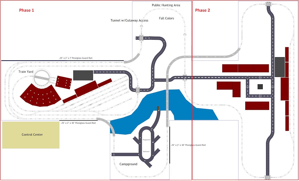

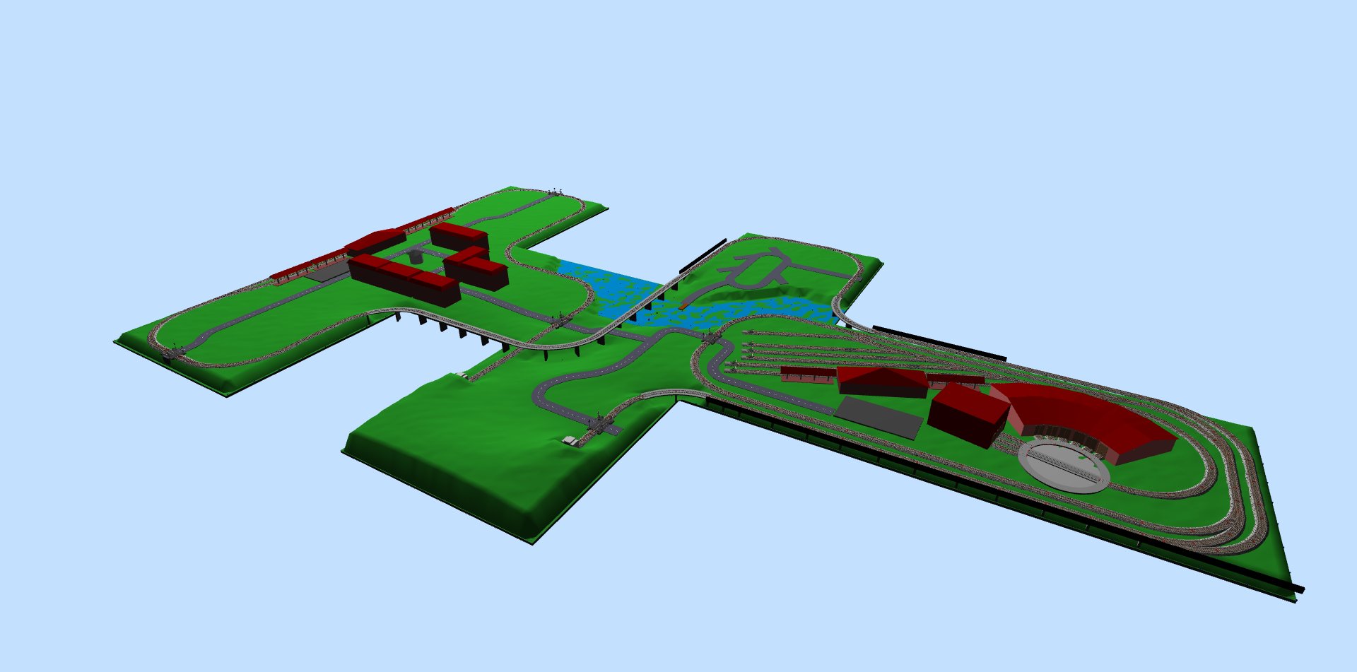

As for my layout, attached are a few pics of the layout I've been working on using SCARM. It's influenced by the Tyco H0 layout my father and I setup over 40 years ago, my love of the outdoors, and the public square here in Medina, Ohio. I also work with computers for a living so the CS3+ is something I'm really looking forward to using and integrating into my home network.
In the 2D picture below, phase 1 is to the left. I'll be adding the new C Track Turntable and Roundhouse when they are available later this year to finish off Phase 1. Phase 3 will be sometime later next year. Taking it slow so I can learn as much as I can before diving in.
Thanks again everyone!

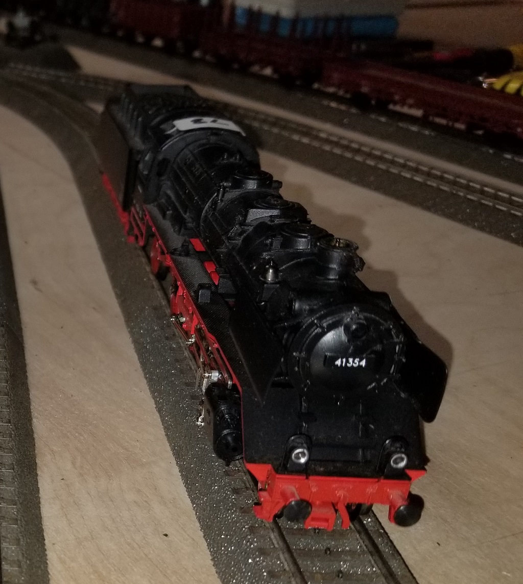

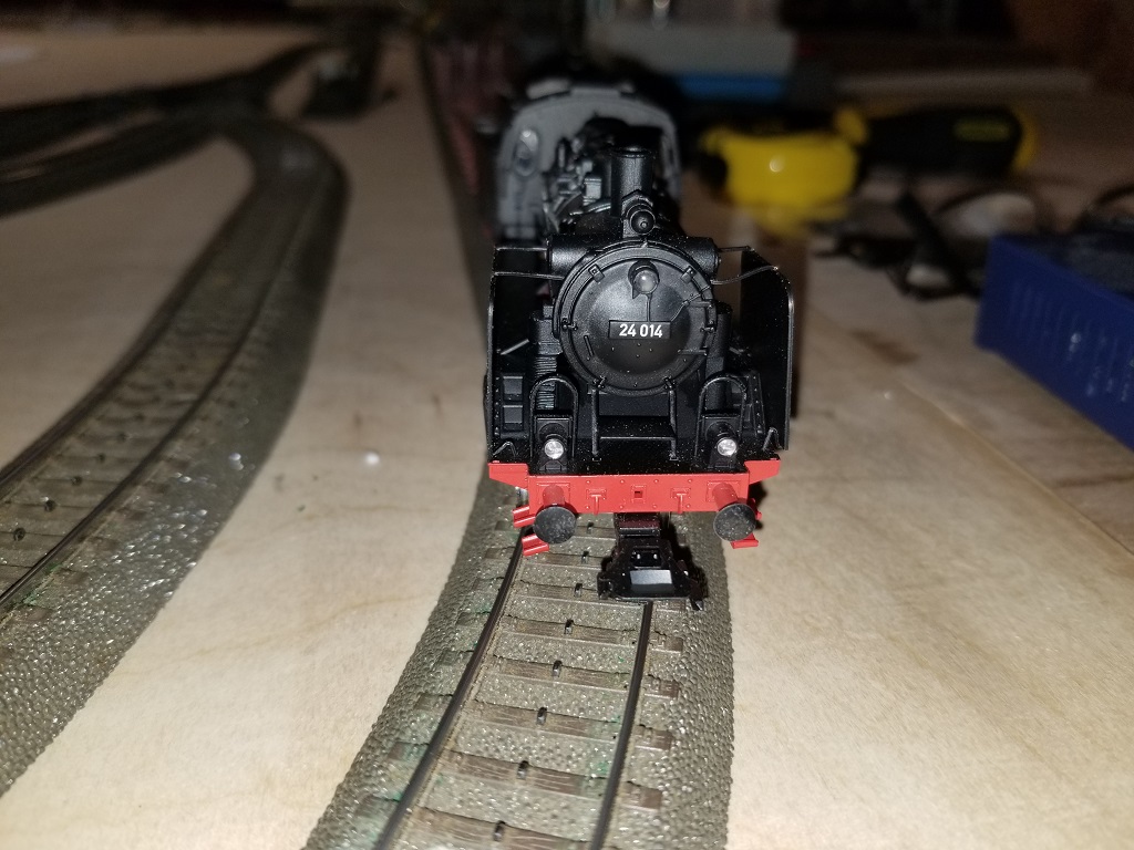

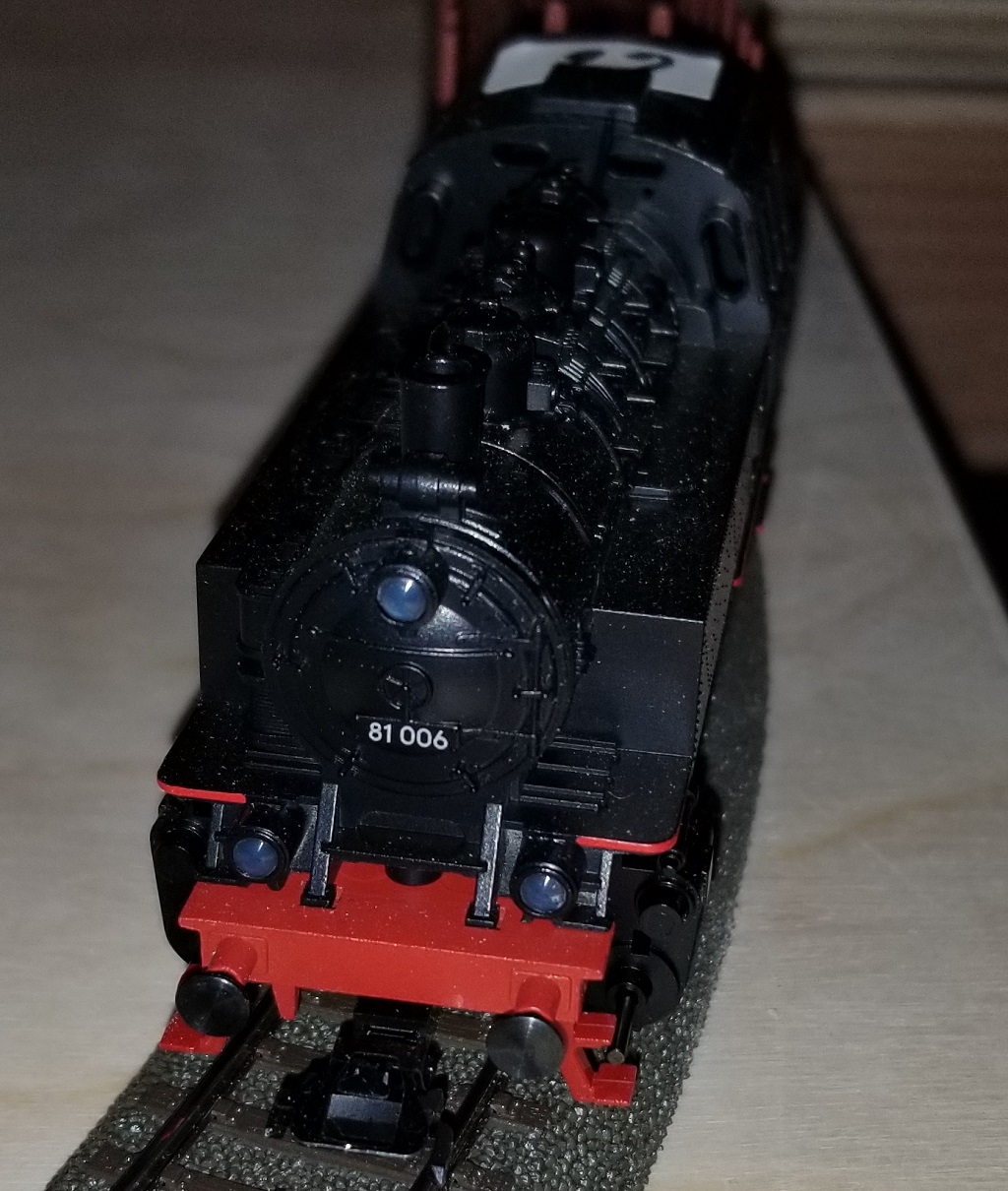

After considering all the feedback, I've decided on a hybrid approach to upgrading my steam locomotives with sound...
  • Since the BR 38 DB (038 382-8) and BR 81 DB (81 0006) do not support smoke generators, I've decided not to upgrade them
  • Instead I've decided to purchase the #39034 BR 18.5 DB (18 505) which is the sister of the BR 18.5 DB (18 527) locomotive that came with my 26928 - "1928 Rheingold" set
  • I'll be upgrading my (2) BR 24 DB (24 014) locomotives with mSD3 SoundDecoder's (60975) and Smoke Generator Kit's (72270)
  • Lastly, I'll be upgrading my BR 41 DB (41 354) locomotive with a High Efficiency Propulsion Engine (60941), mSD3 SoundDecoder (60975), and Smoke Generator Kit (7226)
Thanks again everyone for your feedback and guidance, I sincerely appreciate it. I'll report back to this post once the upgrades are completed.

You can convert the BR 81 with smoke and mSD3 decoder
There is how I converted mine, but with mLD3 (60972) decoder without sound
https://www.marklin-user...BR-81-Digital-Conversion
The conversion with sound is exactly the same and there is possible to put a small speaker into the loco
This loco as digital and TELEX is an excellent switcher

The BR 81 I have is from starter set 29322 - https://www.maerklin.de/...ts/details/article/29322
I believe this is locomotive 36321 - https://www.maerklin.de/...ts/details/article/36321. The manual for this BR 81 does not indicate that a smoke generator can be added.
I didn't realize you could still add one, I'm still learning something new everyday. Crying I'll definitely keep this in mind as I start my upgrades.
Thanks again!
JJ

This loco is the last version of BR 81, which is quite different from the older ones.
Has a DC motor and a basic decoder.
The frame is different.
I haven't any experience with those. I have never touch one of those.
Looks from the plans that for the installation of a smoke unit many alterations are needed.
So is better to live as it is.....
Sometimes the effort and the cost are not justified.
Costas
Thanks again!
JJ
Caution JJ. The BR 81 (29322) has a fx decoder, whereas the BR 81 (36321) has a mfx decoder on board. You see it under features on Märklins website. The motors shall be the same.
Costas
Thank you Costas!!
