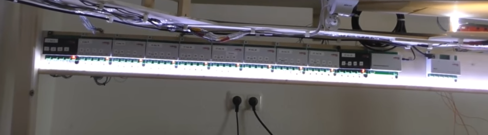

#5 Posted : 19 February 2019 21:26:59(UTC)
Posts: 2,323
A recommendation by a dealer to a YouTuber was every 3 or so may be best served with its own power supply to ensure reliable operation in all cases, though one could string a lot of them together. The following string was recommended against.
Seen in this YouTube video at 16:42
Offline clapcott
#6 Posted : 20 February 2019 00:27:02(UTC)
clapcott
Joined: 12/12/2005(UTC)
Posts: 2,461
The recommendation should come with some qualification.
Connecting multiple k83 & k84s by daisy chaining the brown/red is little different from m83 in basic mode (just pulsing a port one at a time)
Historically 10s of k83s/k84s have been used without an external power supply from a controller WITH trains running on the same circuit.
In basic mode , the main issue I would have with the picture is the amount of cabling from the ports to their devices.
IF you have m84s then these do not use latching relays and therefore require constant power
IF the m83s are being used in non-basic mode, with ports "on" all the time then you need to sum up the power requirements
Worst case, a single m83 with 8 ports "on" drawing an allowed 200mA each will consume 1.6A, when the 6636x is only rated at 2A (36VA @ 18V)
In summary do the math, based on your own configuration AND expected usage.
Offline Thewolf
#7 Posted : 20 February 2019 15:23:23(UTC)
Thewolf
Joined: 08/09/2015(UTC)
Posts: 2,099
Location: Cowansville, QC
Hello Peter thank for your replyCool
I suspected that there was something in the kind of your comment... That's why I decided to make a special connection to the M84s and a second to the M83s....in short, to separate them
