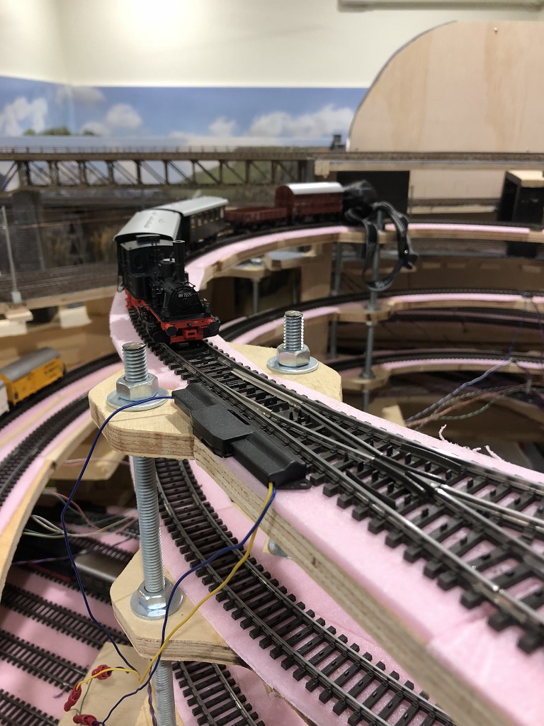

So I ran into a problem with my Marklin BR89.7 (T3) getting stuck on a turnout with slight elevation. I suspect my Glaskasten will have the same problem.
With testing I have found the T3 can only pull 2 thunderboxes before losing all traction and I need it to pull 4 wagons.
The cause of the traction problem was rather straight forward - the model only has 1 traction tire which is on the side of the turnout blade.
Since the turnout blade tapers off (it is not full height of the rails) then the traction tire loses its contact.
Frustrating, this model has 3 axles and could have used 2 traction tires - and indeed the Marklin description incorrectly states this: ' 3 axles powered. Traction tires. '
I have read on Stummis about T3 traction problems and their solutions.
https://translate.google...t%3D8402&prev=search
https://translate.google...%3D25455&prev=search
For my situation, I have these options:
1) exclude this locomotive from using the route with the switch at turnout, since set straight there is no problem (since the traction tyre is touching the outer rail and not a blade)
2) source the 'C' axle as a spare part and install it on either the B or A axles so that it has 2 traction tyres.
3) machine the 'C' axle opposite wheel to provide a groove and install a second traction tyre
Option 1 is not ideal. Option 2 I think is not possible as no one has the spare part (Treibradsatz Achse C 229 418) in stock
This leave Option 3 as being the best choice at the moment depending on a machine shop and price.
Stummis also spoke about some tweaks (reduce slider force, add weight, add tape) but I doubt these changes will improve traction enough.
Though I wonder if anyone has machined a wheel to add a traction tyre before?

I did some testing last night to determine whether the power drops with these locos on my K track switch was pickup or earth.
I was slightly surprised but yet again the problem turned out to be the pickup shoe contact, rather than the wheel earth (despite not having many wheels)
In fact the problem turned out to be similar to what I posted here:
https://www.marklin-user...it-on-slender-K-switches
Except that instead of short circuiting, it was just not making adequate contact on the DKW at the mid way point because of the hole.
edit: found the schliefer spare part and found straight away stummis have also experienced this problem:
https://www.stummiforum.de/viewtopic.php?t=78366
