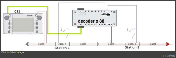

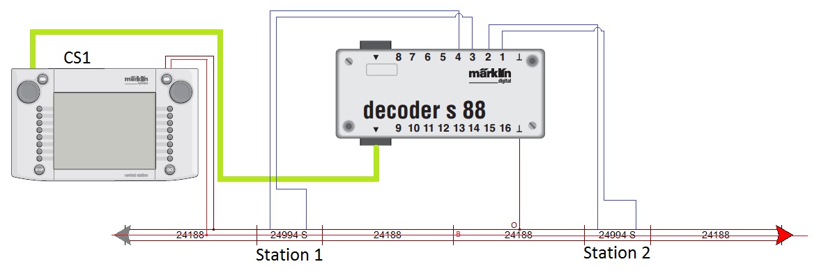

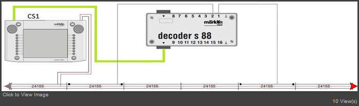

Hello, I want to do the same kind of shuttle train but for the past week I have tried and tried and didn't work.
I have a CS1 mit Update, two 24994 C Track and S88 (6088).
The wiring is as follows:
I have tried all possible combinations (even illogical ones... :( ) I.E
Modul 1-Port 1/Modul 1-Port 2
Modul 1-Port 1/Modul 1-Port 3
Modul 1-Port 1/Modul 1-Port 4
Modul 1-Port 2/Modul 1-Port 3
and so on...
But nothing works. I am running out of ideas... what am I doing wrong?...
I don't know this guy's secret (except that he is using a Viessmann S88 decoder) but the same wiring seems to work for him...
#4 Posted : 09 November 2018 23:30:50(UTC)
Posts: 7,464
All you need is a single wire from the contact track to the S88. One end to port 1 and the other to port two. Then go to the shuttle on the CS2 and enter port one and port two leaving the middle stop at zero.
The instructions with the contact track show how to wire it for the correct direction of travel.

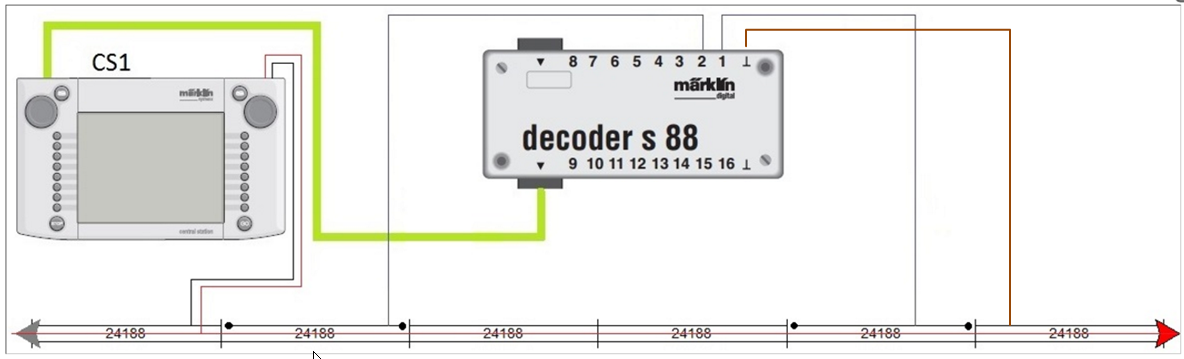

#5 Posted : 09 November 2018 23:45:49(UTC)
Mmagda
Joined: 03/11/2018(UTC)
Posts: 41
Location: Brandenburg, Potsdam
You mean something like this?
And what do you mean by
Then go to the shuttle on the CS2 and enter port one and port two leaving the middle stop at zero..
All I see is this:
Thank you!
L.E. I've just tried it. It's not working. seems like the CS is just ignoring the circuit tracks... How can i check if the CS actually "sees" and receiver feedback from the s88 module?
Offline Johnvr
#6 Posted : 10 November 2018 09:25:19(UTC)
Johnvr
Joined: 03/10/2010(UTC)
Posts: 1,299
Hello
The diagram looks correct
(except a minor note that the wire from the circuit track at station 2 should be direction travelling right instead of direction left)
Test your circuit tracks by setting up an accessory (eg signal or turnout) and activating the accessory from the circuit tracks.
Make sure that both circuit tracks work by eg. setting the signal to RED with one circuit track and GREEN with the other circuit track.
Also try setting the waiting time on the Shuttle Train screen to about 10 seconds.
Does that work ?
Regards BigGrin

Indeed the drawing shows both left wires (my bad) but in reality I used the left wire and the right wire (according to the direction)
I tested both circuit tracks with a light bulb and they both work.
I set up the waiting time to 10 seconds.
Nothing happens. I must be going crazy...

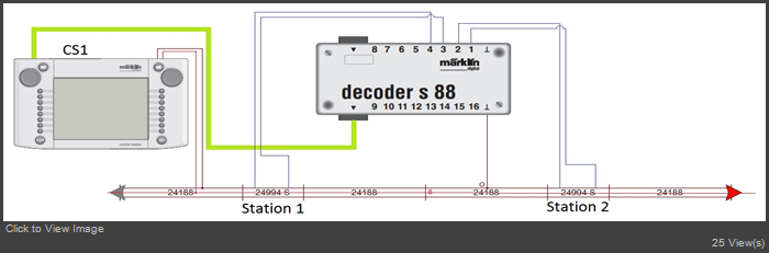

#8 Posted : 10 November 2018 11:45:32(UTC)
Posts: 7,464
We started with a CS3 and now a CS1. I have a CS2 but presumed the CS3 would work in the same way.
Might be good if somebody with a CS1 could help. The last diagram above is correct for me. Make sure the wires to the contact track are correct and your loco is correctly set up for shuttle.

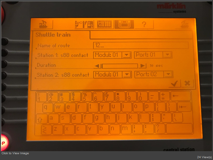

I've tried 5 different locos, I followed exatcly the procedures written in the manual ( select loco > accelerate till the desired speed > push STOP > select shuttle train > push GO)
Is there a special loco programing that I must do?
#10 Posted : 10 November 2018 13:01:33(UTC)
Posts: 7,464
You need to programme the loco with the contact numbers on the S88 in order that it knows where to stop and start etc.

#11 Posted : 10 November 2018 13:44:52(UTC)
Mmagda
Posts: 41
You mean something other than this?
Thank you!
#12 Posted : 10 November 2018 15:22:52(UTC)
Posts: 7,464
Much as I would like to help I have CS2 which is different to the CS1 screen. You need to call up the loco then go to shuttle and put in the numbers of the S88.
contacts.
We need somebody with CS1 experience to help I think.
Your wiring should be OK providing the blue and brown wires to the contact track are correct as per the instructions that come with the contract track.
Hopefully somebody can help more than I have be able.

#22 Posted : 10 November 2018 19:46:51(UTC)
Views messages in topic : 15,463
Originally Posted by: Mmagda Go to Quoted Post
It seems my CS1 doesn’t have the ability to program the s88 contacts into the locomotive decoder in order for it to stop/reverse/start and so on.
I don’t know if that is a must.
You cannot program anything related to s88 or to shuttle operation into the loco decoder.
Shuttle trains work with any decoder without changing the decoder in any way.
Shuttle trains are a feature of the CS1. I think the screen you are showing is the only place where you have to configure anything for the shuttle train.

However looking at the diagram of the CS1 above it appears that it refers to a route (12 in this case) so I presume then that any loco on that route will operate. This is different to the way I run my shuttles so I expect we are talking at cross purposes in which case I may be giving the wrong information in respect of a CS1.

Suttle train steps in CS1 (as I know them. If I am wrong, please, point it out to me)
1 Call up the loco from loco selection menu
2 Bring the loco between Station 1 and Station 2
3 Set the speed that you you want the loco to have using the rotary knob
4 Press “STOP”
5 Select shuttle train from the loco edit menu
6 Select the route of the shuttle train (in this case: Station 1/Station 2)
7 Press “GO”
The loco is no longer under my control and it even has a small symbol right beneath it with a loco and left and right arrows, indicating that the CS1 is in charge of the shuttle train.
That is what I am doing, but still, no results.

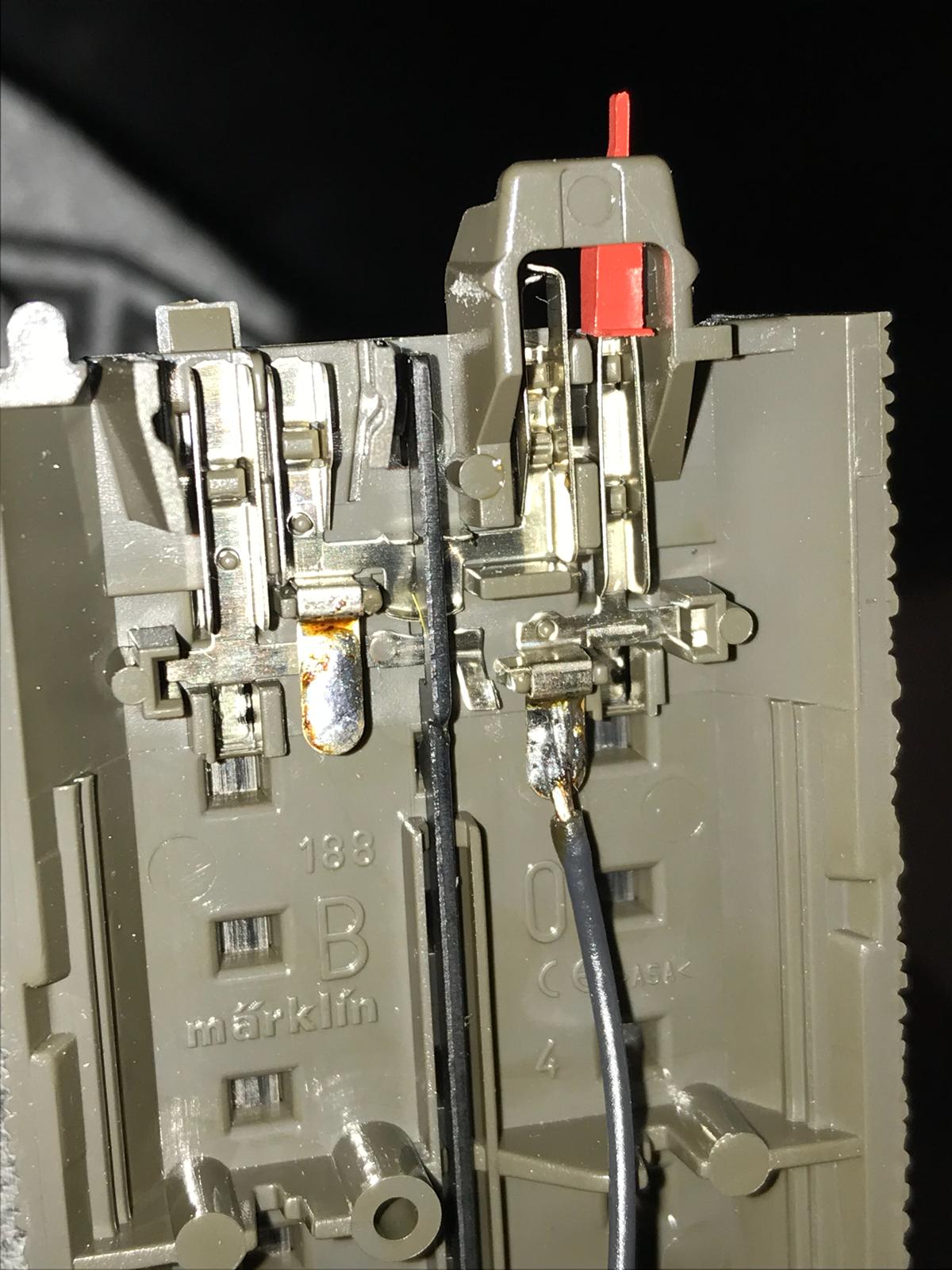

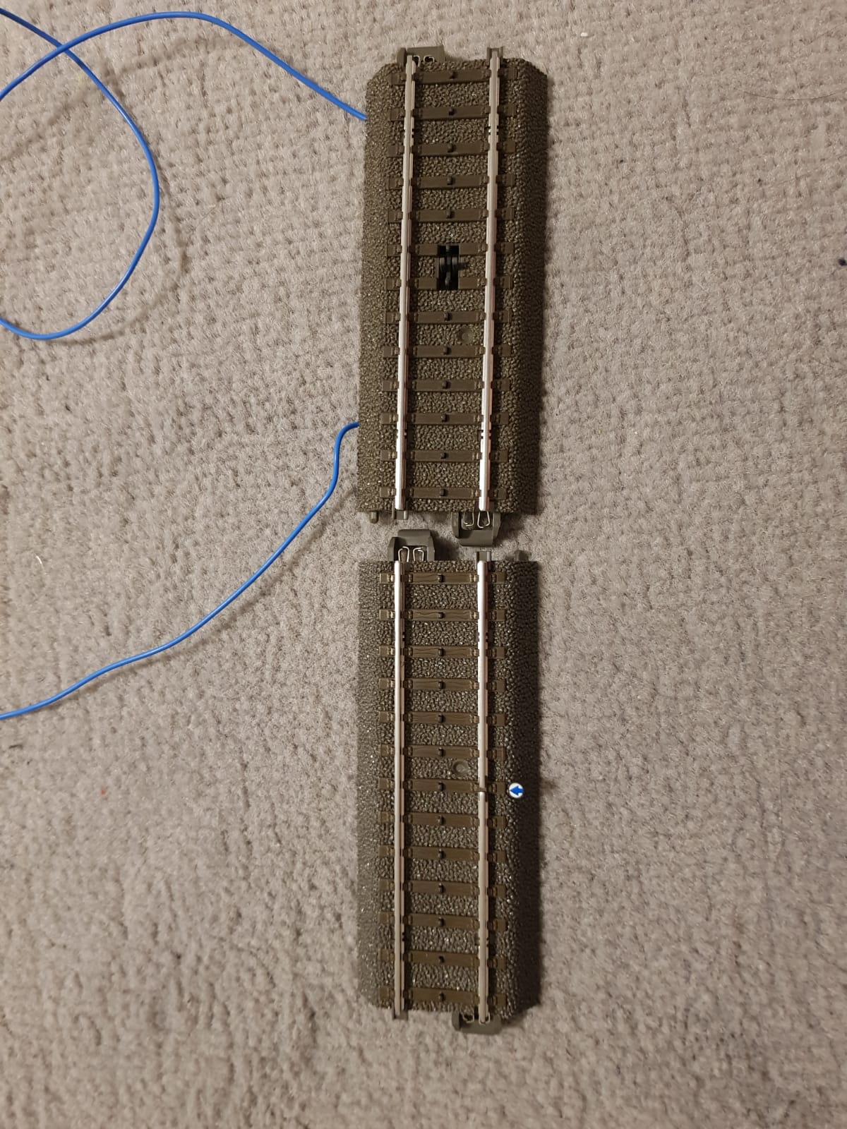

Can you post a picture of the contact track showing how it is wired with the blue and brown wires.
Offline Mmagda
#32 Posted : 11 November 2018 01:37:50(UTC)
Mmagda
Posts: 41
There you go.
I am not using the 24995, I am using the 24994 (circuit Track)
Like this:

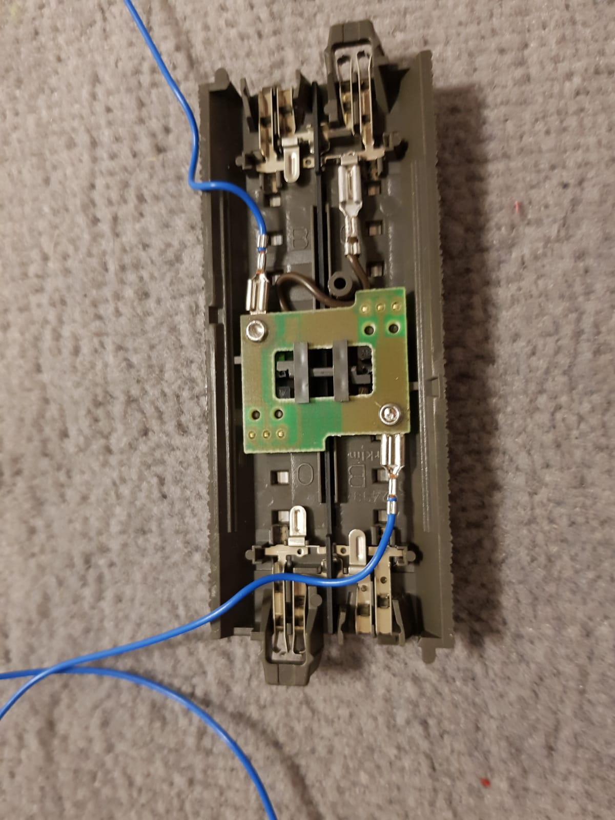

you always need a feedback decoder like a L88 or S88, too.
I am using one, and I have changed the wiring; now I'm using two contact tracks:
I am starting to believe that the CS1 was a bad investment, together with the s88, and K83 decoders (although the K83's work) Cursing

Your wiring is fine.

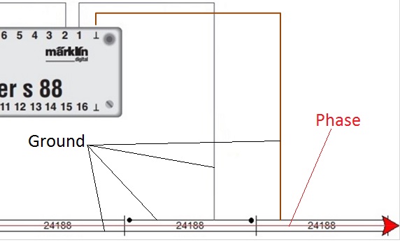

Hello Mmagda,
The wiring diagram you supplied is incorrect as it should have a ground wire for the first s88 in the chain.
Hope this helps
Ross
thanks 2 users liked this useful post by Ross
Offline Mmagda
#50 Posted : 12 November 2018 00:10:38(UTC)
Mmagda
Posts: 41

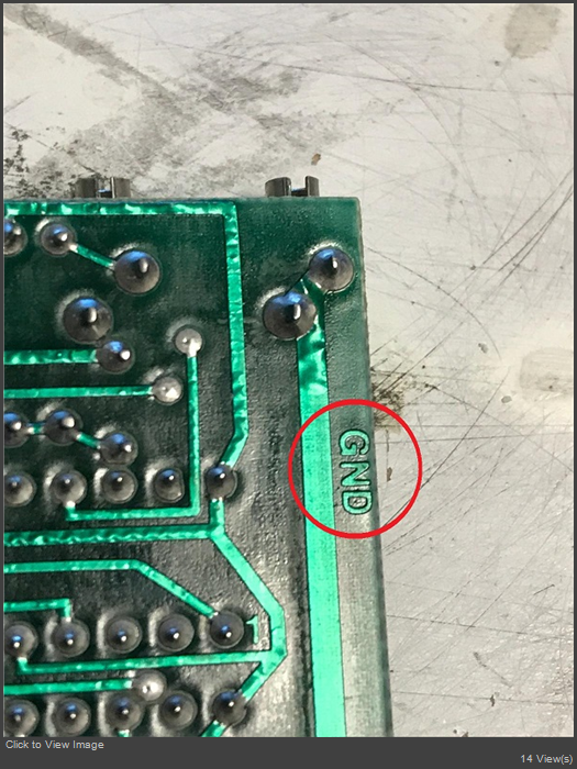

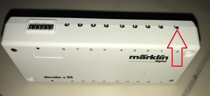

Hello!
Thank you for the time you took to modify the drawing!
You mean this port?
well, that creates a problem:
I can only create a contact track using the C Track OUTER rail which is the GND rail (both L and R outer rails are GND).

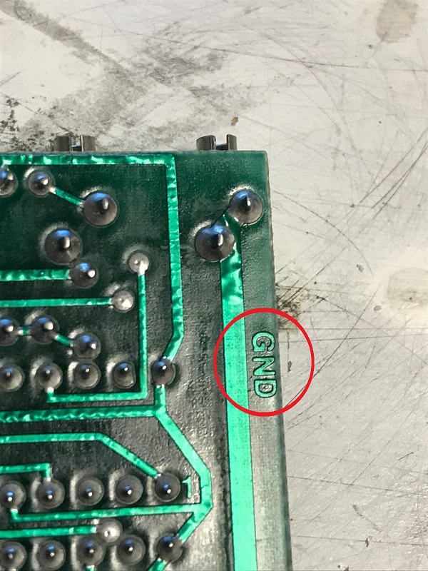

Now, I opened the s88 module and indeed, that very last port seems to be the GND port as it is indicated on the electronic board.
But that would mean to connect the GND from the contact track with the GND from the rail. That would make no sense because it will not trigger anything.
It would be correct to have the center rail connected to the 1,2,3....16 ports and the outer GND rails connected to the "_|_" port, but i cannot insulate the center rail for two reasons:
1 the cars will not activate the s88 sensor unless they have a slider
2 any loco hitting that portion of the track with the center rail insulated will stop.
I'm kinda in a dead end here, nevertheless I'll try your advice as well.Blushing
