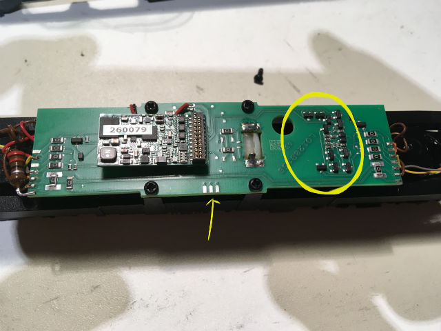

I set up F5,F6 per Costa's suggestion, and yes F0 overrides this. If I leave F0 off, then I can select which headlights to leave on (also per Tom's suggestion). But the rear talights shut off too. Would like to have them stay on. So maybe some soldering will be involved, but not sure I am that interested. I only want to be able to shut off the forward headlights for "push' configuration.
I cannot read the old decoder with the Decoder Programmer, not supported, so I cannot see how F6,F8 were set up unfortunatly. I'll have to experiment with the configuration settings of the lights and see if one of the settitngs triggers the loco board 'bird seed" (circled).
[img=null]locopcb[/img]locopcb.jpg
What are the three solder tabs (arrow)? Is this the Aux 1,2,3?

#9 Posted : 04 December 2018 18:30:06(UTC)
Posts: 15,578
The decoder can be read with a CS2, probably also with a CS1. The CS3 should sooner or later also be able.
If you do not have any CS, then maybe another forum member with a CS and a 36627 can tell us what F6 and F8 do with the original decoder.
Typically this would be a pair like AUX1 and AUX2 - or a pair like AUX3 and AUX4 - or a pair of SUSI functions. These are the three patterns I have seen with Märklin locos so far, but other methods are also possible.

Well that worked!
I don't have a Maerklin CS, but using the 60971 I configured F6 and F8 to controll Output 1 and Output 2, and now it works great, same as OEM setup. The headlights turn off and the red tail lights remain on in either direction, all while F0 is on. Perfect!
One day I may try diffent function button assignments (ie: F5,F6) and see if it still works.
Thanks once again for your assistance, Tom!
