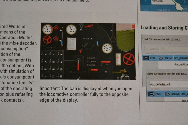

#21 Posted : 03 November 2018 10:09:01(UTC)
Posts: 9,358
Good news!
I did solved the problem.
It was foolish to solve the problem.
Thanks for the support! ThumpUp

#24 Posted : 03 November 2018 14:17:36(UTC)
Posts: 9,358

Hello Bertil!
The problem see you here in the picture.
This information did not stand in the locomotive manual which Märklin should present so customer knows it.

So basically, it works when you read the manual? Who would have thought.
It is a good approach to place locomotive-specific information in the loco manual and controller-specific information in the controller manual.
mfx+ came before the CS3, so it is chronologically impossible to have CS3 usage tips in all mfx+ manuals.
Märklin's user information is often distributed over several "manuals". You have at least four pamphlets when you try to add a decoder, a motor, and a lantern to a turnout.
Having "How to" instructions would often be helpful. Sometimes you get those in Märklin Magazin or Märklin books.
Buy the books or read the fancy manuals.
Märklin presented the required information - and as far as I can tell they presented it at a reasonable location.
#27 Posted : 04 November 2018 08:50:05(UTC)
Posts: 9,358
This information MUST stand in the locomotive(s) manual when it´s about mfx+ decoder which support "world of operation".
It support more easier to understand what to do with the CS3.
You cannot expect this information in a loco manual that was printed before the first CS3 was sold.
Resizing windows on a controller is controller-specific and not locomotive-specific.
This behaviour may change completely with a software upgrade for the CS3, rendering the redundant information in the loco manuals obsolete.
In your opinion the information MUST be in the loco manual, in my opinion it CANNOT be there. Let's agree to disagree. Over and out.

I did bought 37872 and in this manual it stand with CS3 how to use functions.
It MUST be same way how to use "world of operation" stand in the manual of locomotive which do have symbol + how to open the displayed in the CS3.
It verified easier way for the customer.

Posts: 9,358
In fact do i see real problem was porr information by of Märklin when you buy an Märklin mfx+ locomotive which there MUST stand information how to start "world of operation" with the CS3.
Don't tell us what Märklin MUST do, instead let Märklin know.
I think this Groundhog Day thread can now be closed. Cool
Märklin do know the missing part in the locomotive manual.
A picture with few words says a lot!
