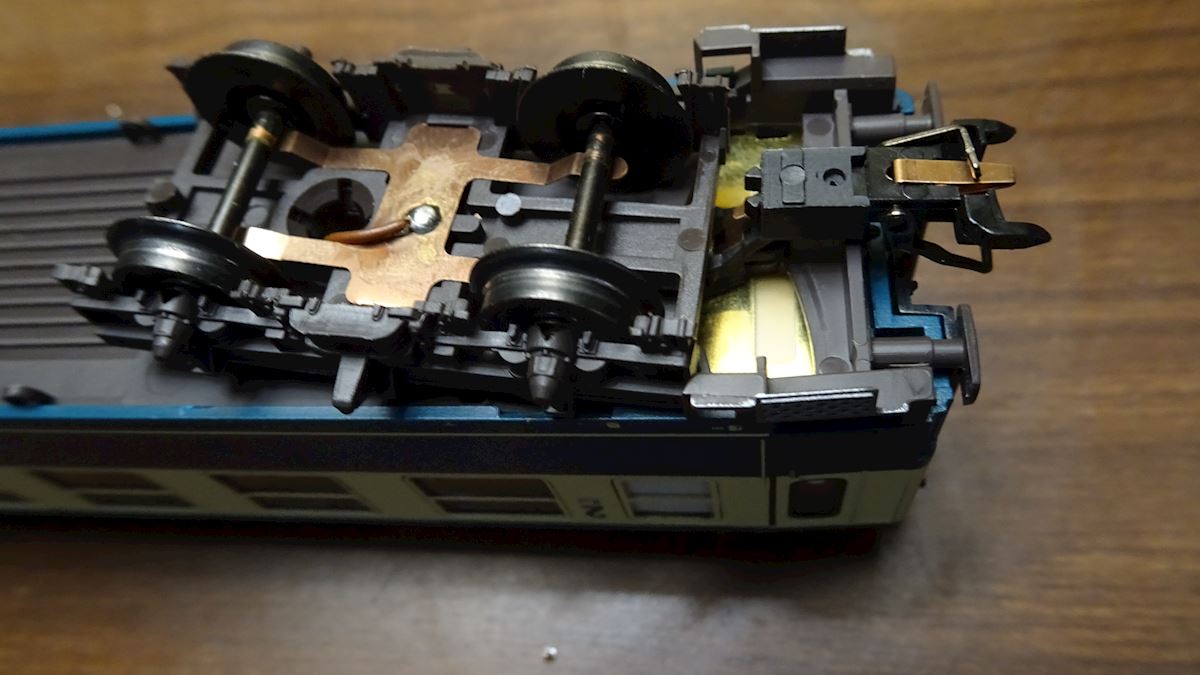

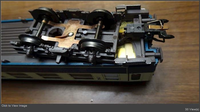

I noticed two of your cars have current conducting couplers which I have on my 4428 Reinewald set. They always seem to have problems because the little spring pops out and then the chassis is too stiff to make the bends. However the rest of my couplers work ok except when the old and new style join together which then I have to fiddle around to join them but they of themselves do not cause derailments. Check if the springs are attached (I admit couches are a pain to take apart) good luck - Fred
4428 Reinewald set? What mysterious set is it? I found for Märklin # 4428 this wagon and no set:
https://www.lokmuseum.de...ine&Seite=4&SID=
I hope you enjoy a good cup of Ovomaltine.BigGrin
Try 4228 Rheingold RollEyes
https://www.maerklin.de/...ts/details/article/4228/
Offline TEEWolf
#17 Posted : 22 September 2018 20:52:34(UTC)
Thanks. Don't you think too, there is a big differnce between a pure forest and Gold from the Rhine?Laugh
