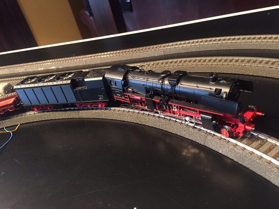

Hello all,
I have a Märklin 37171 Dampflok with a Loksound2 V.1 chip that started acting very erratic & strange this past weekend. It will spontaneously just take off at a speed that is much higher than the max speed when using the Uhlenbrock controller. This locomotive is running like a sewing machine on steroids, I have to keep a very close eye when using it because it will all of a sudden take off at full throttle "Casey Jones" speed and switch directions (forward & reverse) as well. I have to be quick to catch it so it doesn't jump off the track and get damaged. It's on the shelf for now, until I have time this weekend to open her up for inspection.
Has anyone had something similar like this happen?
I am not sure if it is a decoder problem or the Uhlenbrock control unit. I do not think it is the Uhlenbrock unit since the other digital Locomotives are running just fine.
The decoder was installed back in 2002, it has maybe 5 or 10 hours of operating time.

I have the 2003 Version R6 LokSound 2 booklet. On page 22 the CV 29 is described. Setting bit 2 to zero might help. It seems like the decoder change to analog mode for some reason. This will prevent running in analog mode.

Thank you goofy, and yes it only supports the Märklin Motorola and the DCC Protocols. On this Loksound 2 decoder CV 29 is The configuration register. 2 was set on bit 2, so I changed that to 0 to switch off analog operation.
CV 47 in this manual is Function Assignment F9(r), Which is a function outputs activated by key F9 when driving backwards. What is your CV47?

As far as I understand this decoder has the DCC address in CV1 and the MM2 address in CV64 and no way of disabling either of them. In other words: it is always listening to commands for both addresses. If you are sending DCC commands to another decoder with the same DCC address, this decoder will also respond. The decoder don't know how you have set your controller.

Danke Blid, your suggestion above seemed to work. My daughter and I ran it for about an hour without any problems.
