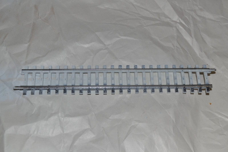

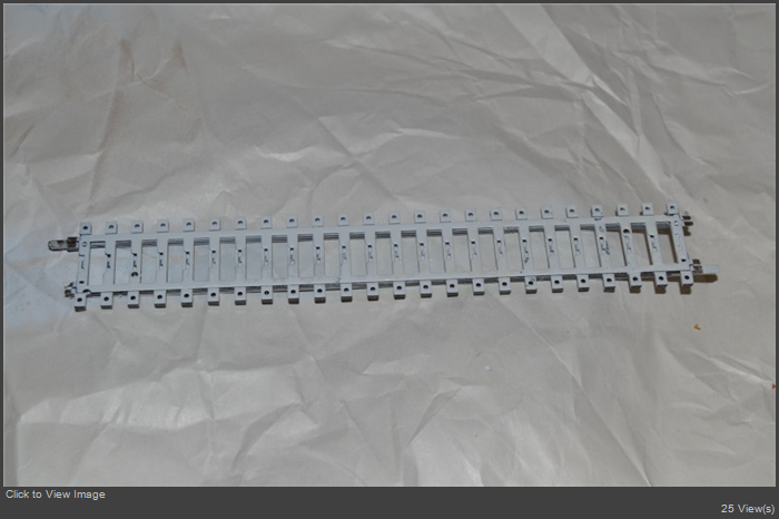

It looks to me that the spray has only put a coat onto the underside of the metal base.
When you use water-based glue for your ballast, the moisture will possibly get between the base metal and the sleepers - I suspect that area is not protected because the zinc spray would not get into that gap.
Attached are images showing the base removed from a double-slip (for example), for full protection you would need to remove the metal base completely and spray both sides and I can tell you (from experience), you do not want to be doing that to every track piece! OhMyGod
You will reduce the chances of rust for certain, and perhaps long enough for the expected life of your layout but do not be surprised to still see rust develop where the zinc spray cannot reach.
Good luck anyway Smile
Steve
(snip images)
You have right!
To protect the tin from rust i must spray both side of it.
This is not for me.
