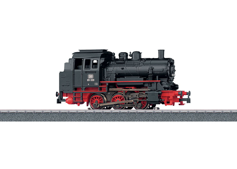

Do you realize that you can buy a digital locomotive much like yours brand new for 80 Euros? It's the 30000, the modern equivalent of the 3000, and it works pretty well.
Adding sound after you converted your loco to digital would mean starting all over again and buying a much more expensive decoder that would come with a speaker. Both would then have to be installed.
You are looking at a lot of money. Don't do it.
If you really like sound, and in a steam loco they are very nice, buy a brand new one.
(A word of caution, however: before you buy a Marklin steamer at a low price, like the 36244 for 200 Euros, find out what people are saying about it. I have its predecessor, the 36243, and it was not a good buy. It does have wonderful sounds, however. It is slow and the motor died within a year. Fortunately, the local Marklin shop here was able to replace it under warranty pretty quickly.)
Hope this helps.
Here is a picture of the 30000:

Sorry, but Vicente likes to convert a Gauge 1 loc to digital. 3000 and its successor 30000 is Gauge H0.
Kind regards
Jörg
