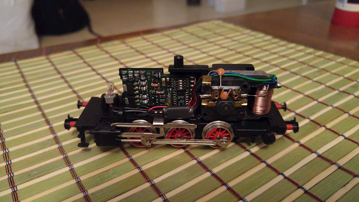

Offline Or Vivante
#8 Posted : 30 December 2016 16:25:55(UTC)
Or Vivante
Israel
Joined: 27/12/2016(UTC)
Posts: 10
Thank you every one for your replays
I can't seems to find the search option in my IB Basic
The 89 010 starts with an H, What does it mean?
Attached here is the two locos
#9 Posted : 30 December 2016 16:36:37(UTC)
Posts: 15,474
With your BR 80 you should try address 60. Also try 78, 24, and 72 if 60 does not work.
With your BR 89, you can set all four switches to ON for address 80. Currently they are all off for analogue operation.
All 15 supported addresses can be found here:
https://www.marklin.com/tech/digital1/delta4.html
https://www.marklin.com/.../digital1/add_table.html
It is possible to change the address of the BR 80, but it is not simple.
This German post in the Uhlenbrock FAQ explains this:
http://www.uhlenbrock.de...en/ib-1/I79ACDE3-001.htm!ArcEntryInfo=0004.27.I79ACDE3&NewServerName=zeta

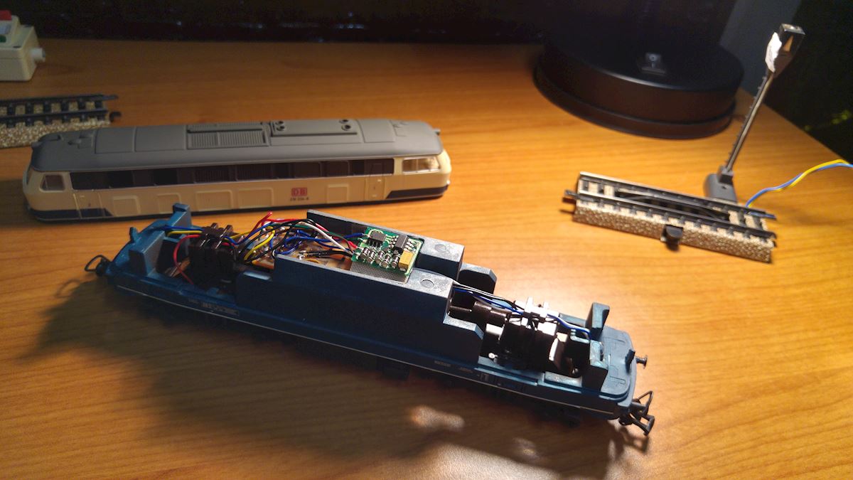

Offline Or Vivante
#17 Posted : 19 January 2017 21:48:48(UTC)
Or Vivante
Israel
Posts: 10
Hi :)
Here are the photos
Thank you HO for the manual who helped me open up the loco :)
#18 Posted : 19 January 2017 22:17:13(UTC)
Posts: 15,474
Try this manual:
http://www.uhlenbrock.de...C3-011.apd/Bes75322b.pdf
Scroll down to the section "Setting the address with the Intellibox". If the decoder has the default settings (address 78, analog mode) this should do the trick.
Here is a German description how you can reset the decoder - if the current address is not 78.
http://www.uhlenbrock.de/de_DE/service/faq/decoder/I4B054FC-001.htm!ArcEntryInfo=0004.18.I4B054FC&NewServerName=zeta
I hope Google translation works for you. Feel free to ask if something remains unclear.
You have to connect two spots on the decoder with a wire/pair of tweezers while there is power on the track. Connecting the wrong spots could kill the decoder, so take care.
