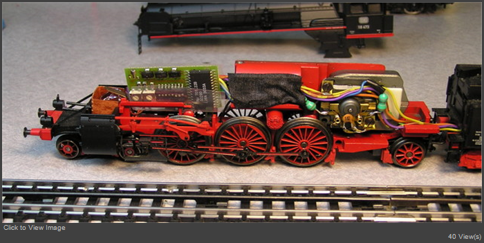

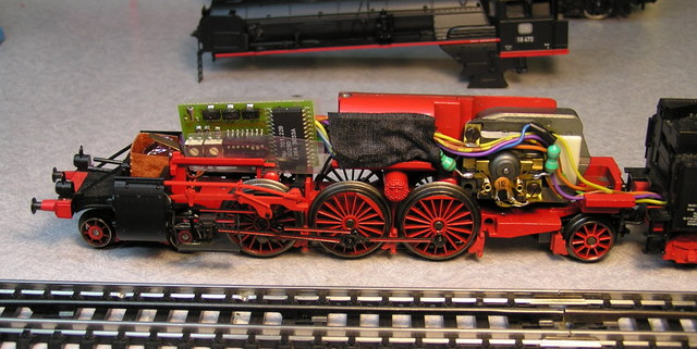

Offline mb300e4m
#9 Posted : 14 December 2016 14:09:46(UTC)
mb300e4m
Joined: 07/06/2013(UTC)
Posts: 432
Location: Florida
Originally Posted by: ktsolias Go to Quoted Post
This Loco has a 5 pole DC motor c90 (6090) already
No need to change motor at all.
Here is a picture with the body off.
Peter B.
In Sunny Florida most of the time.
Marklin, Trix Express, Trix Twin, Fleischmann, Liliput, Hornby Dublo, and Others, 2 & 3 Rail, AC, DC and Digital, Course Scale Wheels & Fine, 1935 to 1960s usually.
thanks 1 user liked this useful post by mb300e4m

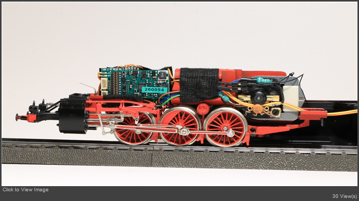

#10 Posted : 14 December 2016 14:16:34(UTC)
Posts: 15,873
That's definitely a DC motor and C90 decoder. Just change the decoder for a modern sound decoder from Marklin or ESU. A relatively straight-forward conversion.

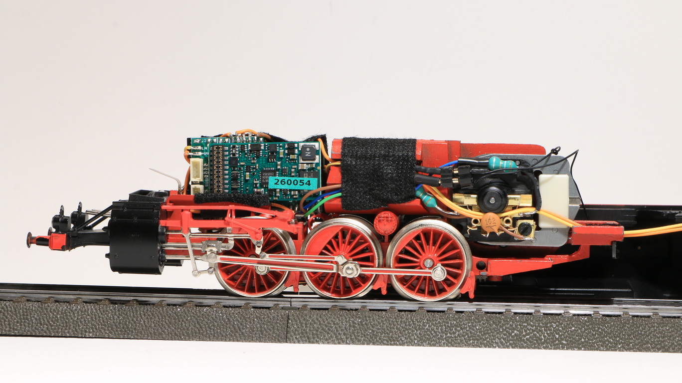

#11 Posted : 14 December 2016 19:34:12(UTC)
ktsolias
Joined: 01/05/2016(UTC)
Posts: 623
Location: Athens
Yes very nice.
This is the conversion that I did 1 month ago of a 3318, (similar 18.4 the same frame) with motor 60941 and 60975 mSD3 decoder. I put the speaker in the tender (not shown). You have the motor!!!
Is a bit narrow and you must be very careful and isolate the inside of the body with tape, just in case....
The 60985 mSD3 or 60982 mLD3 are better because they are smaller. I have another one 18.4 and I shall use the 60985 mSD3...
Don't hesitate to ask for anything that you need.
Have good time
Costas
Notice: The two thin black wires with the SIL socket are for the cabin Light....All Lights LED of course.
