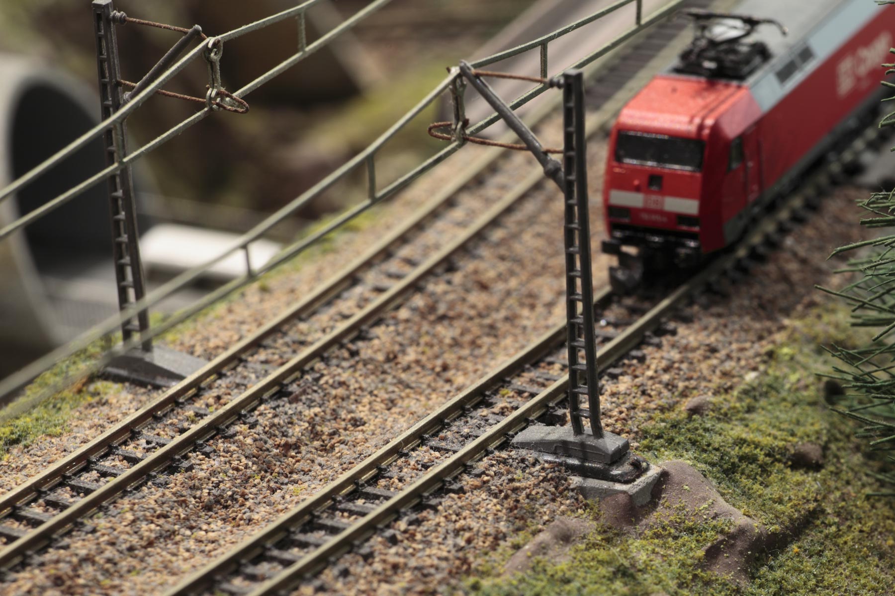

Use butcher's paper. I actually do 3d architectural models. At the scale of Z gauge you will get better sense of the entire layout pencilling it out to size, & fit in roads, buildings & growies while at it. Once you have ironed out most things. Create a master plan tracing onto drafting transparent drawing paper, say A0 sheets or A3 if that is all you can get & sticky tape together. It's not absolutely necessary but it is more stable for long term.
Laying carbon paper on you base board & tracing over the top is the simplest way to transfer all the dimensions.
To draw radiuses use a long piece of cardboard strip or whatever, push a couple of holes through at the correct distance to do pivot point & radius & push pencil through.

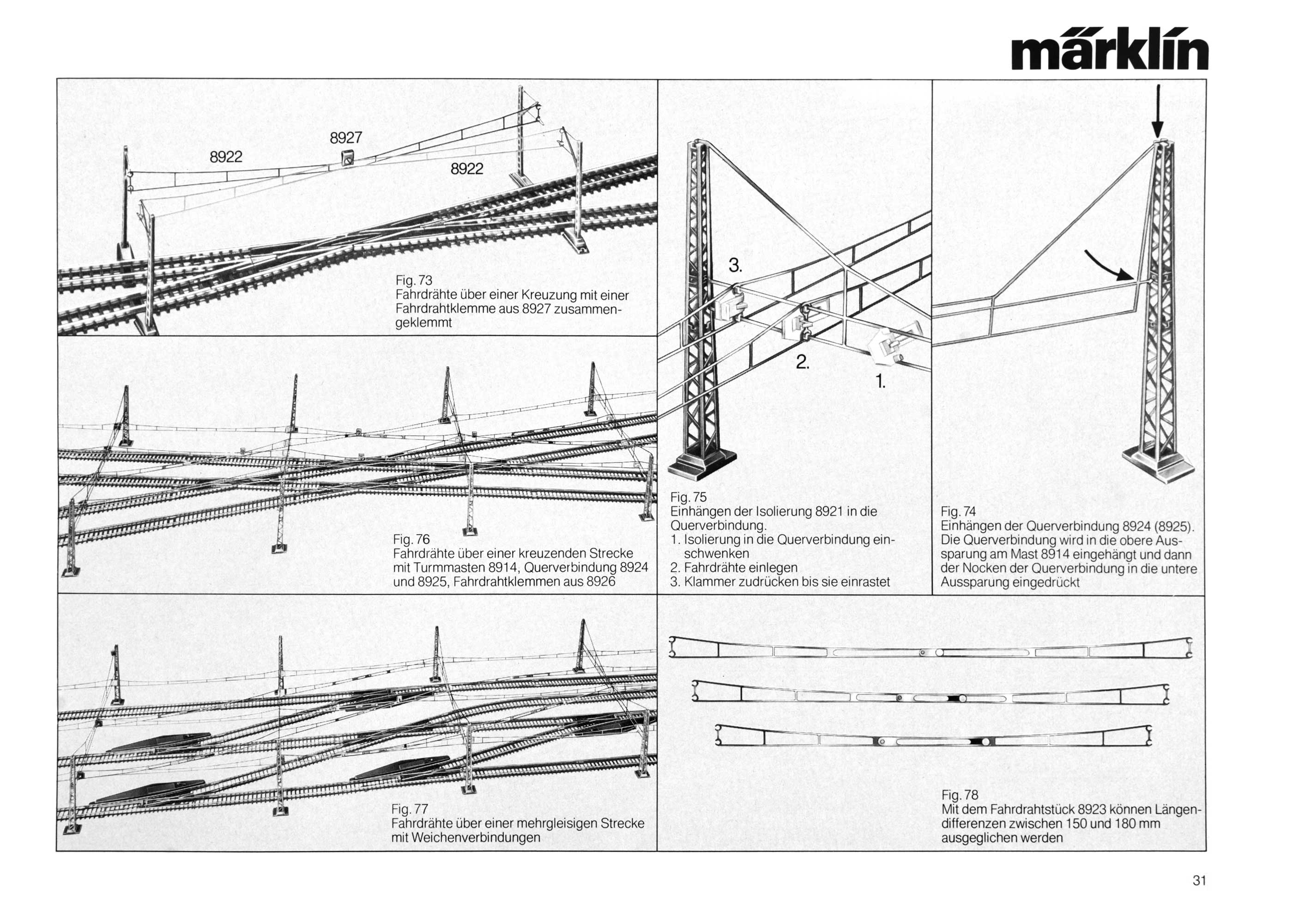

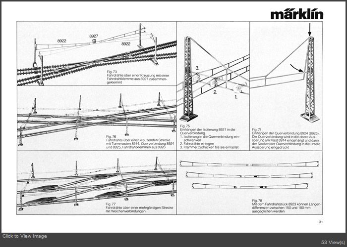

Catenary info from Marklin mini-club Gleisanlagen 0290 book pages 30 - 31

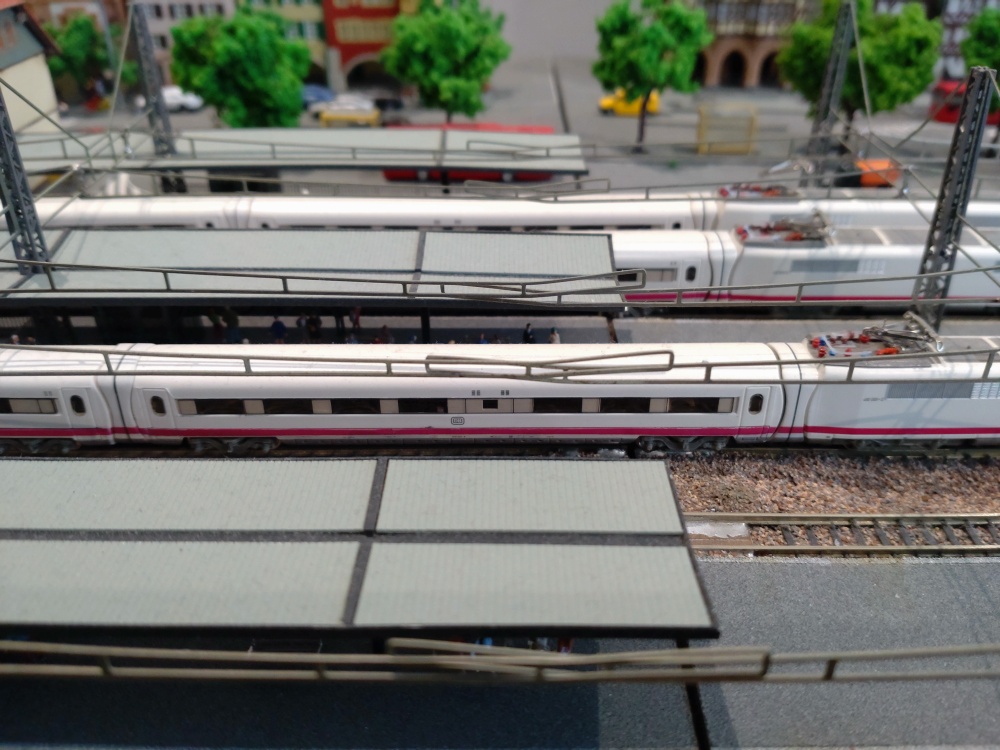

If you have station platforms the masts are too tall, so you need to cut a hole in the platform. Which means you really need to plan all your spacings on your "master plan".
If you have tunnels, I would advise you make a brass cross beam and solder the wire lengths and solder the adjustable length. You want everything bullet proof in difficult areas.
This is how I have the catenary over modules. If you are powering it you need power on each module anyway so it's not an issue.
Have at least half a dozen spares of everything, I have about 25 spare masts, probably gone a bit overboard! I have taken out quite a few masts with elbows etc. Even had to cut out bits of platform to unscrew a few destroyed towers. All the parts are actually pretty tough, it's really those major accidents during construction which are the issue.

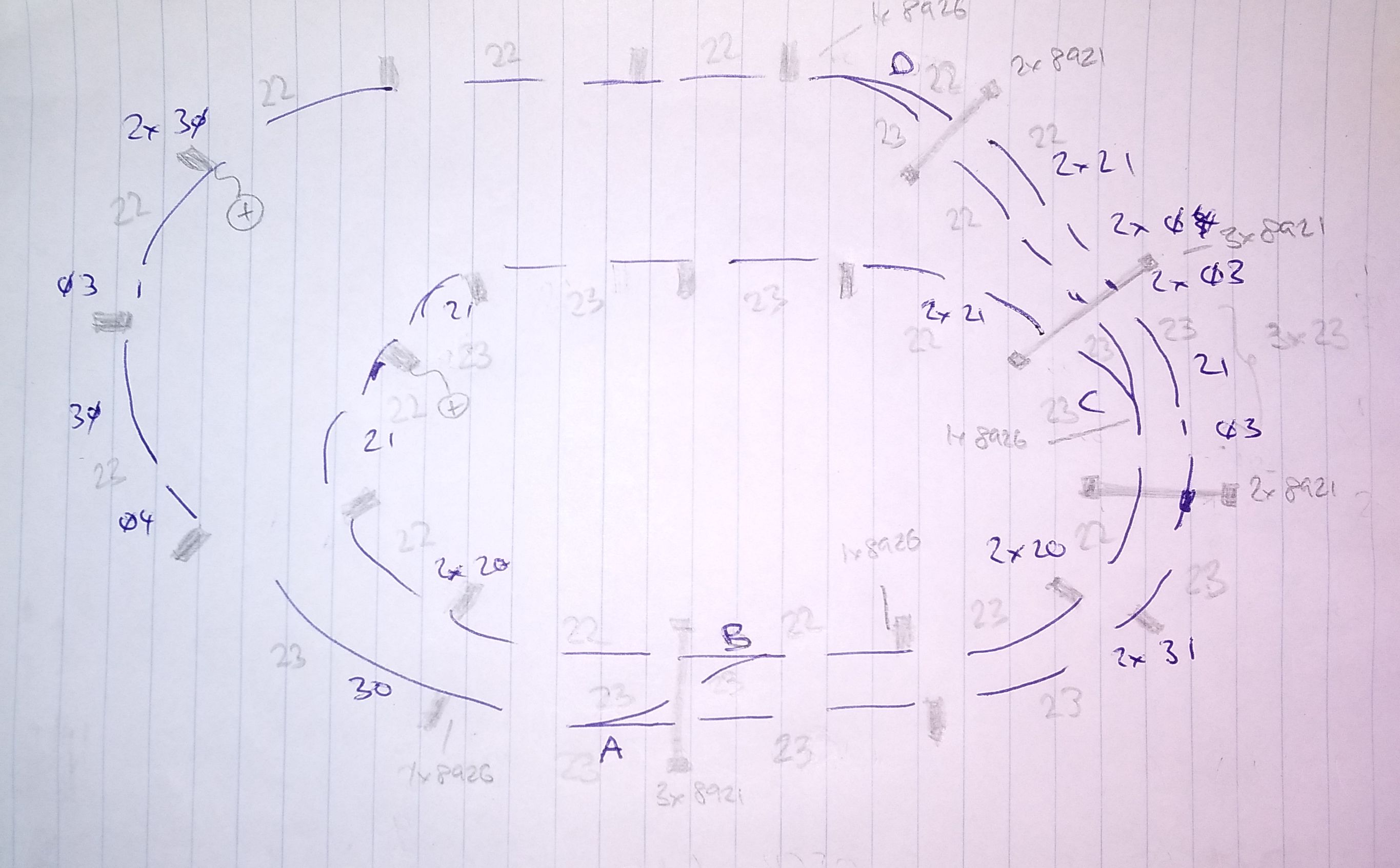

After some searching, the track design software, in AnyRail in particular, wasn't built-in as catenary requires a lot of fiddling and tweaks - even in the real world.
So I'll take TooSmall's approach and design on paper. This requires having a few physical parts to design with.
Before I make the purchase, I have some catenary pieces that I manually moved around the layout, eye-balled, and penciled in to get an idea of how many pieces I would need to order.
I'll order a few extra for contingency.
The blue pen is track, the gray pencil is catenary.

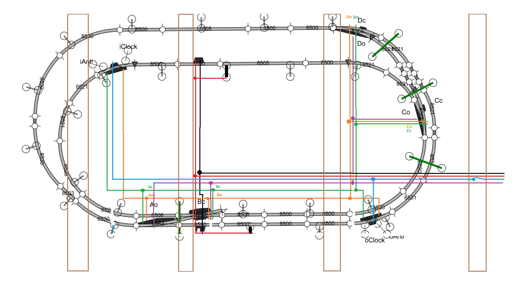

This pencil layout was then transferred into AnyRail, I've also made the straights longer.
It allows for the train to automatically run from the inner to outer loop and vice versa. Works in both directions.
Max train length would be about 400mm so that there is no potential derailment when the points are switched.
I've marked catenary masts in by hand.
I've also marked the wiring with the coloured lines.
The brown rectangles will be the baseboard support beams.

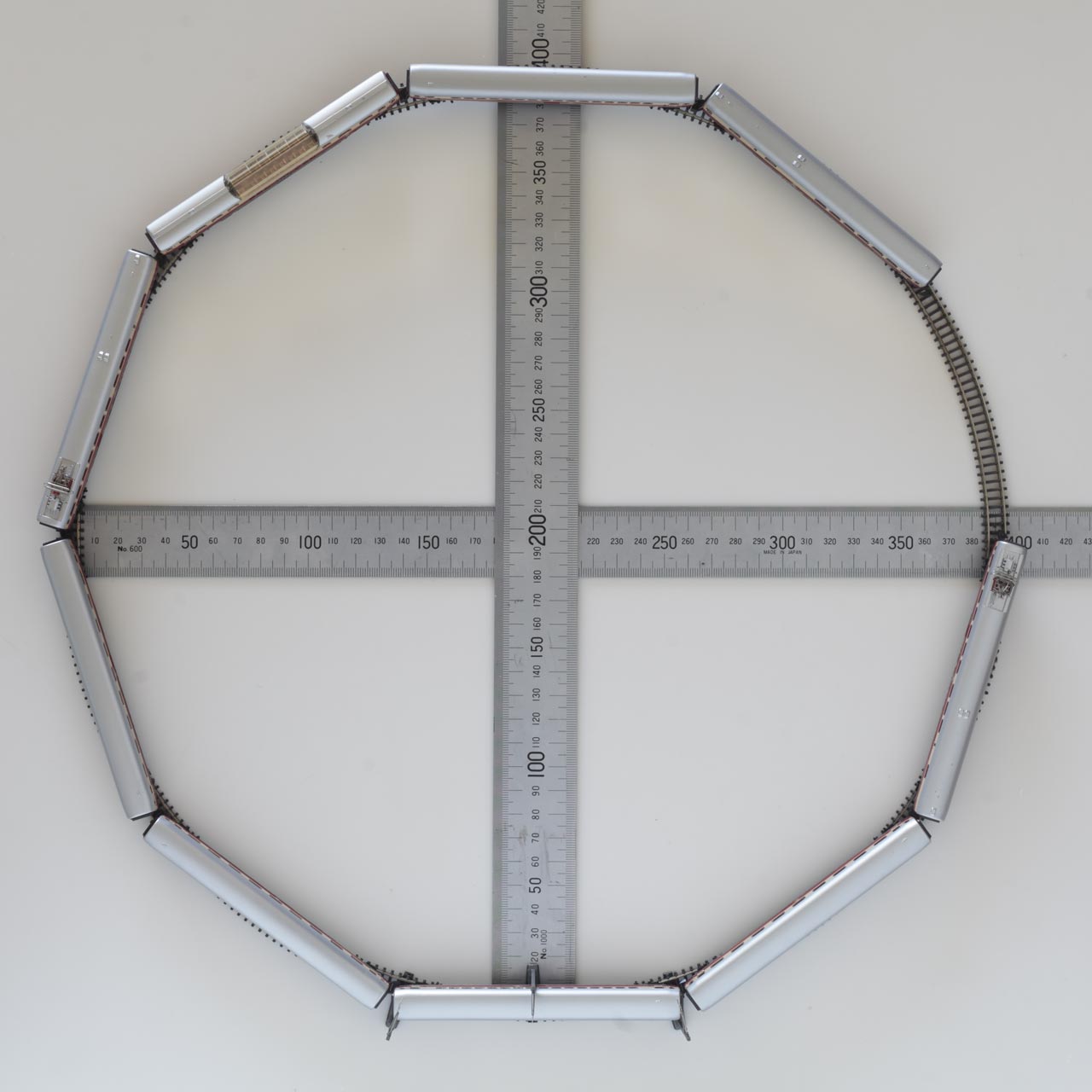

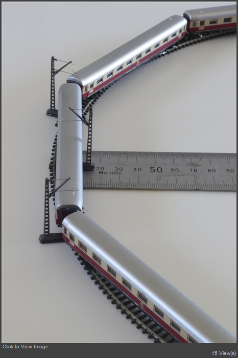

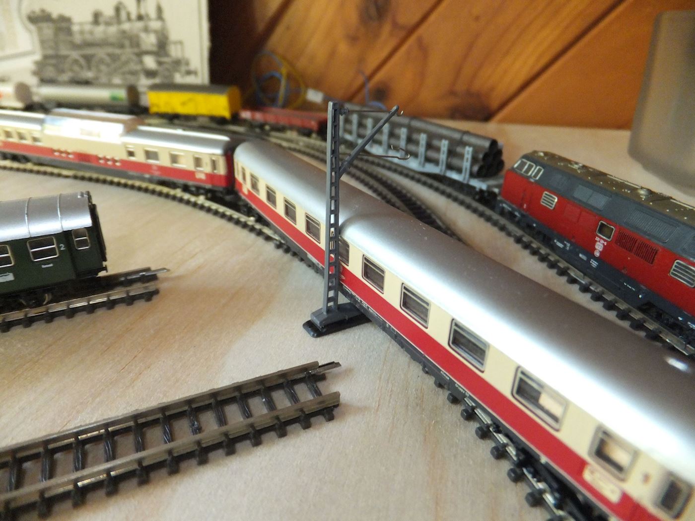

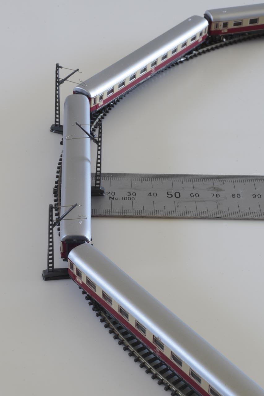

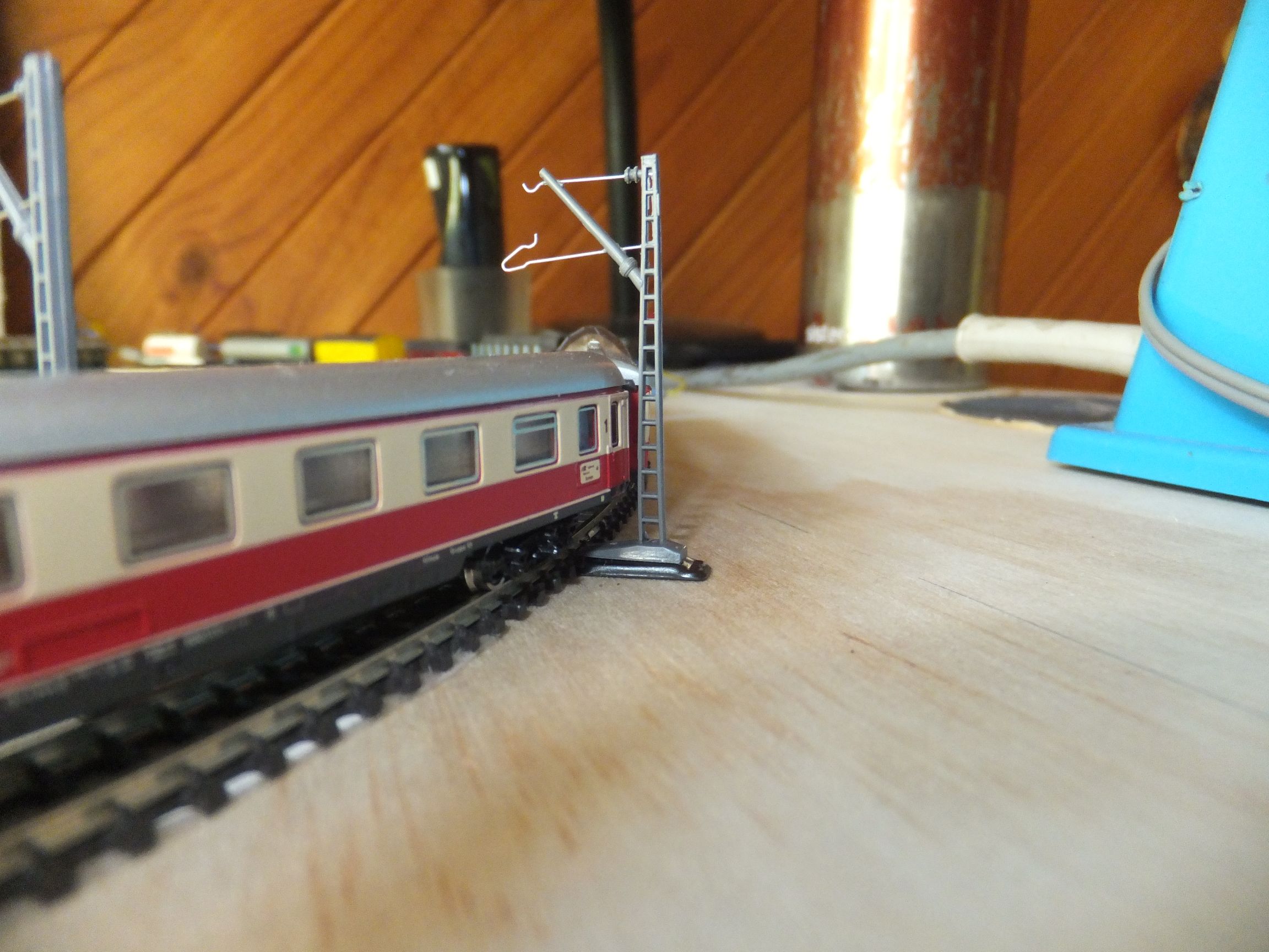

Märklin miniclub is great, but has one annoyance.
It has to do with using catenary masts and long passenger cars on section track.
Placing the catenary mast on the inside of either the radius 195 or 220mm section track, and you will always have the pasenger car touching and sliding against the mast.
Placing it on the outside curve, and there is the smallest of gaps, though still too small for my liking.
radius 220mm, inside curve (touching):
radius 220mm, oustide curve (tiny gap):
radius 195mm, inside curve (touching):
radius 195mm, outside curve (tiny gap):
This has to do with the passenger cars sitting over the rails when in a curve:
Of course this will not be a problem when you have smooth sweeping bends using flex track, but just thought I'd point it out.

The mast installed in the metal clip. There is the normal inner position & there is the outer position, though not ideal it should allow clearance. You need to nail the clip down through the hole in outside end of the clip.

195 radius track with masts set in the outer position.

Yes, that could work. I'd need to super glue the masts into their outer position. Should still be able to nail them in place as the feet won't have any hold on the track.
Also I'll test with catenary wire to see if the locomotive still picks up power - should be alright as the mast is only moved by ~0.5mm

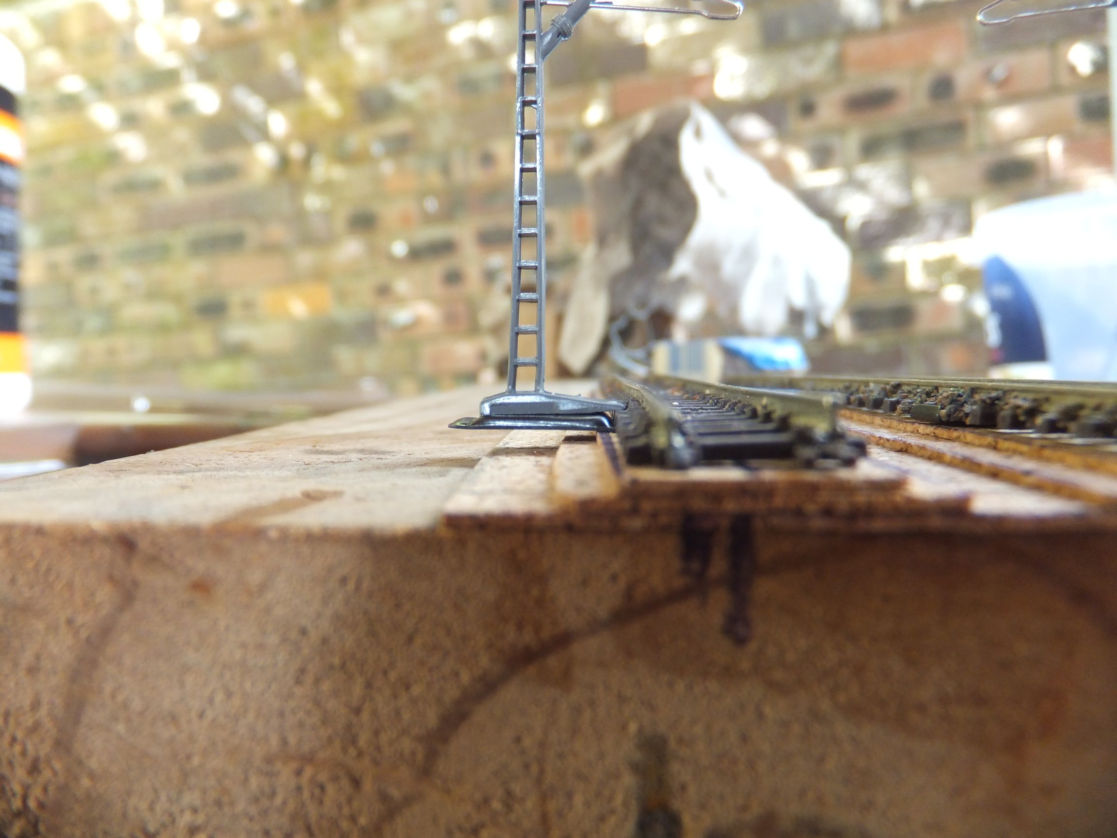

The mast locks into place solidly whether in the inner or outer position. You shouldn't need any glue, and I wouldn't use it anyway as one tends to demolish a percentage of masts, I have about 30 spares (haven't rusted). You will need to nail down the metal plate.
Mine are two decades old and the wire part has gone pretty rusty. Also bent the mast in the foreground. I have nailed all metal plates even though I am using the inner position.
The concrete block is grey 3mm Forex, all the track is sitting on it as well to help create some vertical topography.

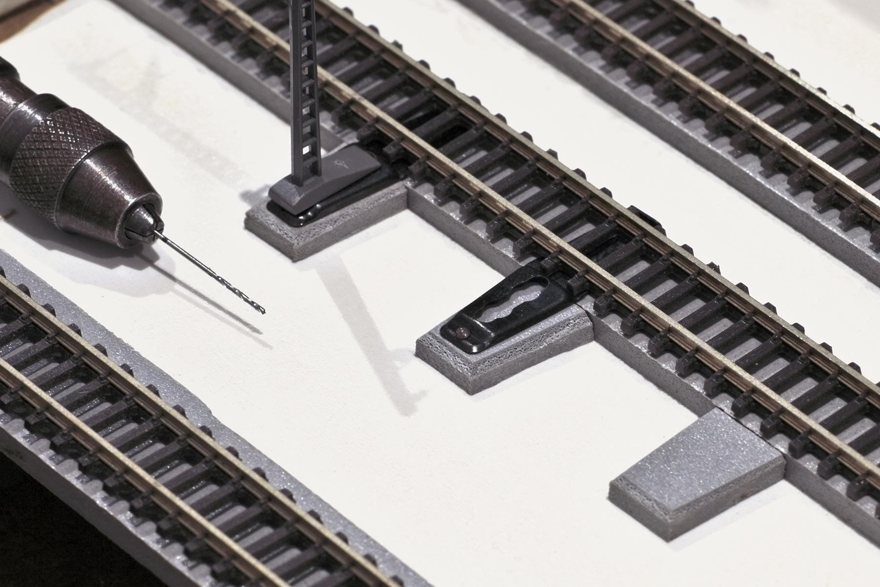

A mock-up of how I did the track bed base and mast base. The white base is only about 50mm wide to allow for greater topography height variation. Plan your topography at the start. It is actually the original elevation which otherwise you will have to spend a lot of effort on with the excavators. Look at the landscape first.

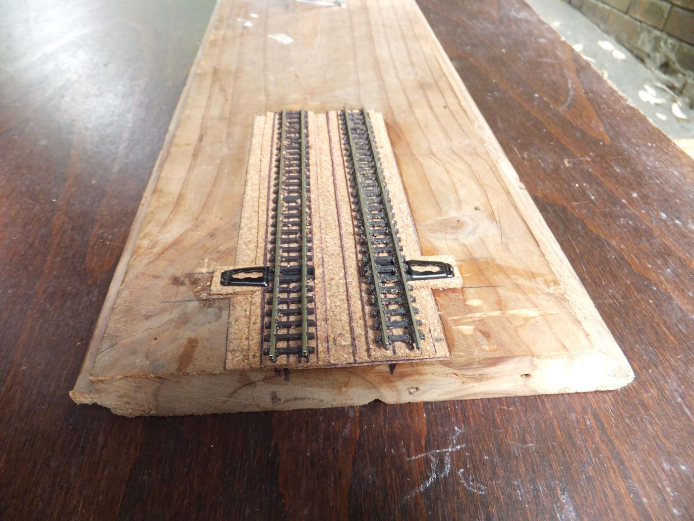

Another of my micro-dioramas to test my modelling techniques – before I commit to a larger layout.
I have some 0.8mm cork which I intend to use as my roadbed, having 3 or 4 layers deep in a staggered effect so the ballast has a natural angle up to the track (~20 degrees).
Yes, I should have painted the catenary mast base a concrete colour before ballasting – however this is just a test.
Added 3 feathered colours of turf, more dry/dead at the track edges.
I'm happy with the results (for a beginner).
Any constructive feedback on my work ? Positive and negative is appreciated.
Afterword: I am a beginner, not retired (seriously lacking time in this hobby).
I am mostly testing ideas/techniques at this stage, and am building a small module in parallel.

Your diorama is looking good. You can improve the Märklin catenary posts with a bit of paint - darken the metals bits, highlight the insulators, etc and then some weathering.
Carim
