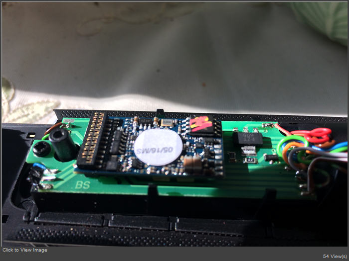

I have a 37995 loco with the 2 smoke generators. Both work great with the OEM decoder, nevertheless, I can't make it work with an ESU M4 decoder, despite I activate AUX3 or AUX4.
Does anybody know what's the AUX output used by the OEM decoder?

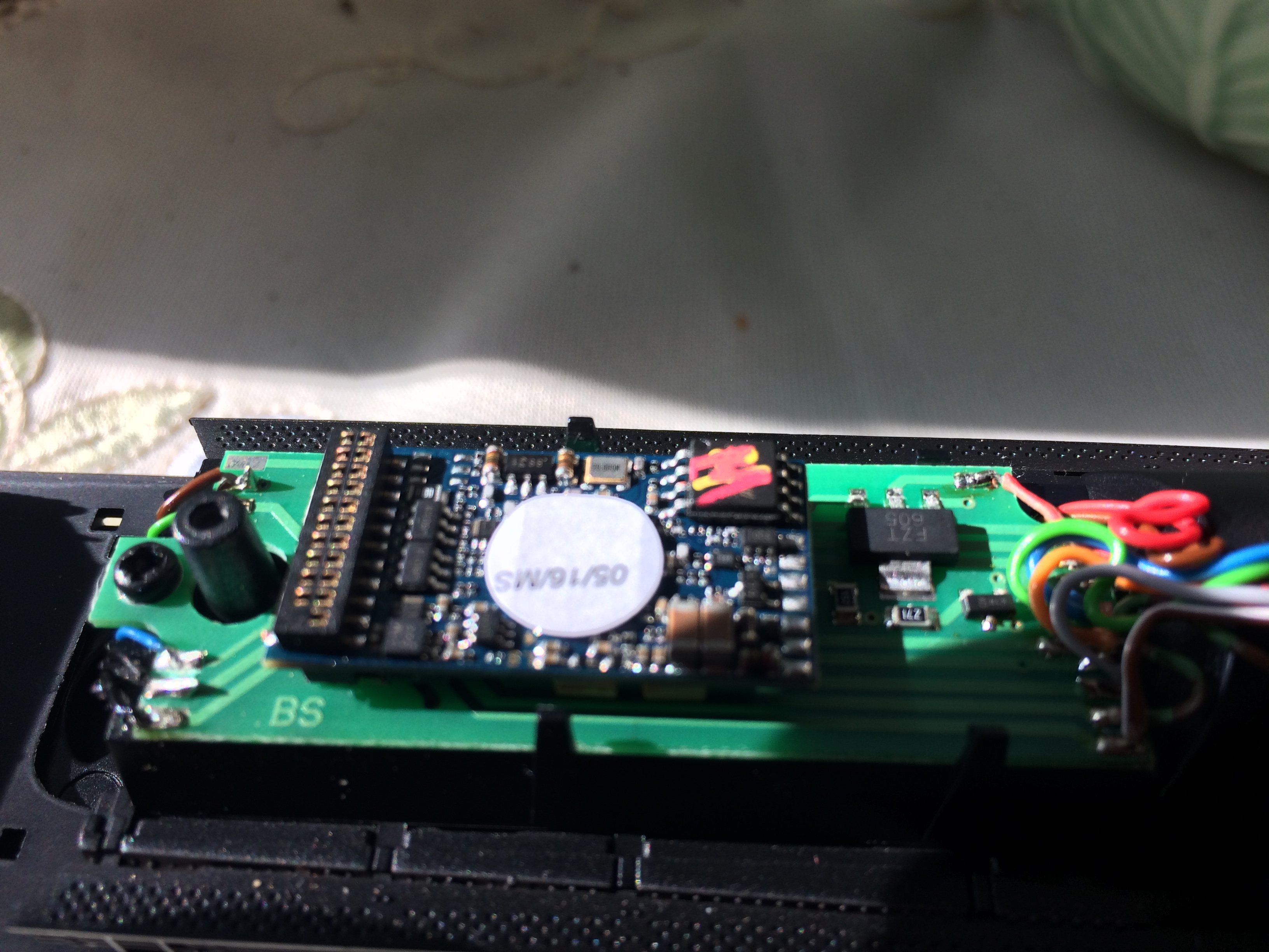

MTC21 v4 m4 decoder. Just removed the OEM one and connect it to the board of the 37995.

Danilo, there are several issues one has to know. did you set up the sound decoder yourself or was it already programmed by ESU, e.g. functions and Aux. I've just looked at the sound profile and I can see you've changed the settings.
program your decoder as follows:
1.) use Aux 1 for the smoke unit and not Aux 3. you've set the smoke unit under Smoke unit controlled by sound, remove it and replace it with Seuthe smoke unit
2.) under mapping: under logical functions, remove ESU smoke unit
Heat while loco is standing heat control 31, Minimum heat while loco is driving : 31, Maximum heat while loco is driving: 31
minimum and maximum can be later adjusted if needed (lower temperature).
3.) go into sound slots and untick the box: play only if sound is enabled.
4.) What is marquee ? move marquee to Aux 3, leave Cabina under Aux 2.
5.) there is an other abnormality with the Aux 3 function under F 14, you've got also the Acceleration and switching mode on the same F 14, remove acceleration and switching mode to 2 separate Functions
5.) I've noticed you've got 1 sound slot not active: sound slot 14 = oil burner,
the smoke units should work when you program the decoder to the above settings.
do you have an ECoS or CS ?

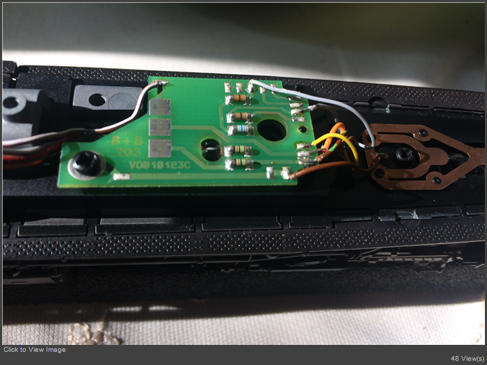

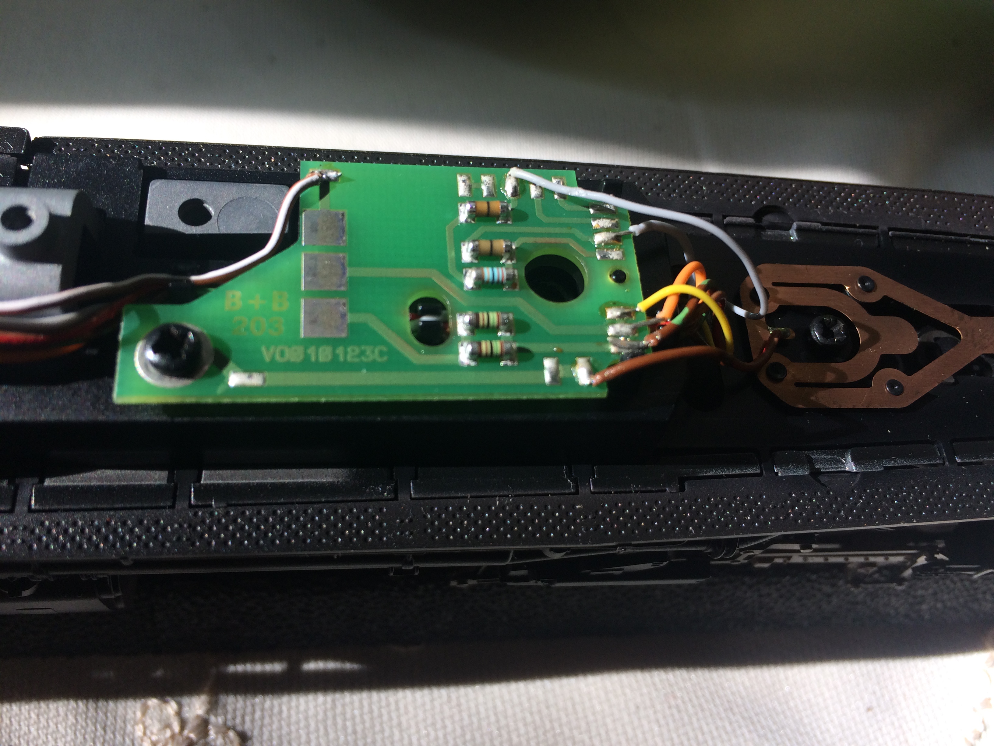

First you need to determine what functions or devices the aux outputs are connected. An ESU decoder tester is the best way and a wise investment if you plan to do more of these conversions. It was a humongous time saver for the 100+ lok I changed to ESU V4s.
Secondly, you need to find out how aux 3 and 4 worked on the M decoder. Alan and Tom hit upon this when they said you may need the Alan: "amplifier" and Tom: "Logic level" outputs. Marklin created a standard for the MTC21 and then promptly discarded their standard. They make decoders where aux 3 and 4 are just logic level (aprox. -5VDC) and line level (aprox. -12VDC). my guess is the Big Boy decoder has line level outputs so it can directly power the LED and/or smoke units. The ESU aux 3 and 4 outputs are strictly logic level. Negative 5VDC isn't going to operate much. ESU has not and probably never will make a decoder with aux 3 and 4 at line level. What to do?
You need the "amplifier" Alan spoke of and I linked in the prior PM.
This is a picture of one I installed in a 39100. You can see it on the left side of the picture. The inputs are across the bottom. Black goes to decoder negative and blue to decoder positive. Normally I find this power at the MTC21 connector. But with this lok I found solder pads above the MTC21 connector. These solder pads are easier to solder than at the connector. The green and purple across the bottom of the "amplifier" are soldered to the aux 3 and 4 outputs of the decoder at the MTC21 connector. This logic level output from the ESU decoder will turn on and off the amplifier transistors. The green and purple across the top of the "amplifier" are negative 12VDC outputs that will power the smoke or LEDs of the lok. You need to open the foils between the MTC21 connector and the device operated by the decoder. Otherwise the amplifier output and the decoder outputs will be commoned together. Very bad. This I do at the motherboard. You can cut the foil with an Exacto or a Dremel cut off wheel. Or drill out a cross connector on the motherboard where the circuit crosses from one side to the other. I did this at the purple wire at the top right of the picture. The outputs of the "amplifier" are connected on the far or device side of the open you make in the motheboard's foil. Now the logic level (-5VDC) output of the ESU decoder will turn on the transistor which is nothing more than a micro relay, and switch negative 12VDC to the smoker or LEDs.
This change allows the ESU decoder to function as the M decoder did and leaves the original motherboard so you do not have to completely rewire the lok as you would need with ESU's adapter board.
http://store.sbs4dcc.com...ctionAmplifierBoard.aspx

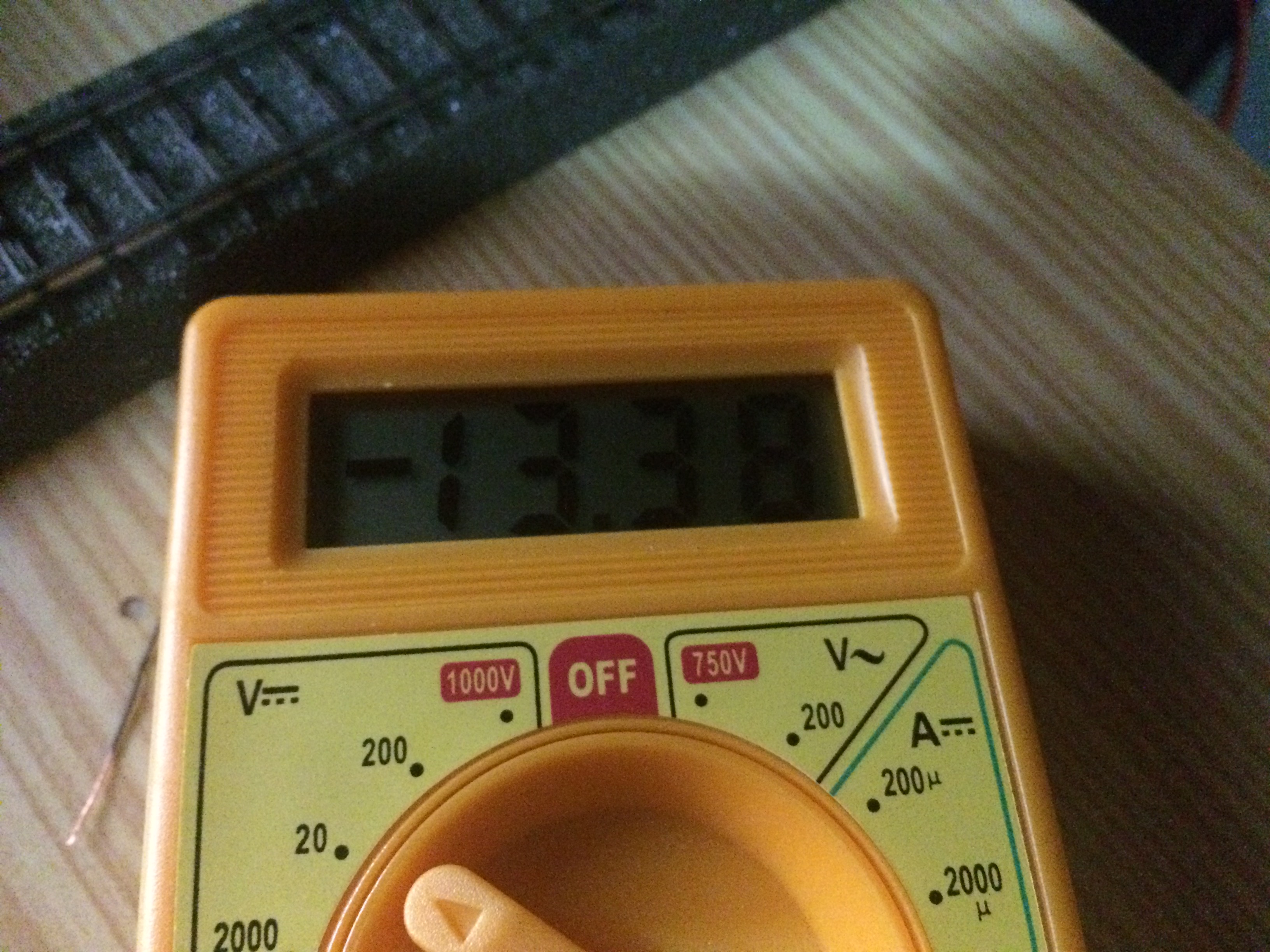

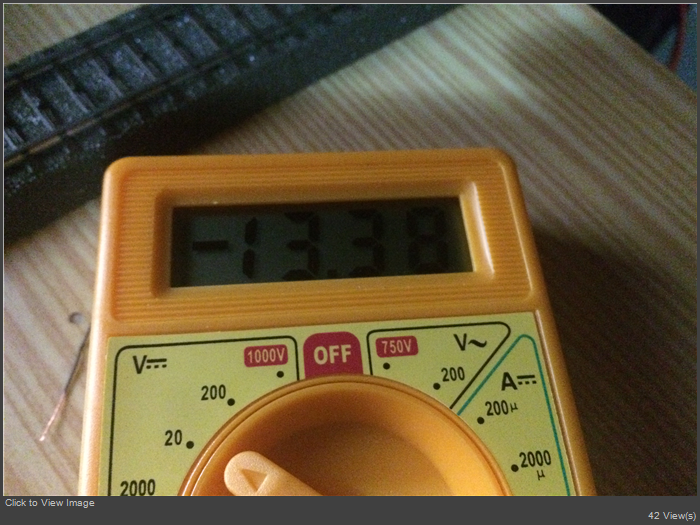

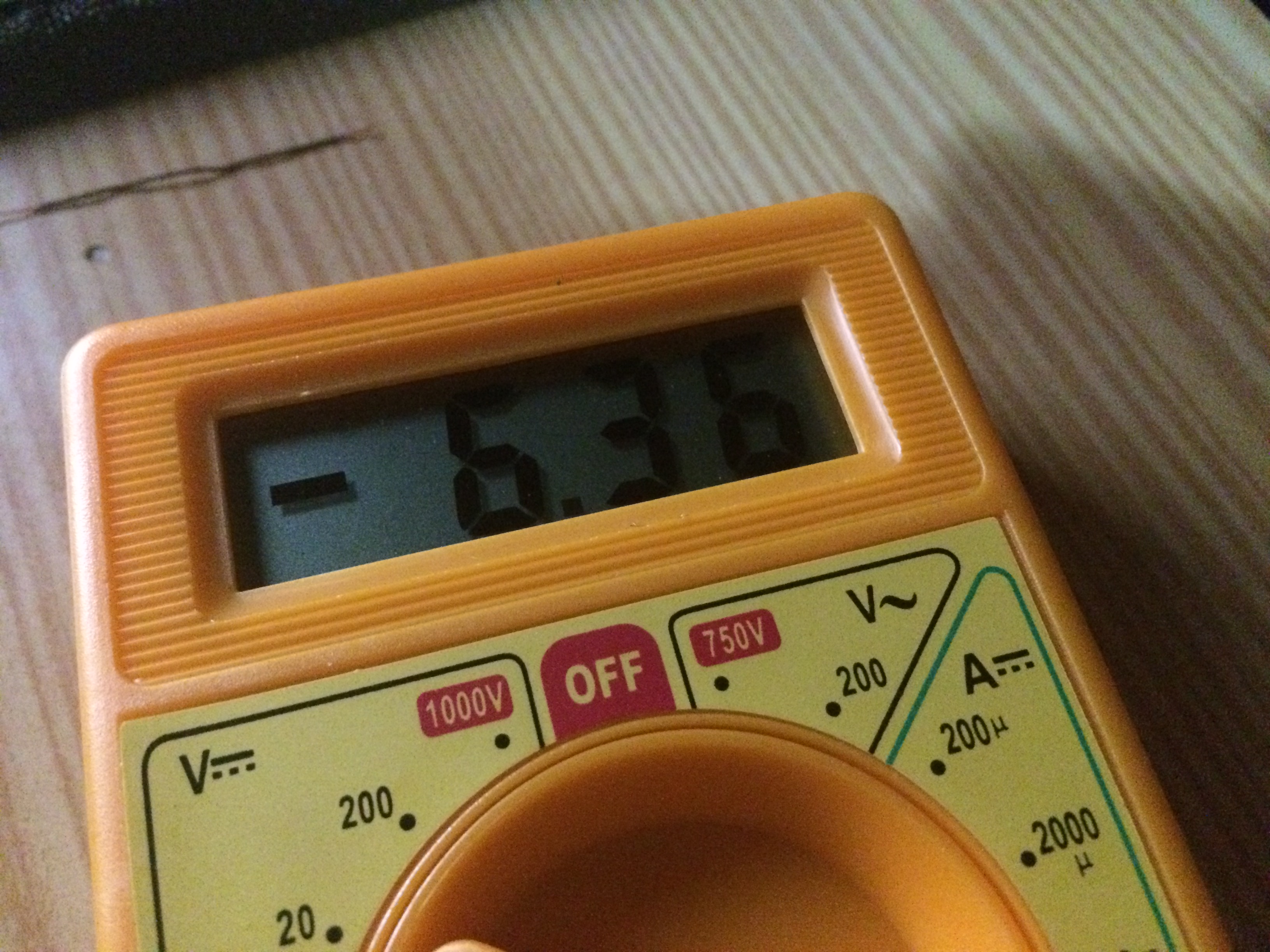

So far it seems the problem is AUX3 is not giving me enough voltage to heat the smoke unit (checking the manual both are logic functions). I'll test rewiring AUX2 (marquee {the numbers at the front}) just to confirm this theory. If that's the case, I'll try with an amplifier.
If this works, I'll get a MTH smoke unit, using AUX3 to generate the smoke and AUX4 to activate the motor and have more realistic chuffs.

Tried as dimmer and changed the CVs to output the maximum voltage possible, the amount of smoke was a joke. Checked voltage output: 0.5VDC; I don't think there is enough voltage. Checking the esu manual aux3 and aux4 both are logical functions, not physical.
Applied the same settings to aux1 and it worked, actually it generated a LOT of smoke, even using the output as firebox; aux1 is physical.

For the records: AUX3 and AUX4 are physical outputs, but they are TTL-level outputs. AUX1 and AUX2 are also physical outputs, but with open collector.
"Shunting mode" is a logical function.
It's no surprise that you cannot operate a smoke generator from a TTL-level output.

I already tried with the lokprogrammer and it does not work. As long as I use AUX3 it doesn't. AUX 1 is already wired to be used with the marquee (marquee is the light where the loco numbers are located)
Top contact marquee(aux1), middle contact common, bottom contact, cabin (aux2).
The aux3 is not even on that board, it's a small wire that goes under it.
When I applied the same settings I have in AUX3 to AUX1 and run a wire from autx1 to the smoke detector and it generates smoke.
There is something funky between AUX3 and the output itself, this small IC (upper right).
Edited by user 14 September 2016 23:13:26(UTC)  | Reason: Because I felt like it.

Same outcome; however, I found something. The smoke generator closes the circuit using the loco chassis as ground. This is the reading on my voltimeter.
As I mentioned before, the front pcb has a ground point, which shares continuity with the MTC21 pin 5 (common).
If I measure the voltage between the AUX3 and this common pin I get this:
Way much voltage than using the chassis ground.
Danilo Jiménez
